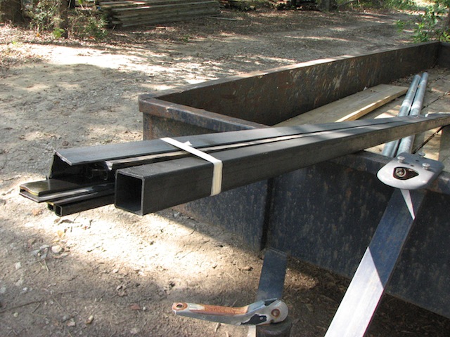

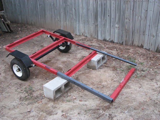

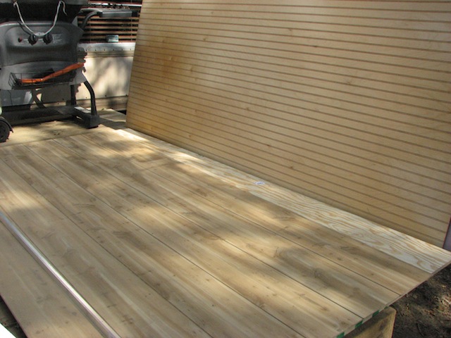

Postby 2bits » Thu Oct 04, 2012 9:59 am
Yesterday I picked up all the steel from the steel mill, and went by Home Depot and got 99% of everything I will need for the build. Tom is donating two windows and I only need a roof vent and a little trim...
Square Tube ½ x ½ x 16ga x 20 = 5
FLAT 1/8 x 1 ½ x 20’ = 3
Unequal Angle 2 x 1½ x 1/8 x 10 = 1
Square tube 2 x 2 x 1/8 x 10’ = 1
The 3/4" plywood floor, I also got three rolls of the tar roof patch stuff to seal the underside and sides of the floor. You can see the cool Pine panelling for the walls laying flat and the nice headliner panelling standing up. I also got all the lower aluminum trim I will need.
The attachment IMG_7742.JPG is no longer available
Cut the angle to length, and moved up the crossmember, and cut the old tongue to length to be used as the front crossmember.

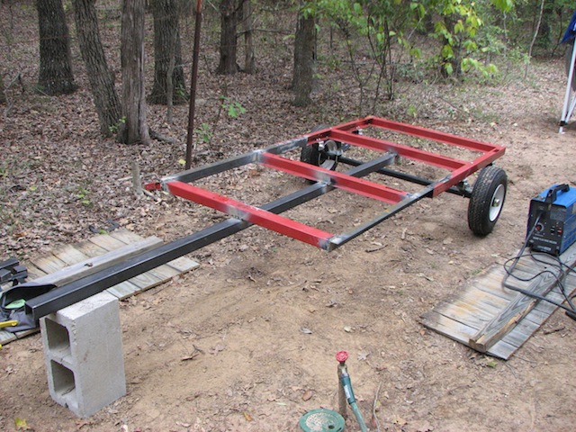

Postby 2bits » Sat Oct 13, 2012 10:32 pm
a 2bit weilding job,,,
It's a 2bit welding job, but it's holding
Frame is done, was supposed to rain so we put away the tools and then nothing.... GRRR
