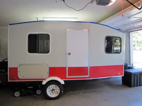

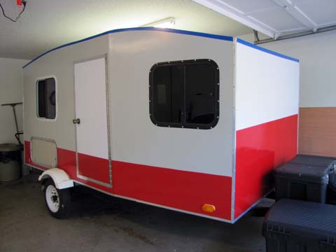

Now that the weather has cooled off a bit - We spent Saturday prepping new window frames to be installed. I carefully measured and outlined the cut outs - then - held breath and drilled pilot hole and proceeded to cut out for the new front windows. I got them at the swap meet in Indiana Crossroads of America gathering last July - I was waiting for some cooler weather to do the install. They are the same size as the rear windows. So what do you think - they certainly add more light to the front sleeping area and also more cross ventilation.
Before
After
