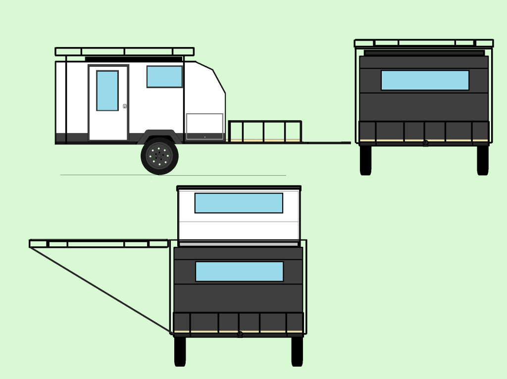

Rack and paint ideas, rack will rotate outof the way of the pop top and make the framework for a snap on awning

Re: teardrop toy hauler
Postby KCStudly » Wed Sep 26, 2012 3:34 pm
Rack/awning concept seems like a winner, but I have a couple of concerns. Is the rack high enough off the ground that you will not hit your head when in awning mode? Also, when flipping the rack over what keeps it from slamming over to the other side and doing damage?
The reason for the first question is kind of obvious. Even if it is low and you just plan on using it to sit under with a chair, sooner or later (probably in the middle of the night) you will hit your head.
The second question is based on some tall roll around tanks that we had at work. They were 5 or 6 ft in diameter, had a fixed semi circular lids (thin sheet metal) on the top (back side) with a hinge down the center and a semicircular opening lid on the front. We had a real safety issue because the lids were high enough to be very awkward to flip open. If they guys didn't flip them all the way open it would be on their head. When they did manage to flip one, it would slam down on the other side (both opening and closing) with whole lot of energy, slamming the handles and fittings on the top of the tank, and stressing the hinge. The tank was high enough that you couldn't just walk the lid around while flipping it, so if your cabin is low enough to hold the rack from side to side while you walk around that may not be such an issue; but then we are back to the first question.
(On the tank we put some tabs on top to act as stops, allowing the lid to open enough past center that it would stay open and lean on the tabs, but there was enough leverage from the relatively large lid and the relatively small tabs that this caused warping issues and more buckling; not really an option for your design anyway, just thought I would mention it. Eventually we ended up taking these tanks out of service, mainly due to the lid config.)
Just trying to share some experience in the hopes that you don't have any problems like these. :thumbsup:
Postby sumo » Wed Sep 26, 2012 3:43 pm
The height of ther rack when flipped shouldnbw around 6 4"to from the ground to the top of my roof is 6 ft. Where I have the platfom across the front I should be able to rotate the rack easily. It will be made from light wt. Conduit and will have stops to keep it from contacting the camper.
sumo
Posts: 130
Joined: Thu Aug 23, 2012 8:05 am
Postby KCStudly » Wed Sep 26, 2012 4:04 pm
Excellent! :thumbsup: Glad to hear that you have the details worked out. :D

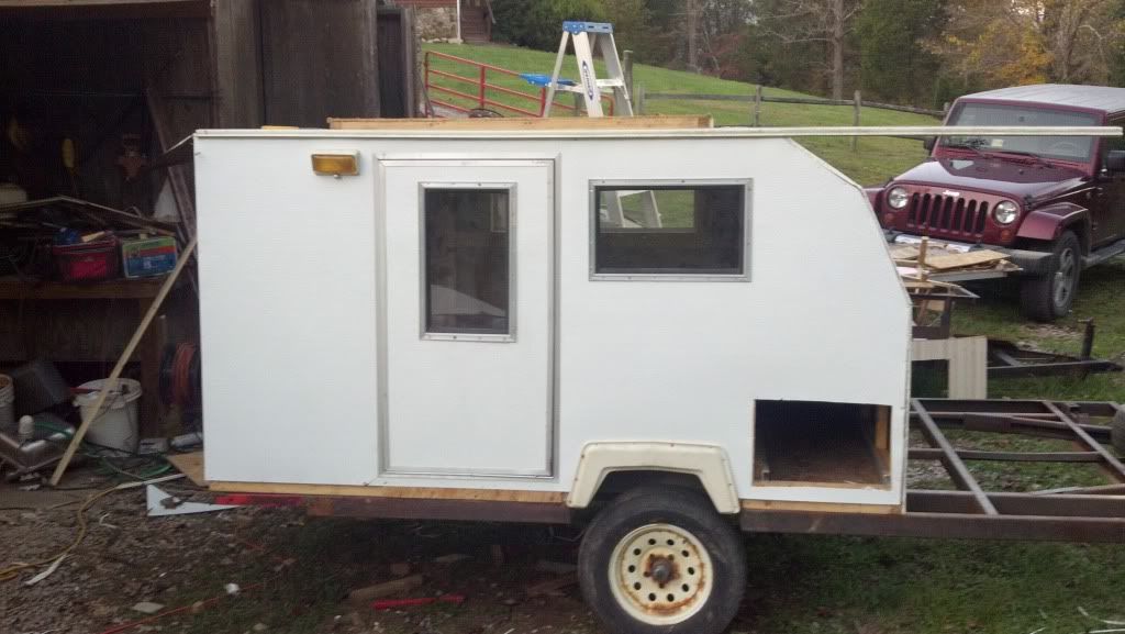

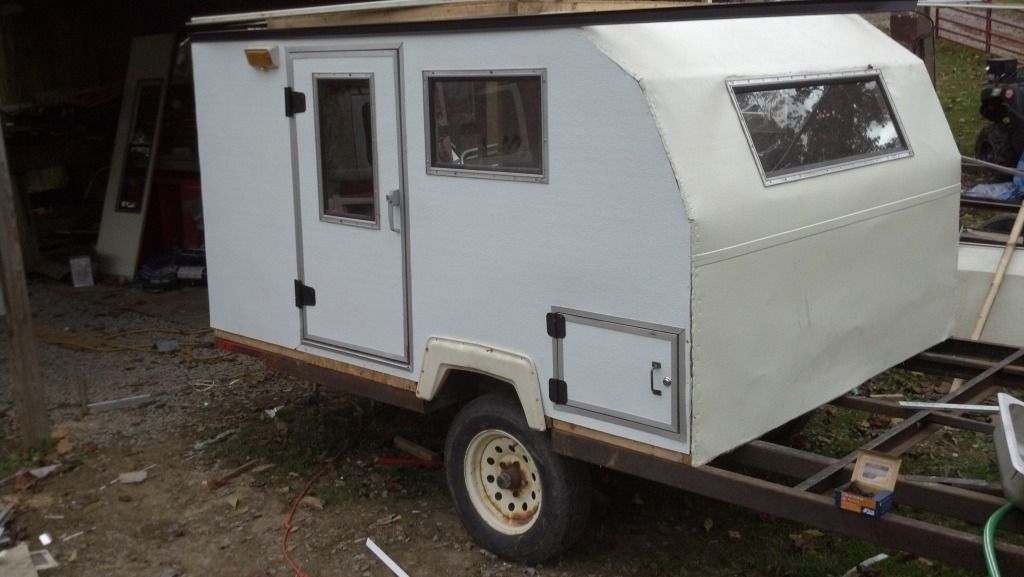

Progress. Trim around the door.

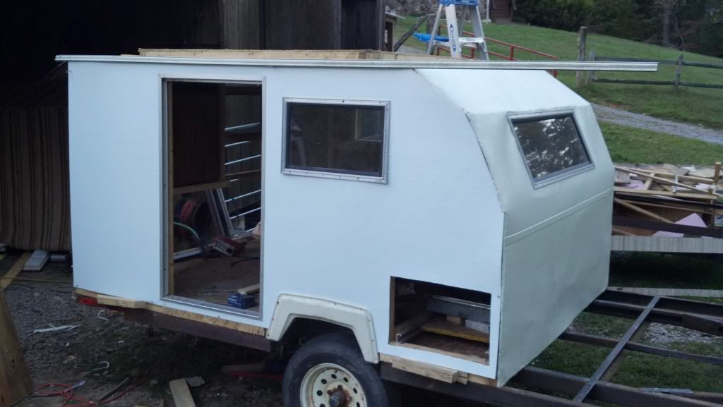

Postby sumo » Thu Oct 04, 2012 6:04 pm

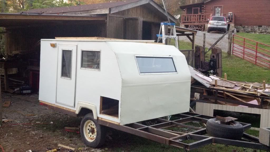

Slowly coming together.

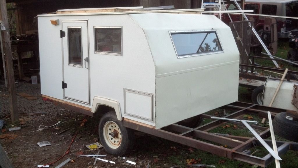

Postby sumo » Sun Oct 07, 2012 5:47 pm

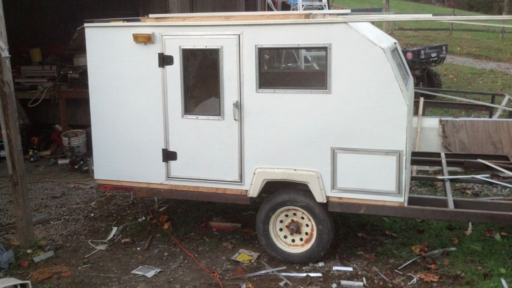

Plugging holes

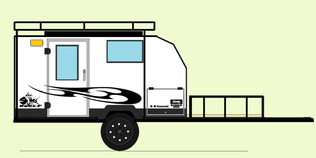

Postby sumo » Mon Oct 08, 2012 7:22 am
Graphic ideas . I dont know how well the graphics will stick to the FRP.

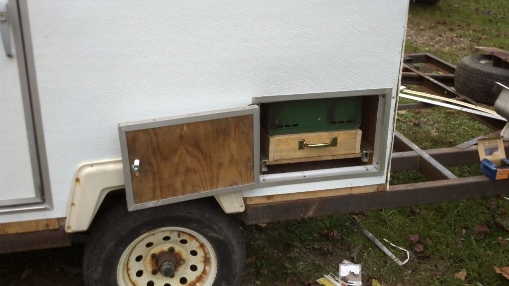

Postby sumo » Sun Oct 21, 2012 8:35 am

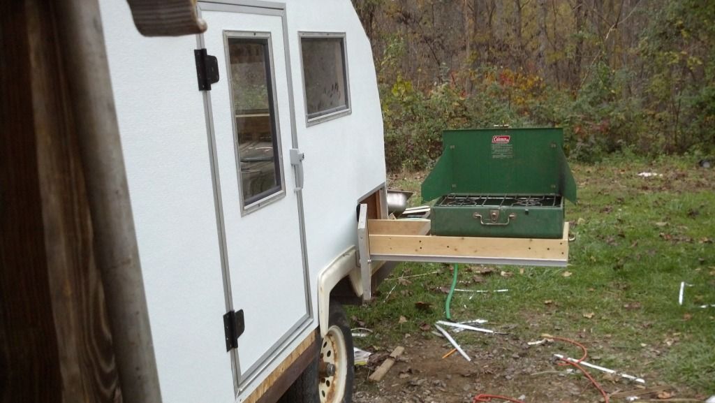

Wll i decided to go with the old colman stove, Making slow progress.
