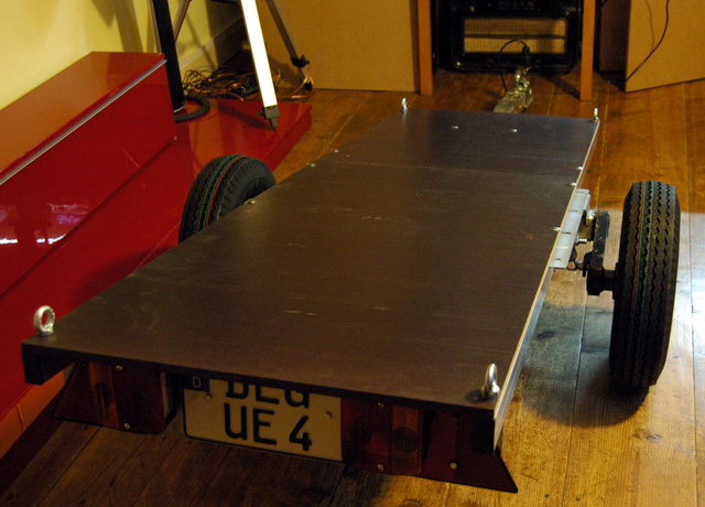

Got my deck. Waterproof textured coated 12mm (1/2 inch) plywood In two pieces but nevertheless too big for my micro convertible Daihatsus trunk.
And found a cement bucket for 1.79 that will be cut into two tiny black fenders (only to get my registration).

Okay - I got my utility deck finished !
Time to go to bed and think about making fenders from a cement bucket and how to get them fixed.
The TÜV engineer, who promised to give me a unique european serial number for my trailer will return next monday from his vacation. So long I have to wait.
The total weight of the trailer is now 60 kg (132 lb), 7 kg (15 lb) tongue weight.
Without wheels only 50 kg. So I can get it downstairs with the help of one of my daughters.
Hope to get it approved before march. Then I can bike again and make my test rides.
