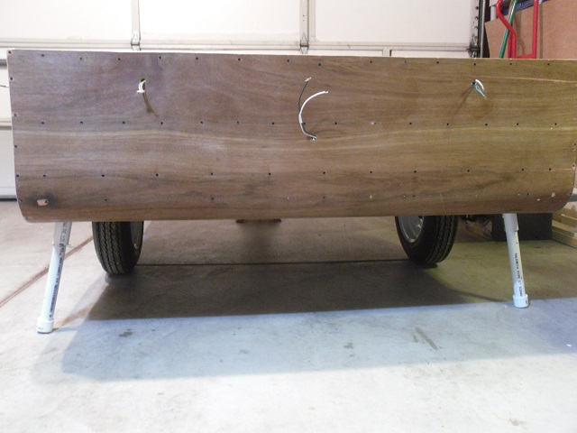

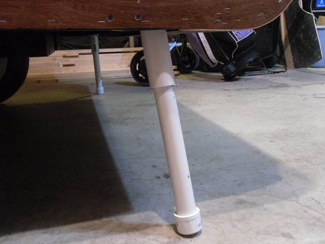

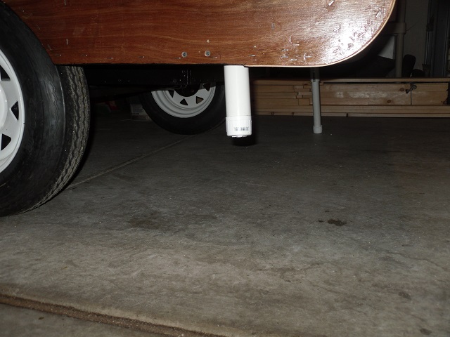

Those home brew stabilizers are well executed, too, but I hope you are aware that PVC can be brittle at low temperatures, and I would keep an eye on the pin holes. When PVC is point loaded like that (the small area of the pin concentrates the load on what is now a weak spot in the pipe...the hole) it can split.
I like what you have done :thumbsup: , I'm just saying that it could be something to look out for depending on your usage.

I've used a lot of PVC at Burningman also. It can really crack and splinter to boot! And in sunlight over time it gets brittle. Though mostly to bending. I'm trying to use the smallest dia. pin I can get away with. Without an engineering degree :NC I'm just hoping that because there isn't that much weight back there it'll hold up a while. Time will tell. Looking at some of the PVC bikes at burningman and how well they've held up over the years, I'm cautiously optimistic. :lol:
It is fun to play with these ideas and alternate ways of doing things on these projects. I'd love to be able to make these cheaply from aluminum pipes. with nice welded on braces. (Come on Tom, get busy with that welder!)
That would be sweet!
I'll have a better idea how they'll work once they're installed and I can put weight back there. At any rate if they do fail on the trip at least I can stop somewhere and get something to put under there. But it would be great if something that was cool and fun to do actually worked well! Anyway thanks for the comments, ideas and encouragement! :R

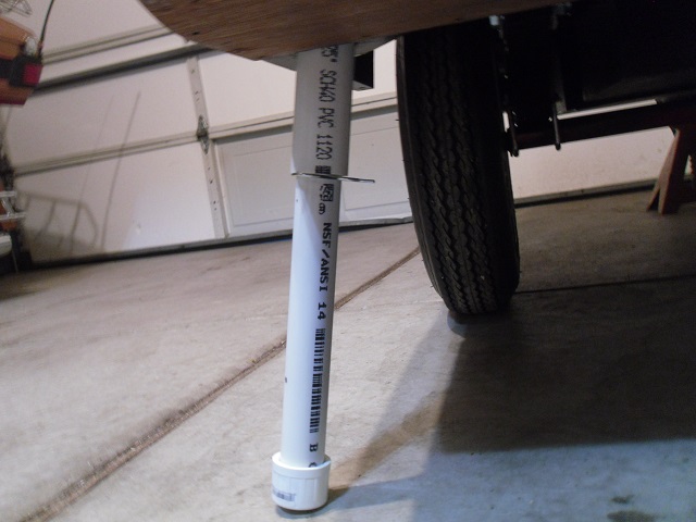

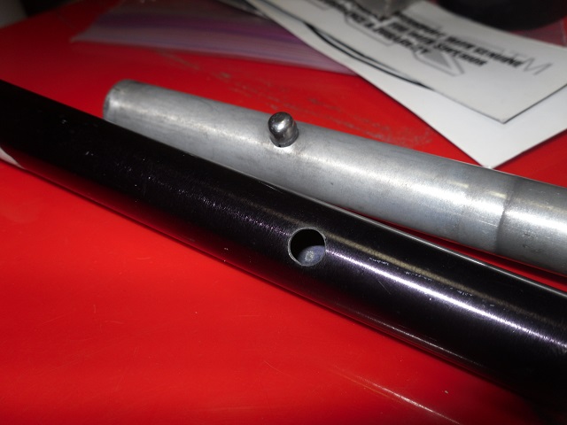

ST1100 wrote:But what I do not understand, how you fix them with different ground levels.
Do you have different holes through the inner tube to stick a pin through ?
Yes. I drilled 4 small holes in the inner tube. Then put a hitch pin (R-pin) though one of holes. the pin is a small diameter so it goes in between the coils of the spring! That's something I'll have to play around with still. I drilled the holes 3/4" apart.so there's about 3" (7.62cm) of adjustment. It's hard to see the pin in the picture but it's there in the picture of the tube extended. I played with idea of two cuts on opposite sides of the inner tube and using the type of U shaped spring clip that slips into the slots. I'm not sure how to describe that. Also some kind of friction stop, or the type of spring stop that fits inside the tube and stops in a hole on the outer tube. Like the type on an adjustable handle for a tree saw or even a tent pole. I like that idea best. Idea in progress!

Here are the pictures with the stabilizers installed. I put all my weight on the back of the trailer without a problem. guess we'll see when it goes a camp'n!
Both from behind.
From the side. Tom, here you cab see the pins better.
left stabilizer from behind
The stabilizer retracted. Hangs down about 5".

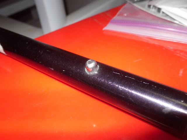

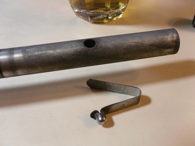

Here's what I was talking about earlier. Maybe some kind of push button to hold the inner tube extended. This is an adjustable ski pole.
That might work!
Tom, I'm not sure how the PVC would work on a heavier trailer. This one is pretty light. As will be yours. Still aluminum would be very cool! :twisted: :R :thinking:

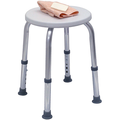

I'm betting there a lot of adjustable aluminum tube type handles, poles, supports etc that use that spring button type locking mechanism. You would have to install it at the high end of the inside pole and pin the retracting spring slightly lower. That wouldn't be a problem. If you could find an existing pole or find a company to buy the parts from....
This is the kind of thing I'm thinking, just larger.
Maybe something like this from a thrift shop. Then use the guts out of it. :roll:

The walkers like the ones that Bob Henry uses for his DO stands have those same types of legs that you showed on the little stool.

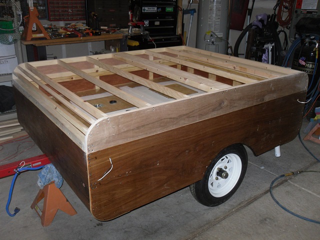

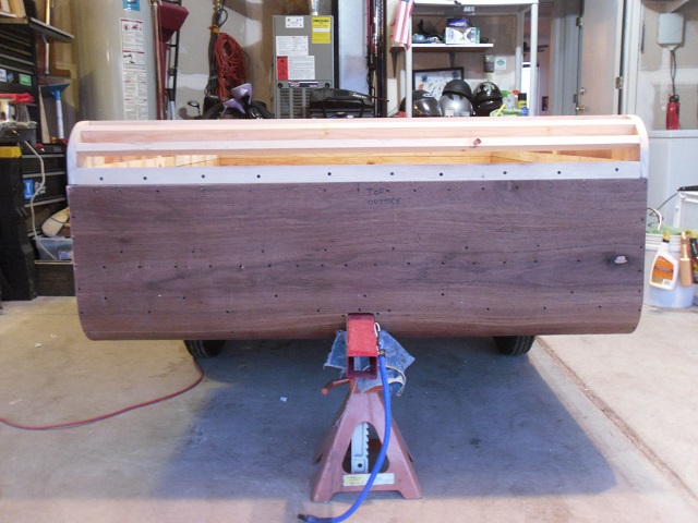

Postby harleykamper » Mon Apr 22, 2013 12:10 am

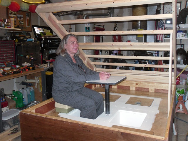

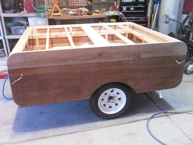

The top frame is done and awaiting Luan application! Yea! :D
Here it is from the corner angle. It isn't varnished in these pictures, but I did that tonight as well.
Side profile. Now it's clear how small it is overall. 75" Long, 54" wide, and 35" tall.
Front view.

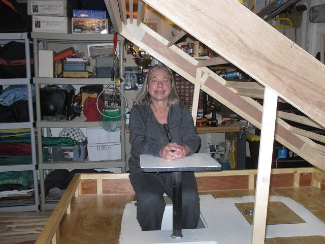

Here it is opened. approx 4 feet headroom in the front. This is a tent trailer so the three open sides will be light weight nylon tent material. There will be windows on the sides and a upside down T shaped door in front.
Here's my wife Marilyn sitting at the table, testing the headroom. Looks OK for us short people! :lol:
Side view of the headroom. Plenty of room.
Next week, lay on the Luan, and glue it down. I need to get my aluminium sheet, hinge, latches, Corner trim, L trim for the edges, Install battery powered lights, Storage nets. Lots still to do!! :shock: :?
