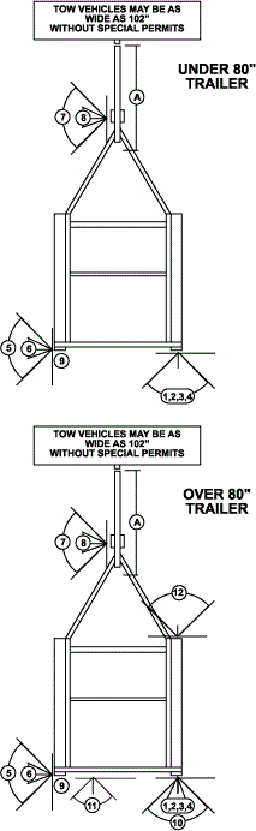

The placement of your side marker light probably won't meet regulations for visibility. They have to be able to be seen not only from the side, but also from a forward angle, as shown in the attachment.
lighting visibility diagram
You might want to move it over to the edge.

I actually didn't take updated pics of where the rear lights actually finally ended up....I may still have them inset a little too much but they are closer to the sides. I was limited to how the lights bolted into my wooden frame and not the trailer and the integrated license plate holder couldn't stick out past the wheels...but if I ever get in trouble and have to move them....I'll mount them like you did and move them up to just behind the wheels...but I think that'd get more negative attention as they wouldn't be at the rear...I'll have to go take some new pics tomorrow and see (and show) where they are now.
