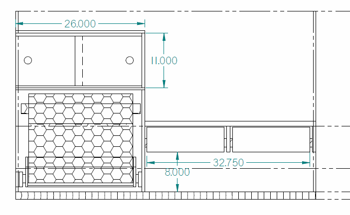

I played around with the split countertop idea. Here's the current sketch, with the ~32" wide countertop 37" off the ground:
Galley design 20140223.png (22.38 KiB) Viewed 2817 times
The honeycomb is the camp oven. It's just a hair bigger than your normal 2-burner stove. :oops:
The drawers are on 18" 100% extension slides, the oven is on 16" slides.

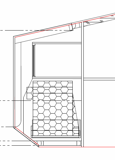

Here's the profile of the oven and cabinet, I had to cut it back vs the countertop (which is currently 19" deep) so that the oven can be lifted out of its cradle without tipping it. I'm not intending to cook with the oven on the sliding cradle, it is just to make it easier to stow/deploy the oven so I may live without it for a while.

Kharn wrote:Here's the current sketch, with the ~32" wide countertop 37" off the ground:
:duh: Now I get it! I didn't read KC's suggestion that closely, so I just didn't see how a counter split front-to-back would solve your problem. :oops: You're on the right track. This looks like a real kitchen! :thumbsup:
Maybe add a shallow pantry cabinet on the right third, just a can of beans deep? Also, with the 8" space under the drawers, more drawers? or would the open shelf-ish space be preferred?
Either way, I think it looks good and gets the job done.
Brad

8" is just enough for my dutch oven and Coleman camp sink to fit under the drawers.
A shelf or two above the countertop is certainly in the cards.

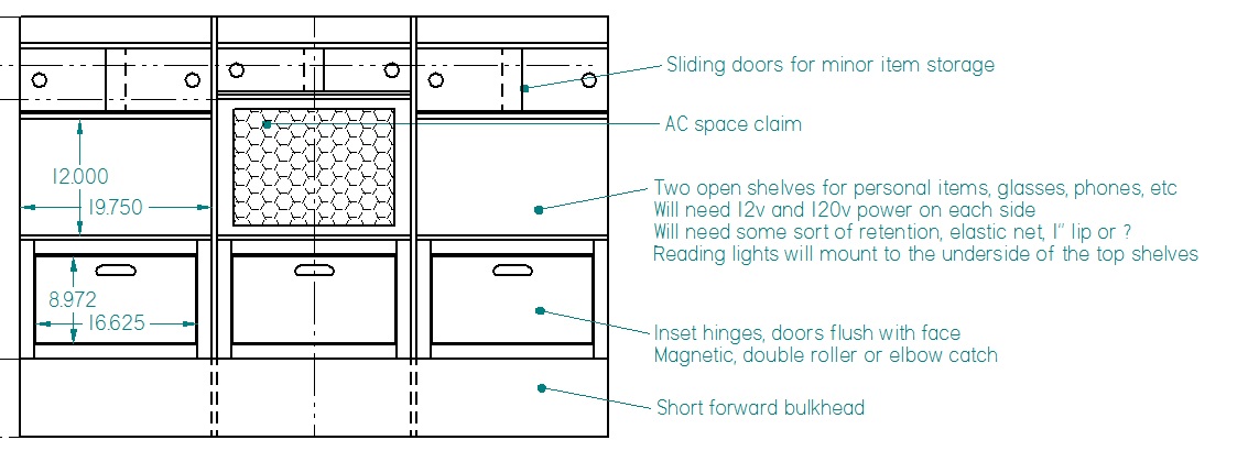

Forward cabinets:
Forward cabinets 20140301.jpg (119.32 KiB) Viewed 2629 times

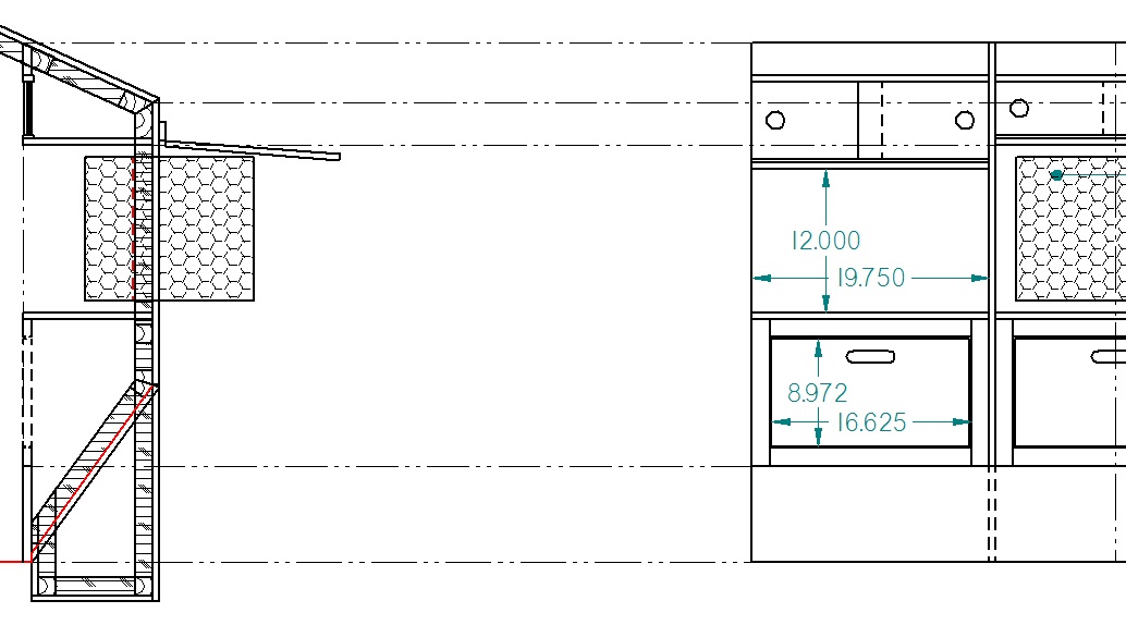

Center section profile, the lower section won't have the angled piece interfering and has ~10x22x20" of storage in that compartment (so, approximately a large suitcase, and I'm sure my wife will demand two or more of those lower compartments for herself, for a 2-night trip :lol: ):
