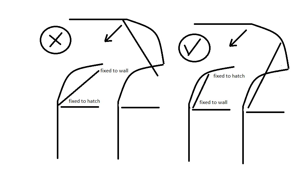

Hi Tim,
correct me please if I am wrong, but I get the impression that you are looking at fitting the gas struts for your hatch with the mounting point on the hatch at bench height, and the mount on the wall at the top near where the hinge point will be. If it is how I think, it wont work.
noseoil hatch struts.jpg (61.21 KiB) Viewed 6251 times
The example with the cross is the impression I got. as I said I may have got it wrong :? I can be easily confused.
In the situation that I have drawn, the example with the cross, when the hatch is up the force from the weight of the hatch is pushing sideways, so the strut will have little effect on holding the hatch up. The example with the tick, the force is directly on the end of the strut. this may mean mounting the strut further down the wall.
:beer: Frank
PS. don't hesitate in telling me if I am barking up the wrong tree. :oops:

Postby noseoil » Sun Oct 19, 2014 9:19 am
Hi Frank, you have it right in your drawings. The one with the "X" is exactly correct and the way I will do the mount for the cylinder. Here are a couple of pictures to illustrate what I will do. Here's the hatch in the open position, with the cylinder fully extended.
159877
Here's a closer detail of how it will look, just a WAG at the exact location, because the side panel with the actual layout is on the bottom for now.
159879
With the hatch in the closed position, this is the relationship of the points.
159878
I'm not sure I follow your thinking about a sideways load (lateral forces?) on the strut itself. With the strut in place and firmly attached at the pivot points, I don't think there can be any side loading, as long as I locate the axis of the strut in a single plane. Even if I "miss" by 1/4" or so, the side loads shouldn't come into play. Also, I'm using my "X" instead of the "tick" because of the loading on the struts. With the "tick" design, there is a huge increase in the loading of the struts and the corresponding weight they must carry. The closer to the hinge the attachment point is located for a strut, the greater the force necessary to hold the hatch in the open position. The least amount of load would be at the bottom of the hatch, but this isn't practical due to the open length necessary for the strut and amount of travel it would take.
For example (and this is just the theory, not hard science, which is beyond my abilities) let's look at a sample hatch. The hatch weighs 100#. Measured at the open position and with the support on a scale directly beneath to "load" (the back (lower) edge in the middle of the open hatch's edge) the scale reads 50#, about half the actual weight, because the hinge is holding 50# and the scale is holding 50# (on the opposite end). About half way between the hinge & the opened edge, the load would be twice what the weight is on the scale, due to the increase from leverage, or about 100# (this would be my example and your "X" diagram). If that point on the hatch is moved 1/2 the distance closer to the hinge, the load doubles again, let's say to 200#. This is why I'm locating things where I am. If it doesn't work, I'll let you know, but it will be a while until I get to that point in the build. Still too many things to do for now.
If there are any engineers out there who can explain my mistaken theory in simple terms, I would appreciate it. If I'm making a mistake here in logic, planning or execution, please let me know now..... tim

Postby KCStudly » Sun Oct 19, 2014 9:39 am
So what you are forgetting is that gravity is acting on the center of gravity of the hatch, which is reacting as a moment around the hinge. Taken to the extreme, if the hatch were hanging straight down and you put your strut directly in line with the hinge and end of the hatch, the strut would only be trying to stretch the hatch and would do nothing to try to lift it.
In the X version that's close to what you have (the strut is pushing from close to the hinge thru a point that is close to the CG of the hatch), and the highest possible load from gravity is on the hatch (it is neither hanging from, nor balanced above the hinge).
Whereas in Sheddie's Check version, the line of force from the strut is acting much more directly toward holding the hatch up. Yes the loads are higher, because the strut is actually doing some work and is not just along for the ride.
What you have said about the ratios of the mounting points versus distance from the hinge is true; the closer to the hinge the strut is mounted the higher the loads and leverage will be, but the fix for this is a longer strut with more stroke length. The work still needs to happen, and the closer you can make the line of force to the load, the easier it will be.
Take another look.
Re: Tucson tortoise
Postby noseoil » Sun Oct 19, 2014 10:20 am
"So what you are forgetting is that gravity is acting on the center of gravity of the hatch, which is reacting as a moment around the hinge. Taken to the extreme, if the hatch were hanging straight down and you put your strut directly in line with the hinge and end of the hatch, the strut would only be trying to stretch the hatch and would do nothing to try to lift it."
"In the X version that's close to what you have (the strut is pushing from close to the hinge thru a point that is close to the CG of the hatch), and the highest possible load from gravity is on the hatch (it is neither hanging from, nor balanced above the hinge)."
I guess I'm not understanding what this says at all. :? Gravity holds the hatch shut, I think I got that (it's the same thing that holds dry-wall mud on the ceiling, right?). If the struts are out of line (below the axis of the imaginary center-line between the hinge & the center-line of the center of gravity of the hatch), they will do the same thing, help to hold the hatch shut if a latch fails, not a bad thing for me really. They act to push the hatch into the shut position by expanding past center. It's like a past-center camming action that has the strut "pushing" the hatch closed. Once the pivot point on the hatch passes this imaginary center line, the springs begin lifting the hatch and then push it open and hold it there.
If what you're both saying is that at rest, the struts are helping to keep the hatch shut, then I agree (still not sure what's going to happen, exactly). If you're saying that they won't hold the hatch in the "up" position, I need to quit my job & retire right now!
I've edited this post for content, I didn't mean to come across as an arrogant ?rick, which is how I read it when I came back to it. KC, your input is greatly appreciated & valued. :beer: tim

Postby noseoil » Sun Oct 19, 2014 10:57 pm
I'm posting this to show what a great amount of knowledge there is on the site, the patience KC is showing me with his reply, & the effort he is making to help me understand my build, and keeping me from making a mistake. I'm still trying to digest what he has said about my strut mounts & locations....
"Thanks for your patience with me trying to explain why Sheddie has made a good point about hatch strut placement.
You are correct about the over toggle action being helpful in keeping the hatch closed, but that’s not what Sheddie and I are on about.
Let me try to explain it again. There are two things going on. First is the moment reaction around the hinge. For simplicity, let’s assume the hatch is a flat panel 60 inches long and it sticking straight out the back from the hinge in a horizontal position (to the left when viewed from the side). Let’s also assume that the strut is located 1/3 out from the hinge at 20 inches and is pushing straight up. So if the hatch weighs 50 lbs and it's built uniformly (i.e. the weight is distributed equally), then the reactions are fairly easy to calculate. Since the hatch is not moving, the sum of the moments (torque) about a point (let’s use the hinge) are zero.
So the weight of the hatch (50 lbs) is working down at its CG (30 inches away from the hinge). This is 1500 inch-lbs in the counter clockwise direction (50 x 30 = 1500). The strut is holding up equally at 20 inches, so the reaction at the strut must be 75 lbs (1500 / 20 = 75).
Since the hatch only weighs 50 lbs, that means that there is an upward lifting force on the hinge of 25 lbs (50 – 75 = -25, minus meaning in the opposite direction, in this case up).
So it is clear that the closer the strut is to the hinge on the hatch the higher the leverage is and the higher the load will be on both the strut and the hinge.
The second factor is the force vector of the strut. In the above example the strut is pushing straight up, so the torque load is one for one; but if the strut is acting at an angle to the direction of the load (the load being tangent to the radius from the hinge) then the equivalent force on the strut is proportional to the vector as the ratio of the sides of a right triangle with the same angles as the geometry of the strut.
So let’s kick the strut to an angle. For the sake of simplicity, let’s not worry about the specific angle but instead use a 3-4-5 triangle. In this second example let’s assume that the lower end of the strut is 3 units in front of the point where the top is pinned to the hatch, that it is 4 units below the point where it is pinned, and the that extended strut is 5 units long.
The ration of the triangle is the same as the ratio of the loads, so 4 is to 75, as 3 is to the load trying to push the hinge horizontally forward (to the right), as 5 is to the amount of force trying to compress the strut. So even though nothing has changed but the location of the bottom of the strut, the load on it is now 93.75 lbs (75/4 x 5 = 93.75). And the load trying to force the hinge forward is 56.25 lbs (75/4 x 3 = 56.25).
Now compare that to a third example where the strut bottom is only 3 units below the hatch pin, is 4 units ahead of the hatch pin, and is still 5 units long when extended. 3 is to 75, as 4 is to the load pushing forward, as 5 is to the load on the strut. So the load pushing forward goes up to 97.3 lbs (75/3 x 4 = 97.3), and the load on the strut goes up to 125 lbs.
So while this is a really simplified example (what? ), and things start getting weird when the hatch is not flat or straight out horizontal, and the strut changes length during use, etc., etc., I hope that it shows what happens when the strut is laid out flat between the CG and the hinge.
Sure, you can make it work, but it will dramatically increase the forces acting on your hinge and strut mounts, so you will need to build stronger (heavier), and use a higher powered strut. Whereas if you improve the geometry, you can drastically reduce the loads and still hold the hatch up just fine.
I didn't want to clog up your build, but you are welcome to post this there if you want. So many people have trouble with strut brackets and hinges tearing out, and just generally underestimating the load multiplication involved, that I felt it was worth trying to explain."
