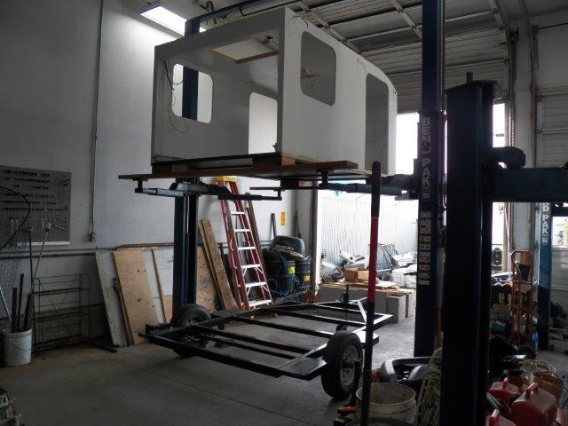

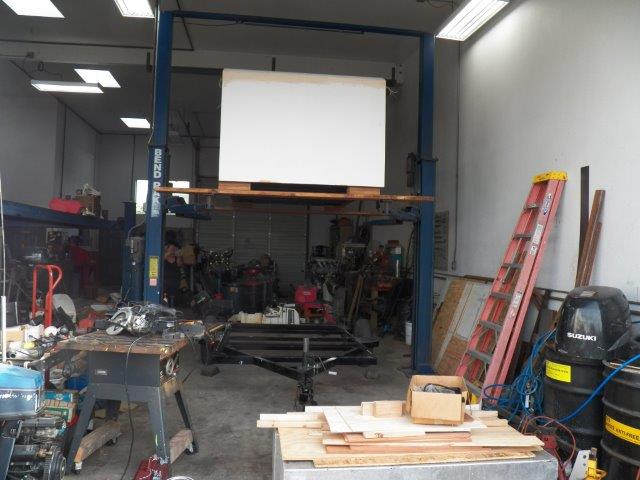

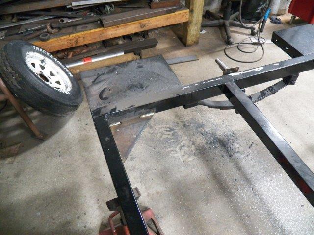

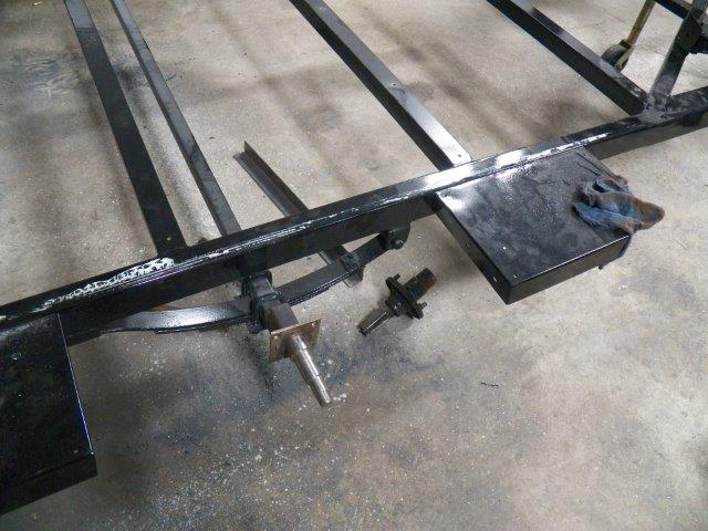

We did just a little work last weekend. Did some more filling and sanding. Been raining to much here to take it outside lately. We had a patch of sun today, so we cleared out the last bay to put the trailer in it's final resting place until it's done. Won't have to take it outside anymore! We pulled the trailer off the frame today also. So we will be ready to paint soon. We'll be doing a few mods on the trailer now that it's off.
Trailer off the frame!
Front part of the boat trailer frame where my son squared it off.

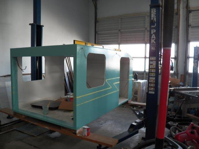

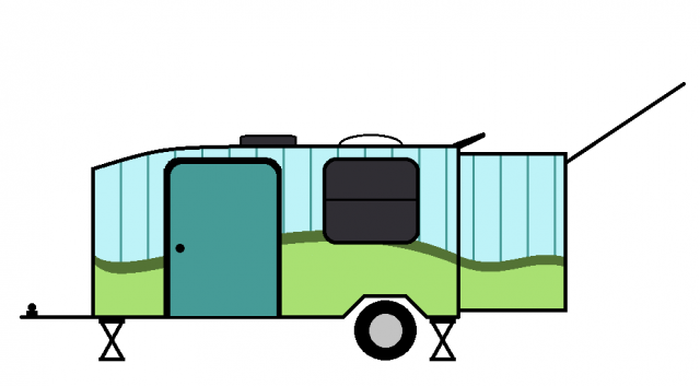

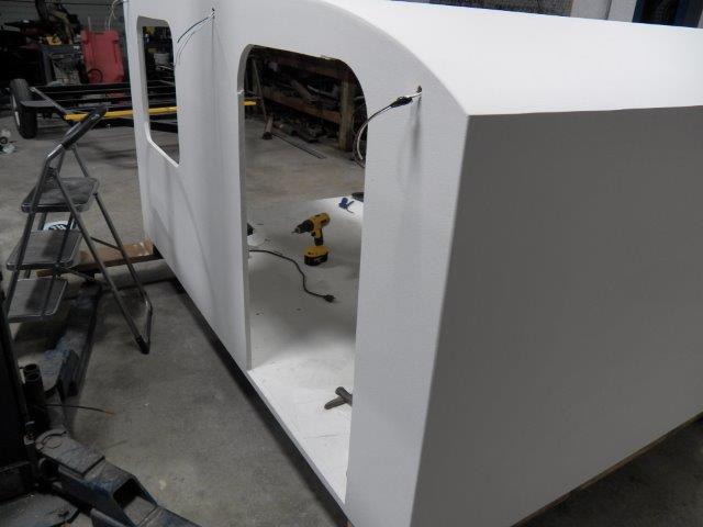

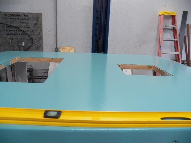

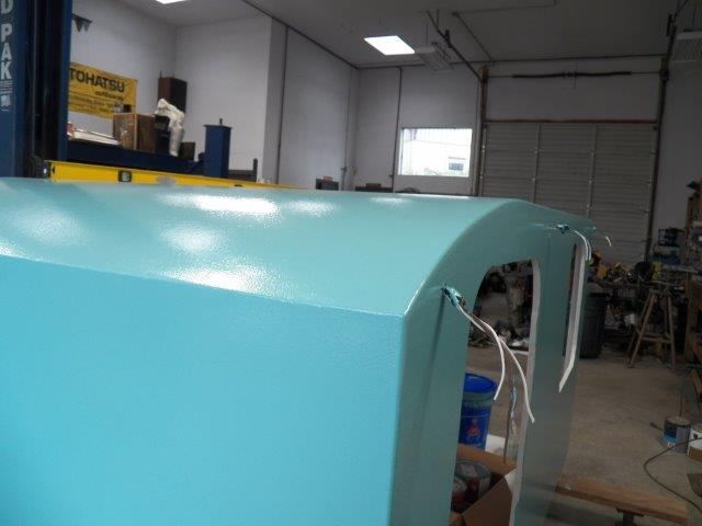

Boo and Mara work on the trailer last weekend. The got it ready for paint. My son will be doing/welding a few mods on the trailer frame today. We should be painting the trailer tomorrow. I would like to edge out the corners of the trailer with glue on vinyl/rubber. I would like a 90 degree with about 1 1/4" to 1 1/2" coverage. Does anybody have any Ideas what to use and where to get it? And last but least, a new paint scheme!
Last prep for paint. Sanding, filling and the final two coats of primer (total of five). I ran a router I borrowed around the edges so I wouldn't have any sharp corners for the paint.
Image\
New paint Scheme!

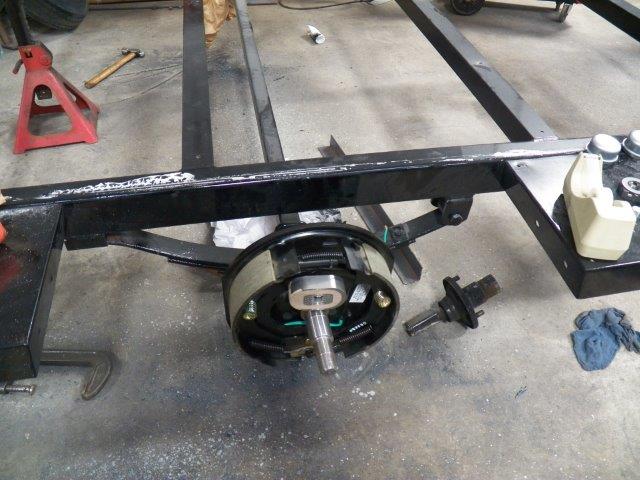

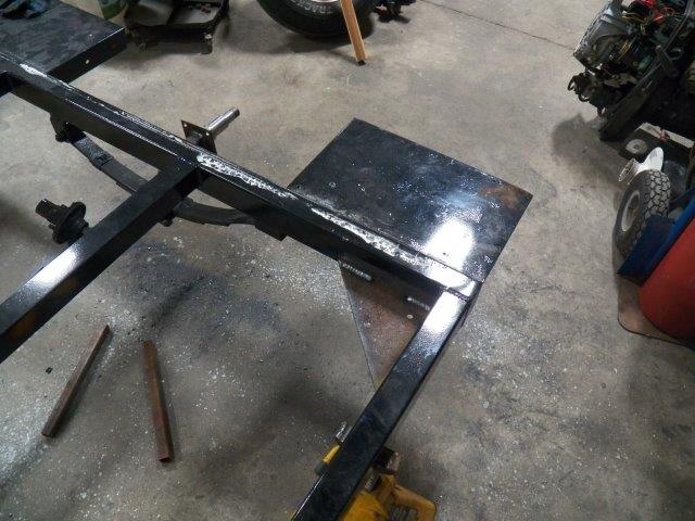

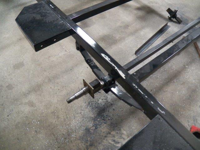

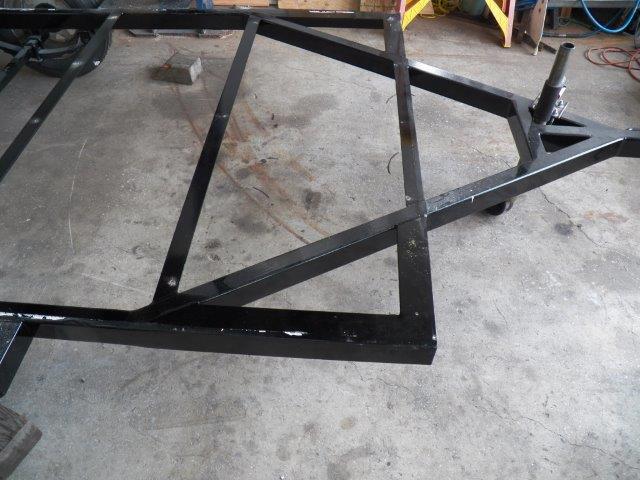

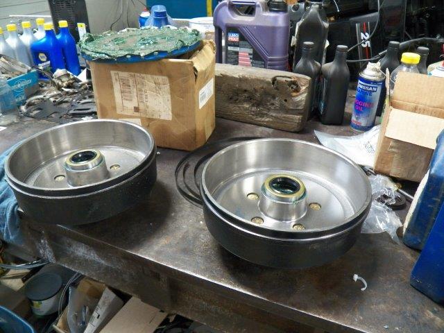

Today my son Genarino, cut off the old stub spindles and welded on the new ones with the brake backing plates. My son has welded on lots of stub spindles and knows how to make them straight. He also welded on the mounts in the four corners of the frame for the stabilizing jacks. He even drill the holes for the jacks first!!!

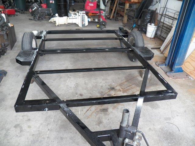

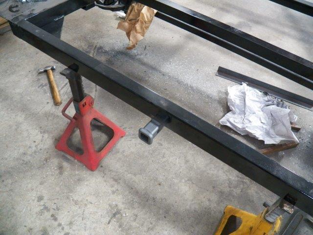

My son Genarino welded on a small receiver hitch to the trailer frame so his sister Boo could add a bike rack.

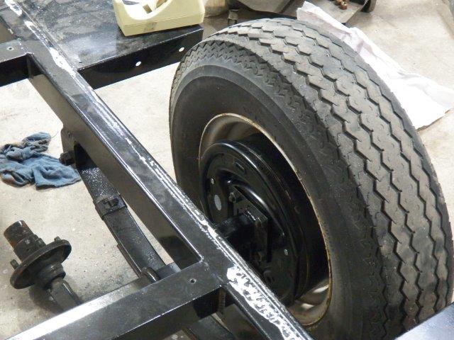

Genarino also installed the brakes on the axle.

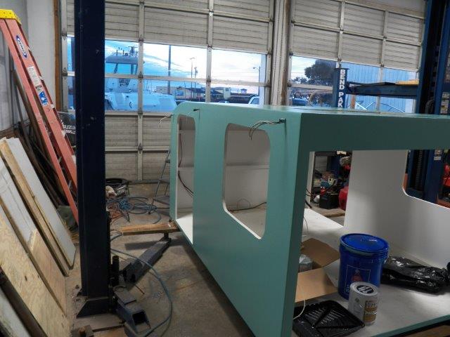

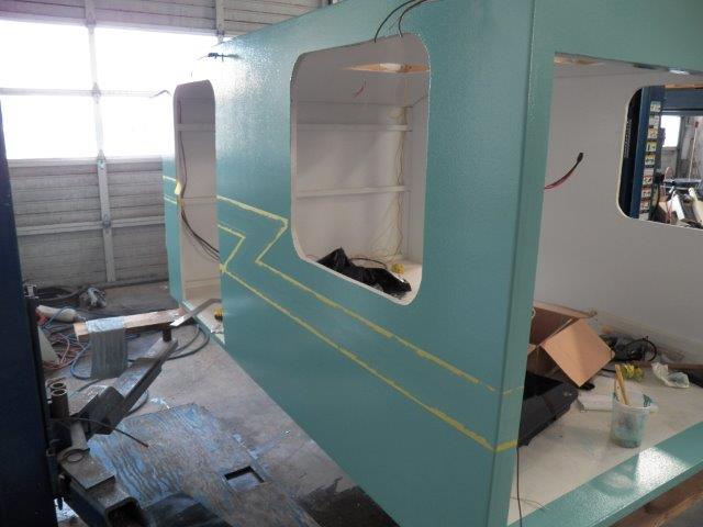

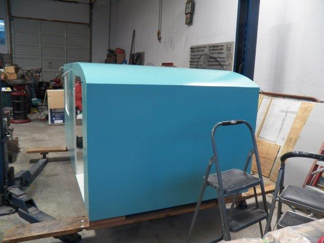

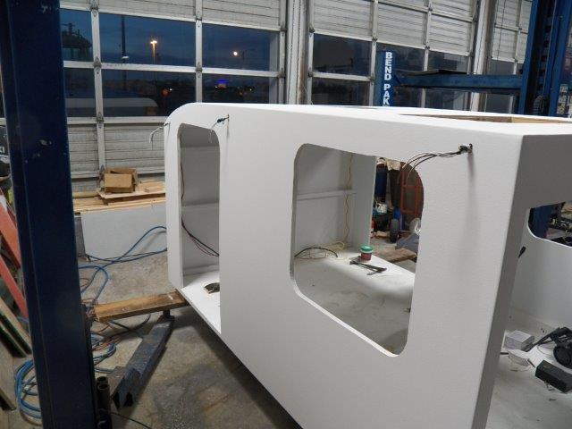

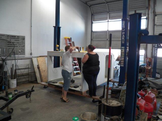

Boo and Mara put a total of around 6 coats of the blue oil based enamel on the body. We decided to roll it on. The first coat was done with a 1/4 nap roller. It left little furry particles in the paint. So that needed to be sanded a bit. Then we went to a very thin foam roller that looked great. But then the nats liked the way it looked and smelt also. There was so many that it looked like we put pepper on it! But in the end it came out pretty smooth. Very happy for a roll job! All the corners will get edging.
You can't even see where the two piece roof went together. Good job by Boo and Mara for spending all that time sanding and filling!!!

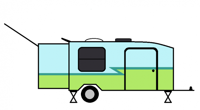

Boo's final design!
Boo taped off the trailer today for the stripe and painted the edges of the tape with the blue for no bleed over. She also set up the doors to paint blue tomorrow.
