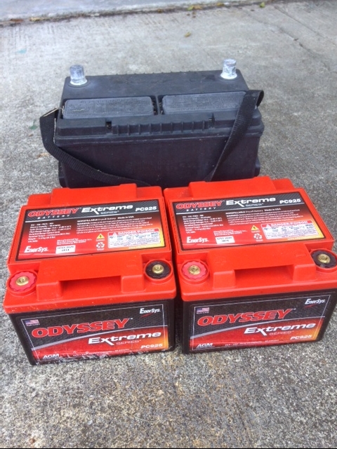

When I took the picture, these two batteries were -
Dead- really dead, as in no volts at all. I got them that way for free- I guess they thought they were worthless as they couldn't get them to take a charge- I tried to use a dumb charger to see if they would take any charge at all and they did , after 3 hours of charging ( with breaks when the battery got warm) it went up to 11 volts. I checked it a day later, it had dropped to 6 volts- most likely, they had sulfated
They were manufactured in August, 2014 and somebody just ran them down and didn't notice the standby charger wasn't working. The third one had a slight case bulge, but it was 13 volts and seems to be OK.

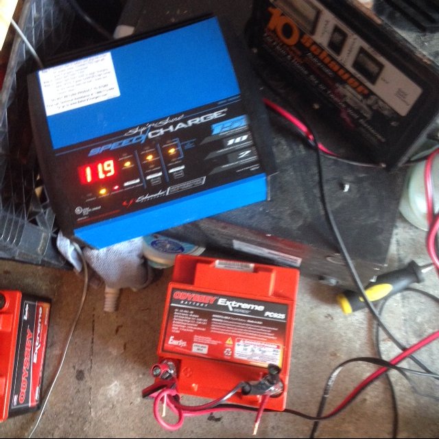

Anyway, it took a Shumacher SSC-1500a charger to desulfate them, but it worked. The trick was to use my dumb charger to get the voltage up to 8-9 volts, so the smart charger knew it was connected to a 12 volt battery ( I could have hooked a good 12v battery in parallel, too). I quickly connected the 1500a charger and it took off- after few minutes the yellow charger light started blinking (desulfating mode) when it recognized sulfation. It only took 15 minutes for that part and the SSC-1500A went back to regular charge at the 10 amp rate. It went another 2 hours, then it stopped- bad bat- readout, 7 volts. I restarted the dumb charger and went through the process 3 more times and each time the battery got a little stronger. Finally, the sulfation was corrected and it took a full charge-
The second battery took more work, but it was recovered, too.
The final charge top off required my 20 year old Schauer 10 amp regulated charger. The problem was the computer controlled Schumacher charger wanted to go over 15 volts at the end for the last 10% and that is a no-no for an Odyssey battery, the dumb charger was at 14.8 volts when it got to the final 1amp rate.
added: after several days, the voltage is steady at 12.8 volts= a full charge for this type of battery.
