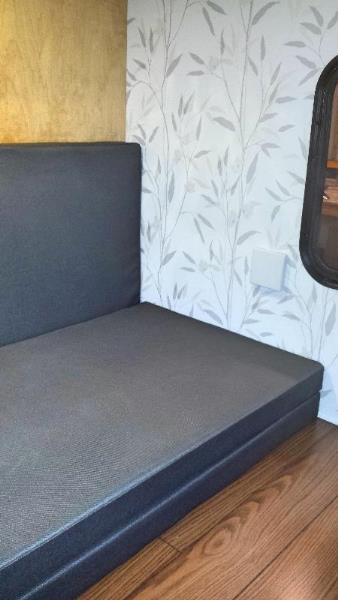

We did our mattress as 3 cushions. They can be stacked to form a little "sofa" as shown, or laid out for sleeping. We got the gray outdoor type fabric on sale for $38. Seems like it will be very durable and easy to clean. I think the color goes well with the wallpaper.

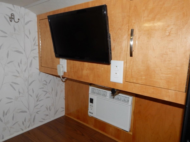

Postby TxDave » Tue Jan 13, 2015 12:33 am

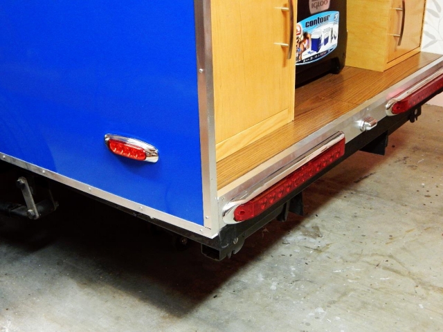

Got the AC and LED trailer lights installed. I really like these LED lights. They look nice and are really bright.
The rear hatch is pretty much all we need to complete to have this trailer finished.

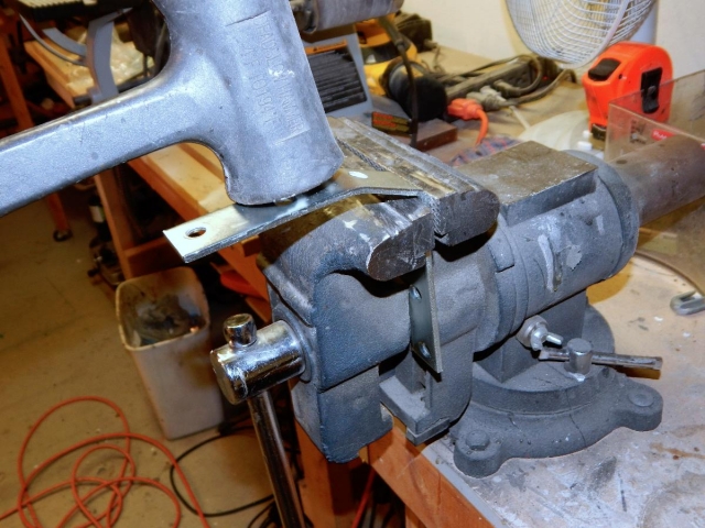

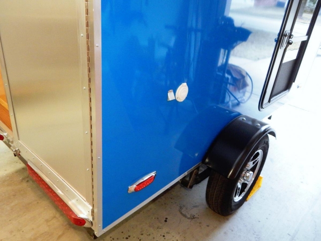

Its been awhile since my last post. Lots accomplished since then. I fabricated some fender mounting brackets from L-angles I purchased at Lowe's for about $3.00 each. I used my trusty dead blow hammer and a vice.
I used carriage bolts through the wall to mount the fenders.

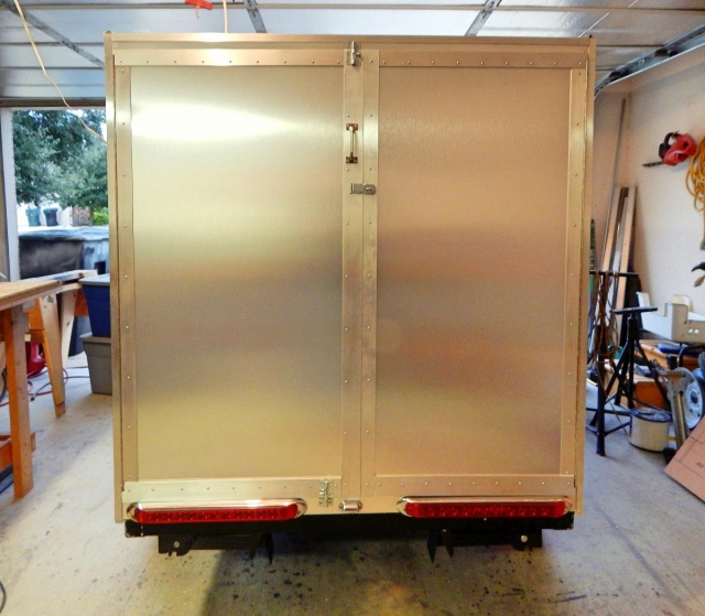

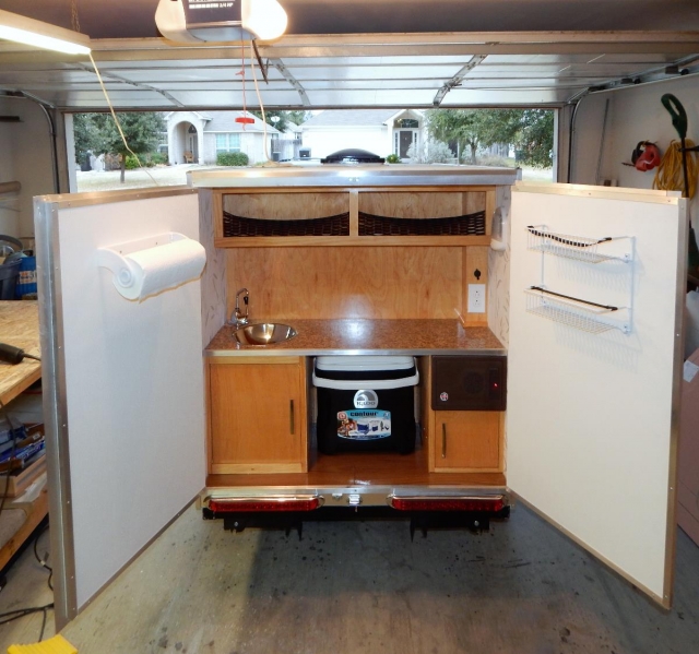

My original plan was to build a hatch for the galley. However, with the back of the trailer being flat, this didn't work out. I ended up making doors instead. The galley is officially complete.

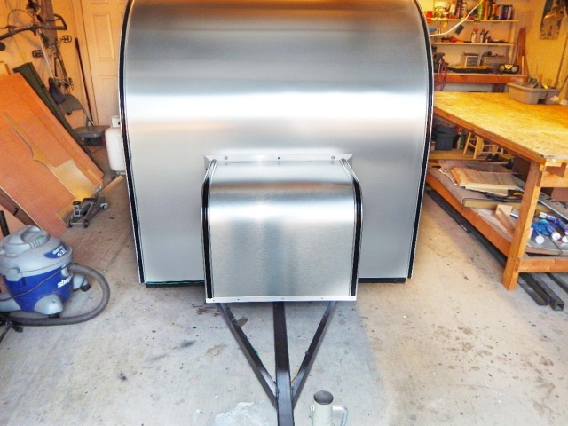

Well, we had a total rethink and redesign of the a/c cover box. I was not happy with the one in the previous post. I used my airplane building skills and tools to make this one out of aluminum. It's 1x1x1/8" angle with .063 skin. Everything is held together with rivets.

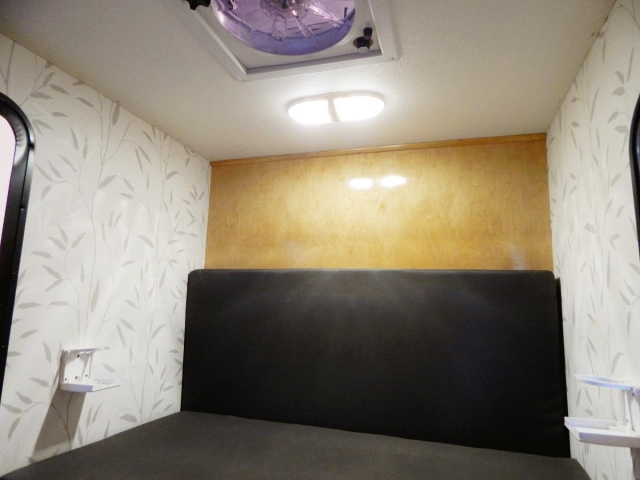

Postby TxDave » Fri Jan 23, 2015 9:26 pm

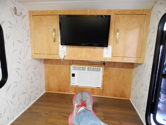

We started this build on November 14, 2014. It is essentially complete except for a few odd touch-up tasks. Here are a couple of interior shots. First is looking forward, and the second is looking aft. That lovely woman is my wife, Jan. She deserves a special award for putting up with me and my hobbies for over 40 years. Our two rescued doggies are Tootsie and Lucy.
