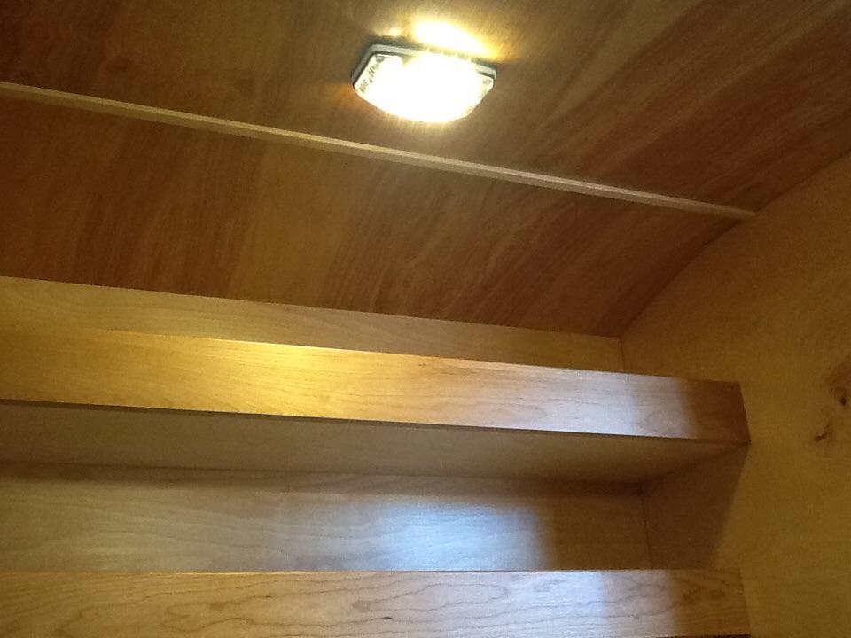

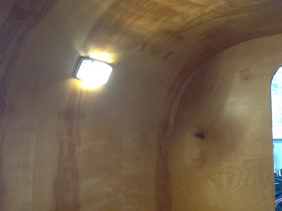

Postby ratrod71 » Sun Apr 19, 2015 4:28 pm
Put the 3rd and final coat of Spar Varnish on the interior and galley wood. Also installed the LED interior lights. It's alive and powered up for the first time! Bryan

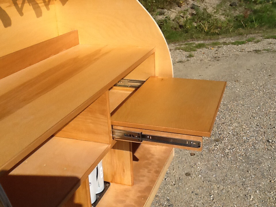

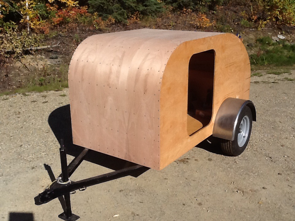

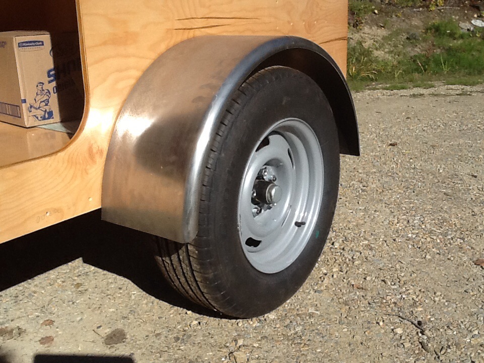

Postby ratrod71 » Mon Sep 07, 2015 6:09 pm
Well I was finally able to start work again on the trailer. Had to take some time off for other pressing projects.
This last week I mocked up the fenders and drilled the holes for mounting them onto the trailer as well as the taillight mounting holes. Also completed the Spar Urethane finish on the stove pullout.
Today the top 1/8" plywood was installed onto the roof. I used PL adhesive then temporarily held everything in place with 3/4" self drilling truss screws. The screws will be removed once the adhesive dries. Hurray for forward progress again!
