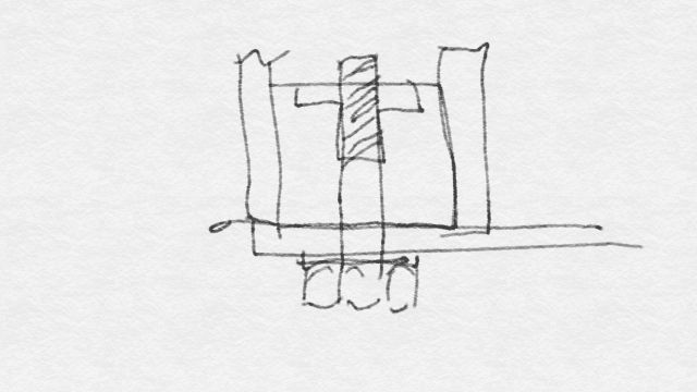

Re: M116A3 Build
Postby lfhoward » Mon Mar 30, 2015 12:09 pm
I found one of Tony Latham's posts about "rabbiting" the ceiling and walls. There are some good photos in there showing what I think you are describing:
http://www.tnttt.com/viewtopic.php?f=21&t=62299
So, since I have that nice sketching program on my iPad, here's a quick schematic of how I understand that kind of wall-roof joint to work:
lfhoward
Posts: 1370
Location: Philadelphia, PA
Re: M116A3 Build
Postby KCStudly » Mon Mar 30, 2015 2:32 pm
Exactly!
I can't tell for sure from you sketch, but most people use 1x2's on edge for their spars; stronger and lighter that way. Laying them flat and using wider boards just wastes wood, isn't really that much stronger, and makes it harder for them to blend into the profile curve, especially in the tight areas.
At your roof vent, plan on using 2x2's, or doubling up the 1x2's around the fan (the std 14 inch nominal RV fans like to have about a 14-3/8 to 14-1/2 inch rough opening, but the factory screw holes in the fan flanges are generally spread out further, so they need a little bigger footprint to land on).
