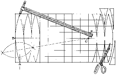

Check this simple non-digital manual method to flatten the sphere into eliptical wedges, called gores - http://octopus.gma.org/surfing/imaging/globe.html
With foam having certain thickness I would first do enough number of kerfs to allow for radial bending, then cut these foam shapes with a jig saw or steak knife from the other foam side with no kerfs for internal circumference surface of the corner.
Then I would tack the shapes together (with kerfs to outside) with something like tooth picks, or nylon strong ties, or short strips of plywood with drywall screws from inside, or other means and then fill the gaps outside with great stuff foam. I would also not bother doing the shapes to a sharp tip, but rather cut the shapes shorter so that will form a hole in the top of the corner that can easily be filled with Great Stuff foam after the shape is installed in place.
I think that would work.. :thinking:
In this case I would also try using the packing scotch tape on the inside to fit the pieces together.. :thinking: Should end up with a good internal surface that way, while external surface can be faired once the GS foam is set.
in boat building they are using thickened epoxy instead of GS foam to fill gaps between foam strips, but that is more expensive and heavier and also not that easy to sand to shape later.

It is a good discussion, I was also thinking of it KC, with internal kerfs the eliptical strips will have to be tapered to be wider outside to have no gaps on outside. Angled eliptical line cut is tricker to do, but possible with right equipment.
When I talked about external kerfs I was mostly thinking of a simple method with basic hand tools like shap cardbox cutter for example to cut internal eliptical shape, cause then only the internal surface line needs to be precise. I found that for example internal cylindrical surface is more difficult to sand, than external, I would imagine that spherical internal surface would be even more difficult than cylindrical to sand than external. There still be some glue or foam residual amount to sand or remove with both internal or external kerfing though. Packing scotch tape then! :thumbsup:

Thank you for the sphere layout! I freehanded mine. The machinist in me loves the precise math. I guess I hadn't thought of kerfing since I'm only using 1/2 foam and it has bent so readily so far. But I could steam the individual arcs and glue it all together. I do really like the idea of the monolithic block that I get with the expanding foam. I'm going to try to shape the two that are already made and see how it goes.

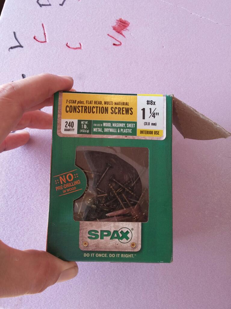

Can you please supply some detail on the fasteners used to reinforce by screwing into the inside panels & wiley windows !

I just used plain construction screws, 1.25 long for the seam brace panels. I also painted a layer of glue on each panel before screwing, so the screws are acting as clamps as much as they are fasteners.
Screwing one in too far will pull it right through the top layer, but just tight enough to countersink the head works real good. Using a ton of small fasteners helps spread out the load as well. I went through 3 boxes of these and only have a handful left, so it's safe to say I have the better part of 700 screws just in my alignment panels.
