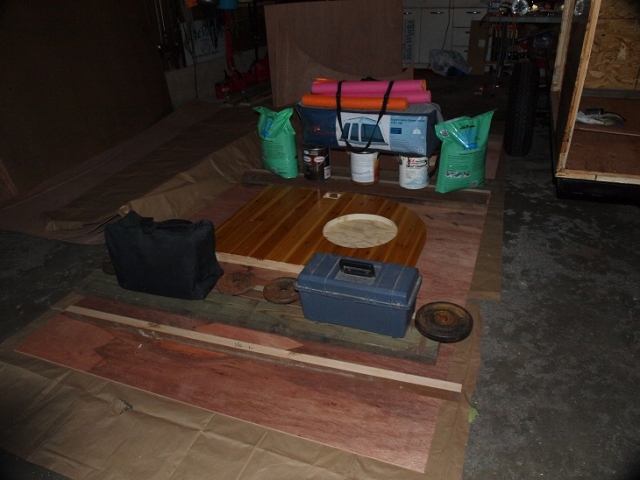

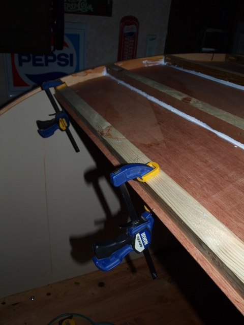

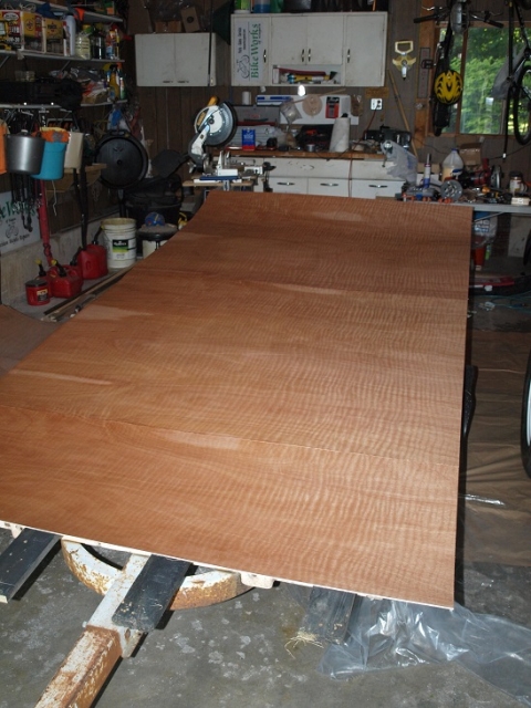

I cut my inner skin and seamed it with PL Premium adhesive. I was going to use epoxy to seam the 1/8" lauan skin, but, with all the praise I've seen here on T&TTT I decided to go with the PLP. Thanks KC for the help again...

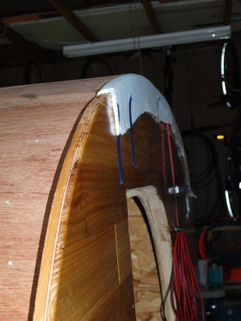

From my boat making experiences I decided to glue a strip of 1/8" lauan on the back of the butt joint. I will document it later with a photo, but, I will back up the seam inside the wall by trimming the rafter at that location by 1/8" to compensate for the extra thickness of the joint. Here's a crappy photo of the seam with half of the backing applied.
And here, especially for KC's enjoyment is the clamping of the seam for the night to assure it will be flat and secure... complete with the extra weight of swim noodles!

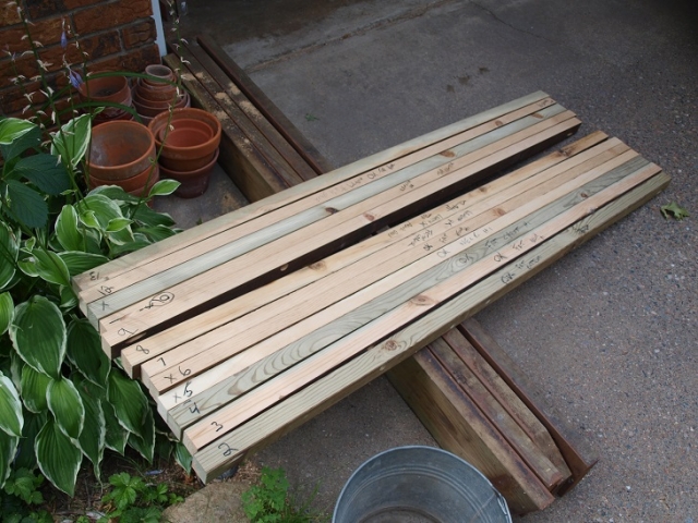

Test fitting rafters

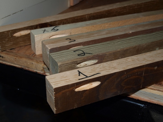

Postby TimC » Fri Jul 31, 2015 6:29 pm
Last two days...
A question for the experts about my hatch rafter (spar) at the end of today's post

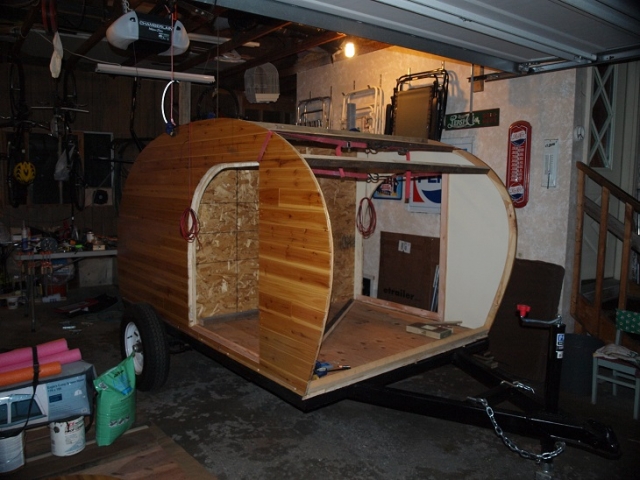

Interior skin prepped
Rafters ready - they are numbered, but, found during install that my numbers were mixed up. I trimmed two rafters 1/8" thinner than the rest to compensate for the seam in the skin being backed up with a rafter. Then I realized I numbered them wrong. :x
Tools at the ready
Blanky to protect skin as I throw the skin over the TD by myself

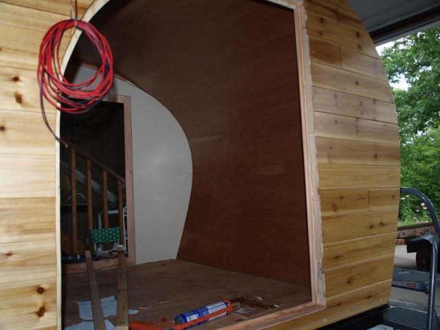

Front installed
Almost done... 99%

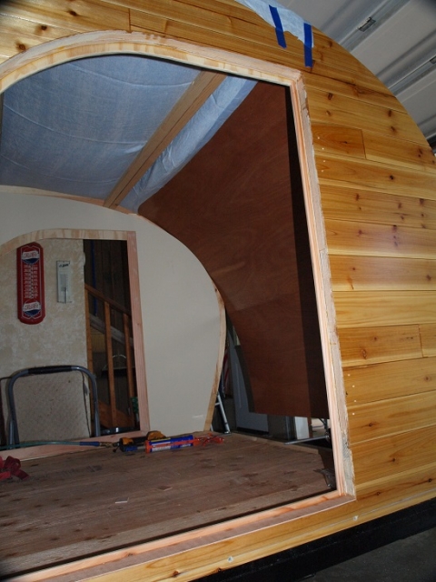

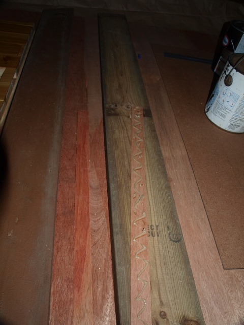

OK, here's my question with a little background info. I'm looking at the Generic Benroy Plan specifically at the last spar in the hatch hinge area. I understand it should be double thickness (3/4 x 1-1//2" ea) per the plans. Even so I have two, 1 1/2" x 1 1/2" rafters cut. Now, do I laminate these two and nail them down at the end of my roof skins? Or, is one supposed to be the front/top end of the hatch frame? I'm a bit confused. I know that two 1-1/2 x 1-1/2 might be a tad over engineered.
I ran out of PL Premium adhesive with four rafters to install. I tried some white silicone caulk on one and decided it wasn't a good idea. I used TBII on the next one and because the TBII was running downhill I ran a bead of white caulk on the downward slope to keep it in place until it dried.
One of my last two rafters in place waiting for next step...

Re: NE Wisconsin Generic (sort of) Benroy 5x8... my first!
Postby KCStudly » Fri Jul 31, 2015 7:24 pm
I'm not sure about the specifics of the generic Benroy plans, but it is a good idea to double up the spars (either by using a solid 2x2 or by laminating two 1x2's together with glue) at the hinge. There is a lot of leverage acting on the hinge, especially if you use gas struts, and you want the foundation for the hinge to be stable.
It's also not a bad idea to use a harder species of wood, like maple or oak, that holds screws better than something softer, like pine.
Postby TimC » Fri Jul 31, 2015 11:02 pm
KCStudly wrote:I'm not sure about the specifics of the generic Benroy plans, but it is a good idea to double up the spars (either by using a solid 2x2 or by laminating two 1x2's together with glue) at the hinge. There is a lot of leverage acting on the hinge, especially if you use gas struts, and you want the foundation for the hinge to be stable.
Thanks again KC. I used two treated 2x2s for the hinge base. Treated just because I had a lot of scrap 2x6s laying around that were well seasoned for many years. It won't hurt to have the rot resistance qualities.
I'm wondering if I might be able to anchor my hatch hinge with machine screws (SS) rather than wood screws. Right now I can't picture what will be directly under that point and whether I will have access to it. I'm putting in cabinets, but, just haven't thought through that process yet. I suppose I can design it any way I want to make it work. I think machine screws would be much more secure than a wood or other tapered screw. I'll just need a buddy to hold one end of the fastener to secure it.

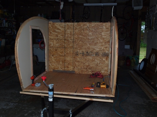

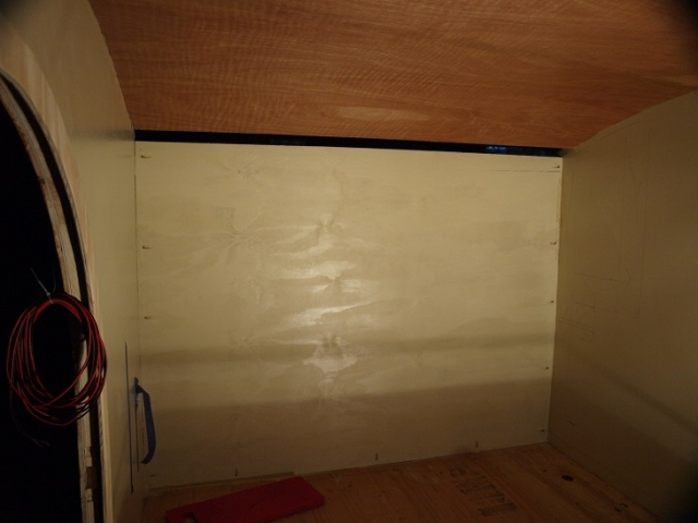

After checking to be sure the walls were plumb I was surprised to see a definite lean in the galley area after removing the deadman. Leaning against the walls brought them into position with a bit of effort, but, I had to provide a good lean and they sprung back as soon as I let them go. My plan was beginning galley, headboard and footboard cabinets next. Trouble was I was worried I needed the whole length of wall to give from the front to back. So, putting in any cabinets before the wall was secure might present some problems getting it plumb later. Back to the drawing board.
What I came up with is a change in how my galley cabinets and footboard cabinets meet. I decided I wanted a bulkhead that went floor to roof height to be sure everything squared up and stayed that way. It doesn't look like much yet. It will just be the insides of cabinets anyway and the short part that shows at the footboard will be skinned with lauan.

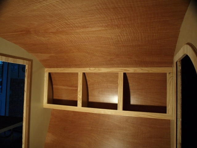

After solving the leaning problem I decided to start with the headboard cabinets. They turned out very nice. Makes me more excited to begin designing of the rest of the cabinets.
The sides will have cabinet doors and the middle will be a cubby for stuff. The partitions on each side of the cubby were a challenge. I'll have to put in a little trim to hide the gap. I'll be building all the doors at the same time to eliminate extra tool set-up for the rail and stile frame.
