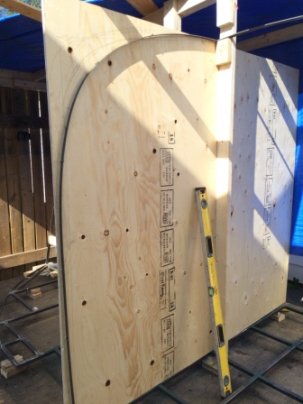

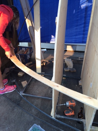

yesterday's progress---- note the 3/4 x 1/8 flat bar----perfect bendy ruler !! i tried using my arm like a giant compass, but the pencil lines were too faint when i stepped back to contemplate. the bar i just wedged in at the ends, then used screws to adjust the curve and hold it in place......
sacr. bulk. 1.JPG (64.25 KiB) Viewed 2062 times
this curve, like the roof line, has no flat spots and over hangs the edge of the base.....

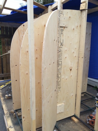

sacr. bulk. 2.JPG (77.04 KiB) Viewed 2062 times
today i will continue with the plywood----no welding nothin' until i'm damn sure the curvature works both vertically and horizontally !

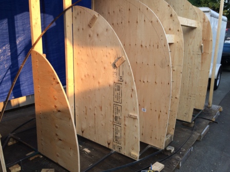

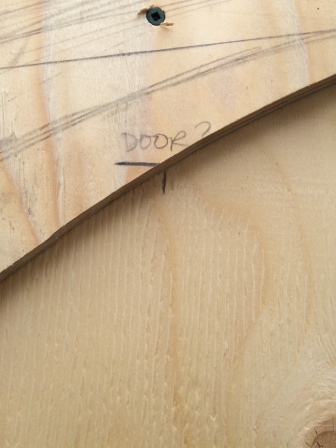

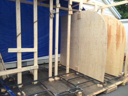

today i continued with the bulk-head bulk-out. using the previous day's profiles, i ignored the centre spine's front curve, and utilized the radius that is occurring over the door. after pondering this from EVERY angle and over a cold beer, today's decision is to continue this radius right around the front, to the other side. i still get the massive forward lean that is so appealing, but no messing around physically and visually with a change in radius as i wrap around the corner....

the gut is just as important as the brain, and i listen to mine with great respect------
sacr. bulk. 3 door.JPG (53.9 KiB) Viewed 2050 times
a view of the whole shebang----
sacr. bulk. 5 right side overview.JPG (74.02 KiB) Viewed 2050 times

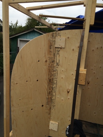

one more view of the front corner---showing the panel that sits to the right of the door and the panel that sits half way around the front corner. looking for a good roof top here---

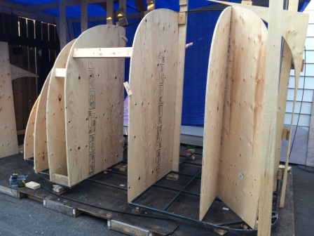

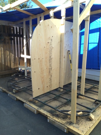

this phase is pretty slow, as i want these diminishing curves to be just right. as things are (as seen in the photos) i think that the rear-most plywood bulkhead may be a little steep---as i discovered with the previous piece too ! so it may also get a wee add-on to flesh it out a few inches. this is the head of the bed, and space is crucial--almost as crucial as how the outside looks ! the concensus at this point is to ixnay on the bed-to-couches scenario and keep the matress as close as is comfortable to the floor. there is nearly 60" between the wheel wells---plenty of room for a double-plus bed. if we put the bed on top of the wells, then 75" is the bed width but we lose crucial head clearance at the pillow end.
convertible couches and table ---not so important---seeing as there is a lot of room for a wee table setting at the front end :beer:
curvy coniptions.JPG (75.45 KiB) Viewed 1938 times
using a template of the curvature from the base of the trailer. at 6" increments we measure from the centre to this board, always keeping the rearmost point of the board and the spinal column together. didn't quite work as planned. both times we used this method i found the walls to taper too quickly
curvy coniptions 2.JPG (69.58 KiB) Viewed 1938 times
curvy coniptions 3.JPG (69.8 KiB) Viewed 1938 times
note the scabbed-on re-curve on the second to last piece

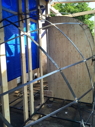

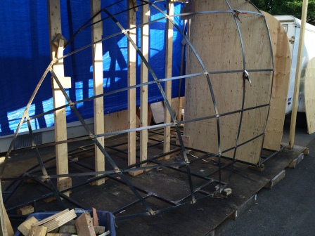

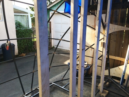

today's update--- bought a fat sac of C-clamps and started weaving metal strips around the plywood structure. turns out the ply was not totally necessary ----handy yes but when you clamp the metal strips just on the ends--and use as little effort as possible to make them lay flat at their start and finish positions-----they just sort of fall into place and the metal bows the way it is inclined to. do this vertically AND horizontally and try to have no gaps between overlapping rods and the shape almost dictates itself !!
before i welded all the joints together, while they where just clamped, the structure had a very pleasing round shape. it was perfect----but as i welded each joint, it heated up and the tension was lost--giving it the faceted appearance. not all bad though
either i will work with it or overcome it........
trailer weaving 101.JPG (83.44 KiB) Viewed 1882 times
trailer weaving 102.JPG (83.29 KiB) Viewed 1882 times
trailer weaving 103.JPG (90.83 KiB) Viewed 1882 times
