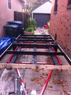

Postby mariannf » Tue Jan 05, 2016 6:31 pm

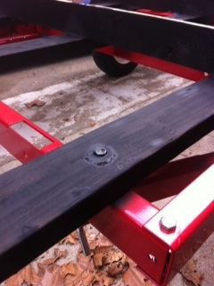

subframe on1.jpg (39.86 KiB) Viewed 13037 times
here are pics of the subframe bolted to the trailer frame. I used 3/8 lag bolts with self-locking nuts. There are 6 bolts running the length of each 2x4.
again there are 1x4s glued and screwed (from the bottom up) to the 2x4s this gave the subframe enough height so that the floor (which i will attach next) cleared the fenders.
the wood frame and floor over hang the trailer frame by 1 foot at the front and back and 6 inches at each side.

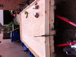

Postby mariannf » Sun Jan 10, 2016 5:34 pm
Pics of the floor attached to the sub-floor. Used used 1 1/4 construction screws and proline adhesive. Next will be work on exterior walls.

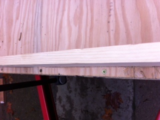

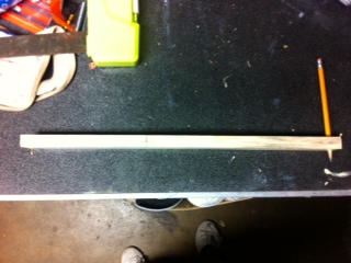

Postby mariannf » Wed Jan 13, 2016 12:15 am
I started work on the walls. began by making a simple compass to draw the curve of the wall. I used a 20 inch piece of 1x2 and marked out 19 inches and found the center at both ends. I put a screw through one center point and drilled a hole for a pencil at the center. it worked great. pics of compass and the drawn curve on the 5x10 which is probably hard to see. I haven't done much wood cutting and plan to cut the wall curves with a jig saw. i did a practice cutting a curve on a 1x4. It turned out Ok, but the wall cut is much longer. any advice for how to make a good clean cut? I noticed on my practice that the top and bottom of the cut have a slight angle.

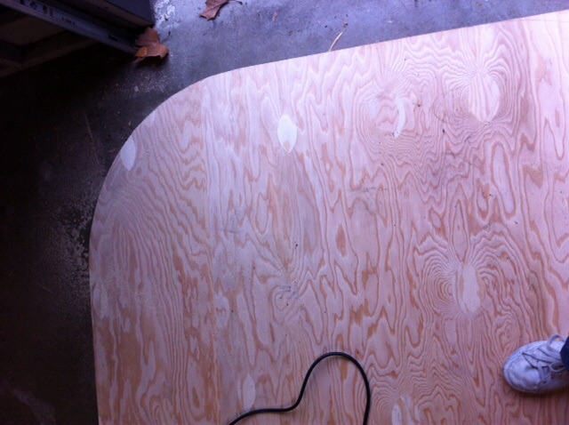

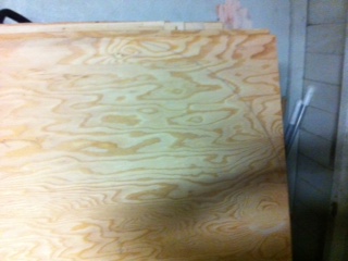

Postby mariannf » Mon Jan 18, 2016 11:56 pm
Made the exterior wall curve cuts. They are at 19 inch radius. Used a jigsaw, and cut first wall first then laid second wall on it and traced curve. After all cuts I sanded each curve. They are not perfect curves, close but not perfect is this a problem? Should I do more sanding?
