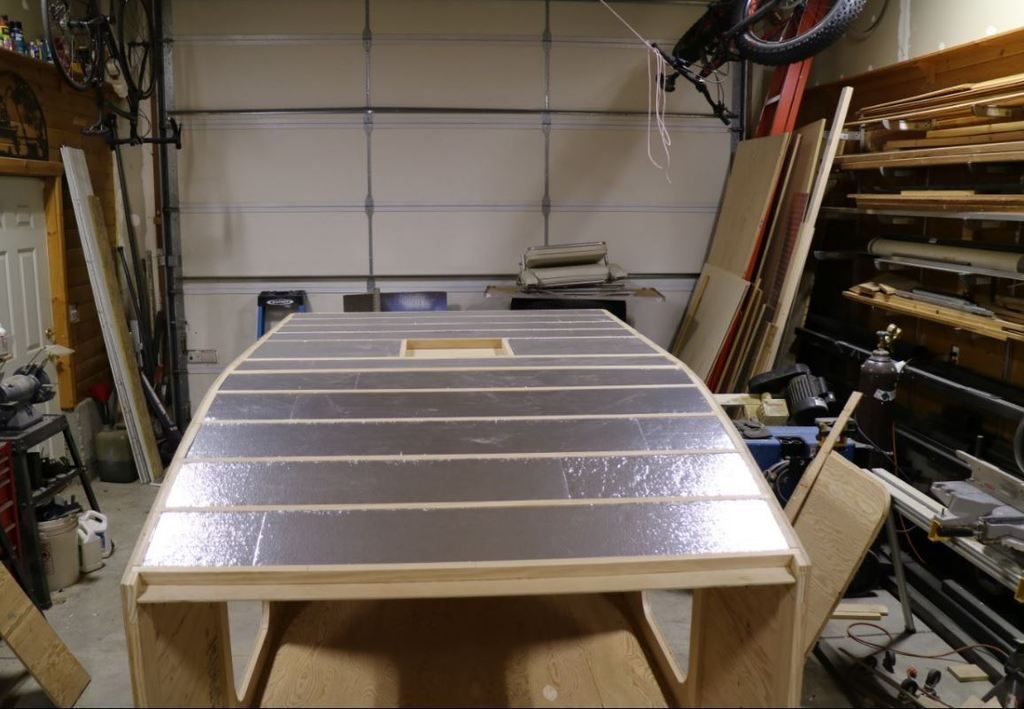

Postby jkidd6339 » Sun Feb 21, 2016 9:32 pm

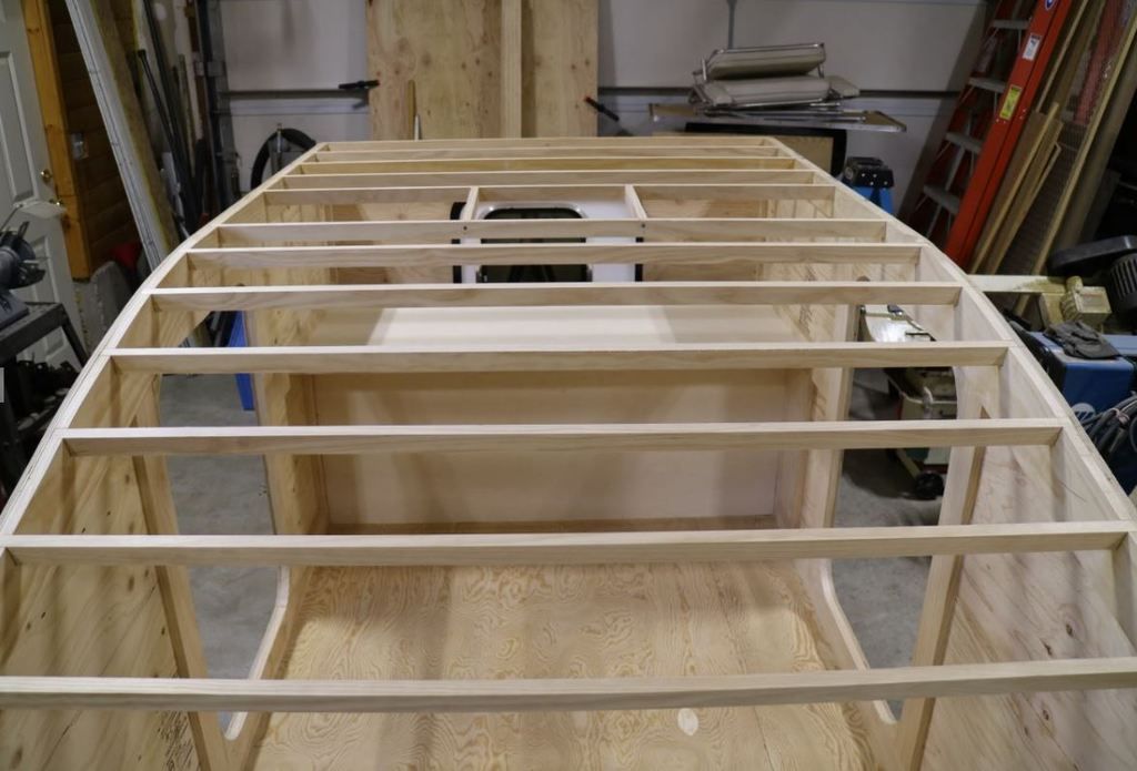

Ready to start on the insulation.

You've been busy! Lookin' sweet, real sweet! That's the frame of my dreams if I were to downsize. Aspiring builders would be wise to watch this build closely. Congrats on the progress my humble friend.

You're at a milestone! Once the walls & roof spars are up, it gets much more exciting because it's really looking like a camper now instead of a frame and some wooden parts sitting in the workshop. :D
What kind of insulation are you planning on using? I went with 3/4 thick styrofoam, doubled to 1.5 inches on the ceiling.

Postby jkidd6339 » Tue Feb 23, 2016 12:19 am
Same as you 3/4" in the walls 1-1/2" in the roof

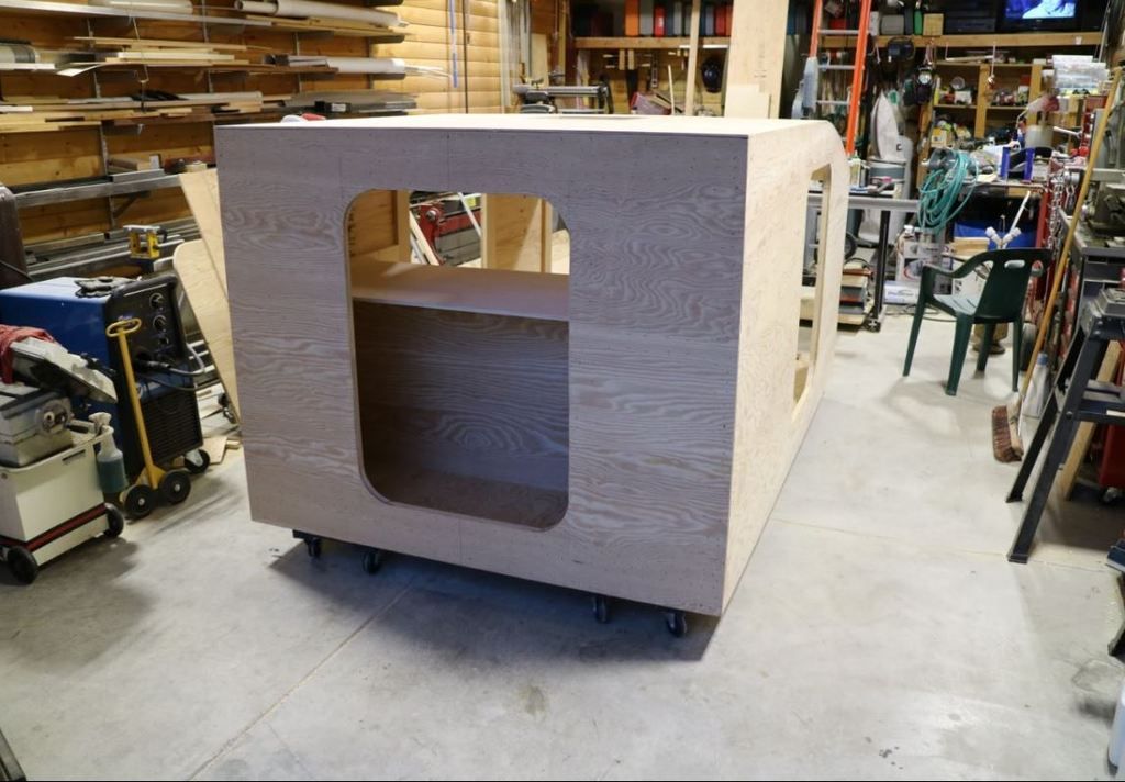

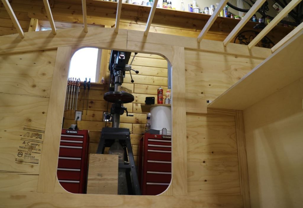

Postby Mushin » Tue Feb 23, 2016 11:08 pm
I'm a little confused, is that a door in the front?

Postby jkidd6339 » Wed Feb 24, 2016 12:55 am
No that's the rear just cargo space.

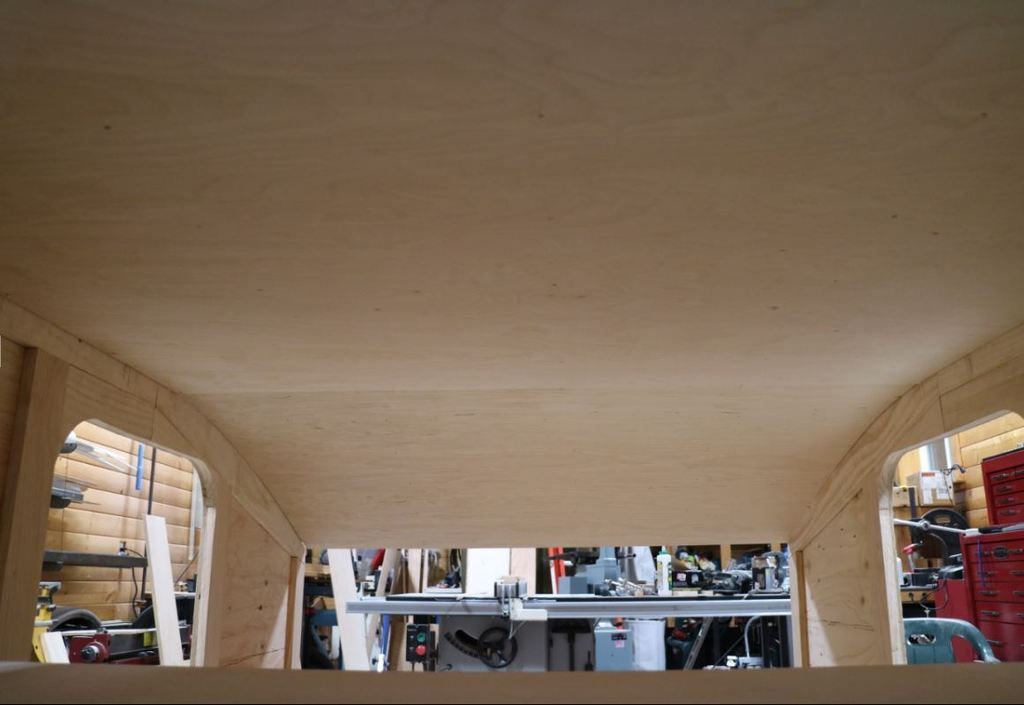

Postby jkidd6339 » Sat Feb 27, 2016 11:33 pm
Got the ceiling in today.
and the roof insulation.

Postby lfhoward » Sat Feb 27, 2016 11:36 pm
That ceiling looks really nice. :thumbsup: Baltic birch plywood?

Postby jkidd6339 » Sun Feb 28, 2016 12:04 am
Yes Baltic Birch

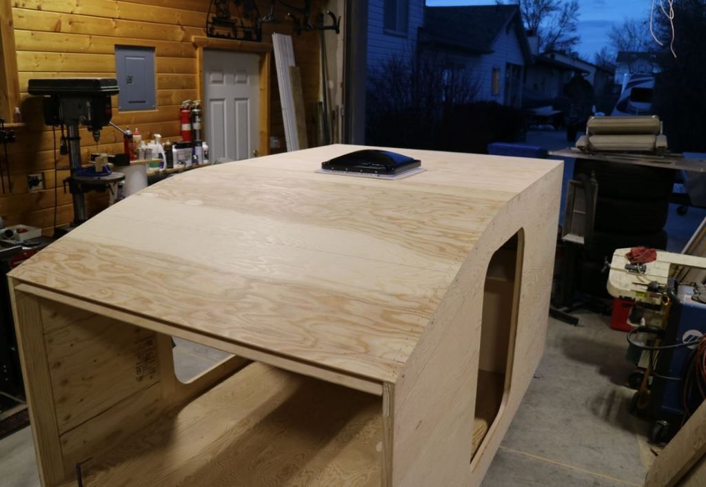

Postby jkidd6339 » Sun Feb 28, 2016 9:46 pm
Thanks for the kind words everyone. Today I got the roof on and the rear wall ready for insulation. It's really starting to take shape. On my 5th bottle of glue.
