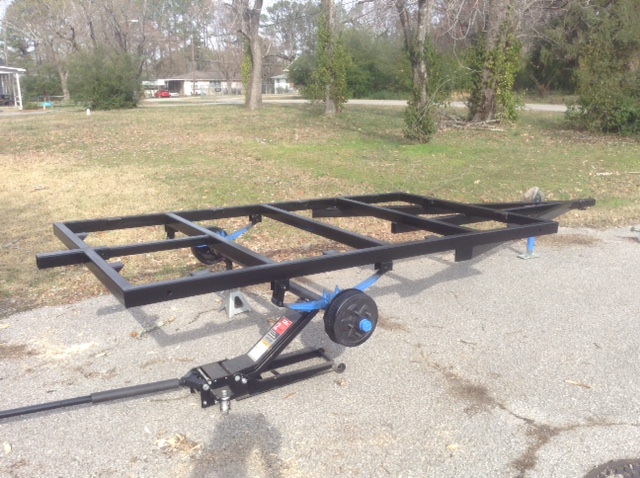

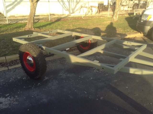

Primered the trailer last Friday. Ready to be sanded and painted.
Primer 1
Primer 2
Primer 3

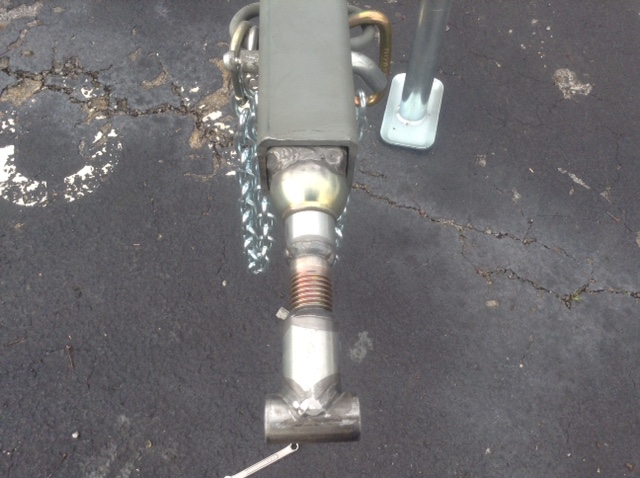

Here's the trailer half of my homemade, diy, experimental, off-road coupler. More pics and a review to follow...

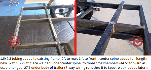

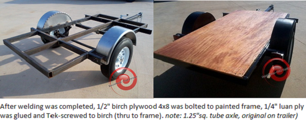

  • Maybe I'm comparing apples to oranges, but I took a sub-250 lb trailer frame beginning (50x60, w/8"wheels) to a 4x8 trailer (14" wheels now), deck and lighting finished. I added 2 ft. to the rear, and 1 ft to the front, with a center spine connecting all, with 1.5x2.5 11gauge tubing, matching the original tubing. A 6 ft piece of 3x3x.187 steel was welded under the center spine, to become my 44" single beam tongue (with 28" underbody).
    tubular steel for added length and strength.png (298.59 KiB) Viewed 2655 times
    welding done, ready to weigh.png (242.48 KiB) Viewed 2655 times
    It weighed exactly 400 lbs. That was when I was using the original 1.25" square tube axle and springs (of unknown weight rating). After much alteration, repairs (including adding a Dexter 3500 lb axle, brakes, 25.25" springs, peripheral hardware, and my own frame reinforcement/attachments, and bumpstop contrivance), camping gear and trailer additions, I figure I have it up to 1750 lbs, or so (last reasonably calculated at 1630 lbs, with any accuracy, 2.5 years ago). I can still barely lift the tongue (bad knees and back), so I'll stop there, with the changes.

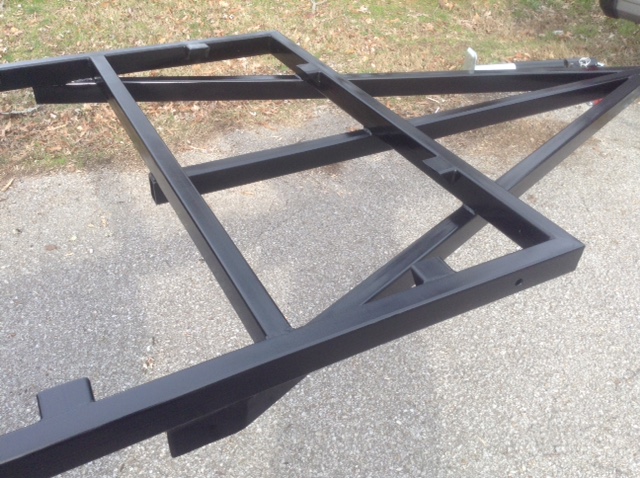

Postby kokomoto » Tue Feb 21, 2017 9:52 am

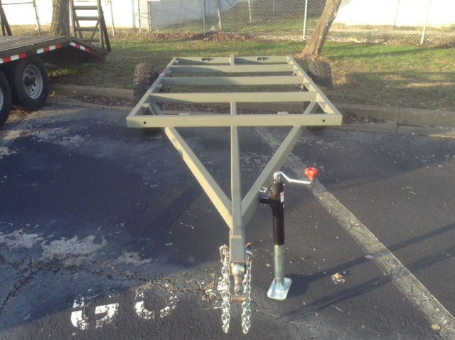

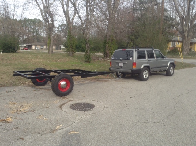

Trailer is now painted with Rustoleum gloss black. I used 4 cans to get the job done.
Painted 1

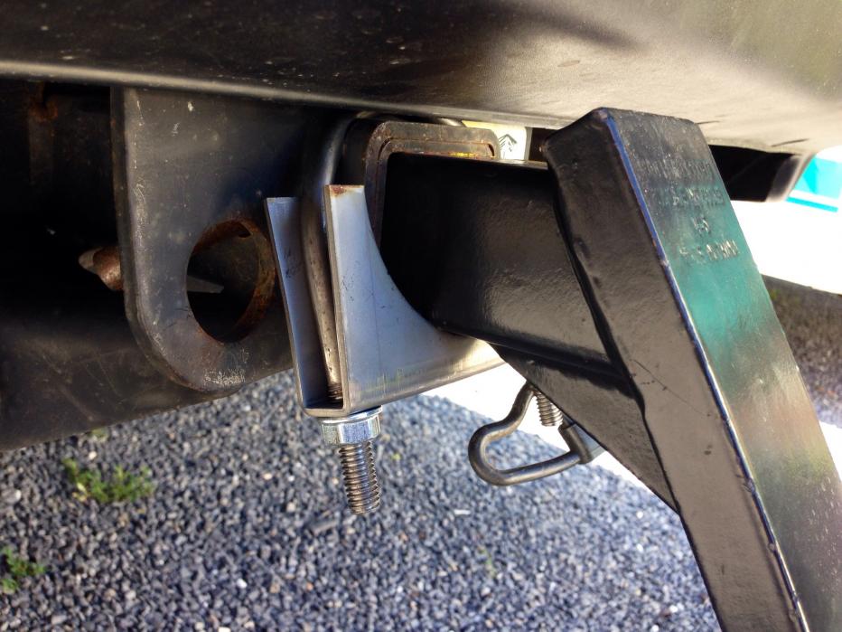

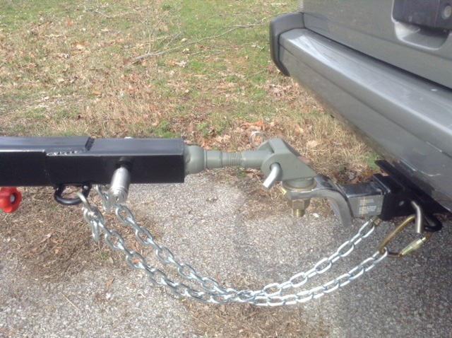

The coupler seems to function properly. There is some rattle, but I think it's from the receiver.
Coupler

kokomoto wrote:The coupler seems to function properly. There is some rattle, but I think it's from the receiver.
The attachment image.jpeg is no longer available
Put a muffler clamp on the hitch to stop the rattling. You can buy one for a couple of dollars or buy a clamp from the trailer guys for at least 10 times that amount.

Postby kokomoto » Mon Feb 27, 2017 1:08 pm
[/quote]
Put a muffler clamp on the hitch to stop the rattling. You can buy one for a couple of dollars or buy a clamp from the trailer guys for at least 10 times that amount.[/quote]
Good idea. Thanks for the tip! :beer:

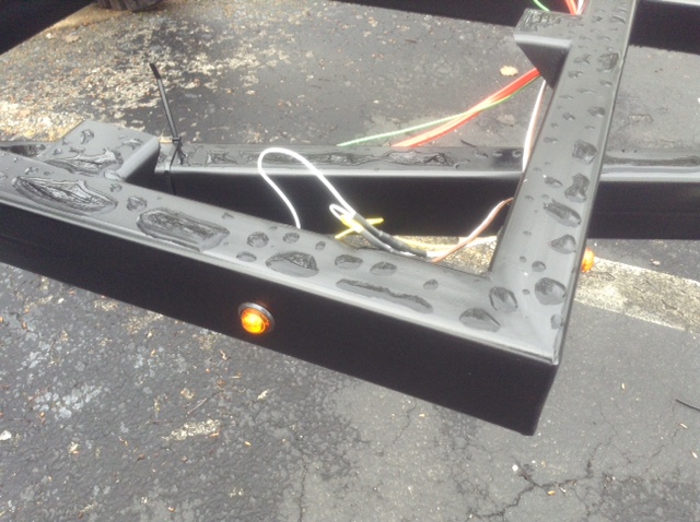

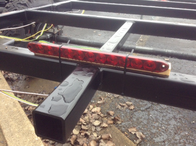

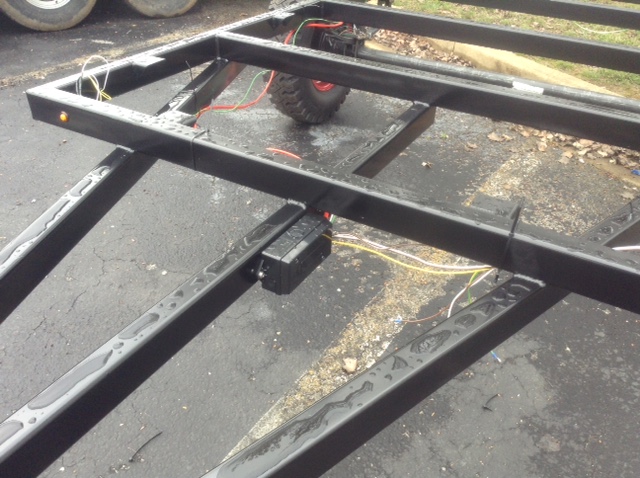

Postby kokomoto » Mon Feb 27, 2017 4:34 pm

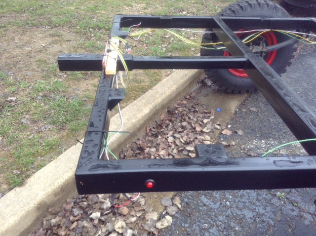

Junction box
Tail light - temporary mount
Rear clearance light

Postby kokomoto » Mon Feb 27, 2017 4:35 pm
Front clearance lights
