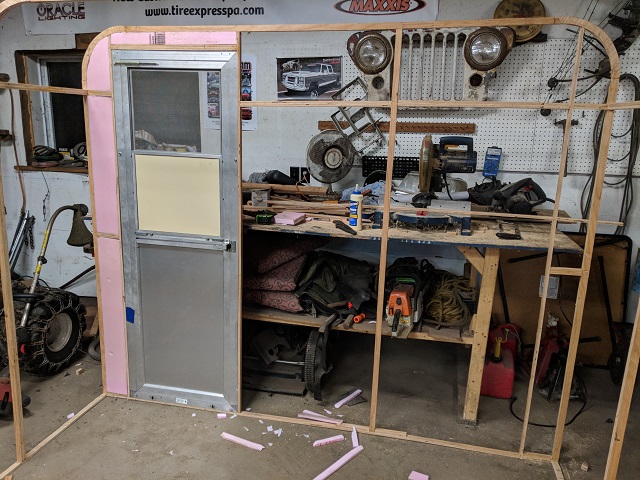

As planned, I got the back wall of the slide out framed and even loosely put in a door. I took the door from the old pop up. It is a bit short so I may change it around a little. I am thinking about raising it so I don't have to duck to get in. There is already a frame at the bottom that will need stepped over so raising it 2" shouldn't be that big of a deal.

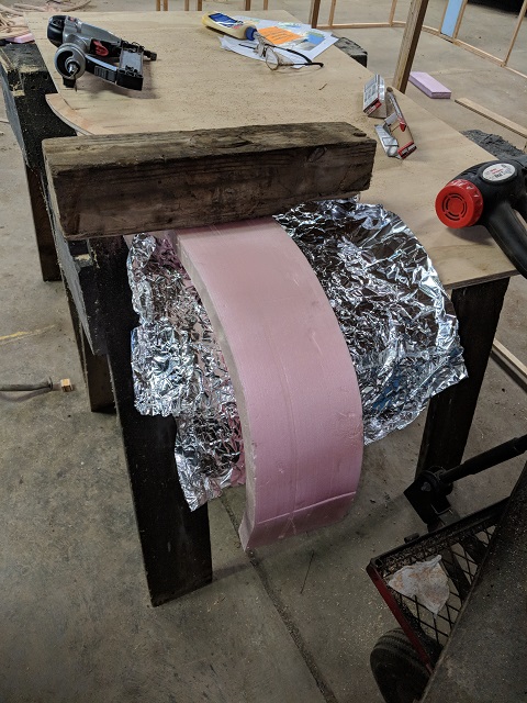

I played around with heat bending the 1" foam some more. I found that a foil backer helped distribute heat around the back.

Pretty cool. The foil is an excellent idea.

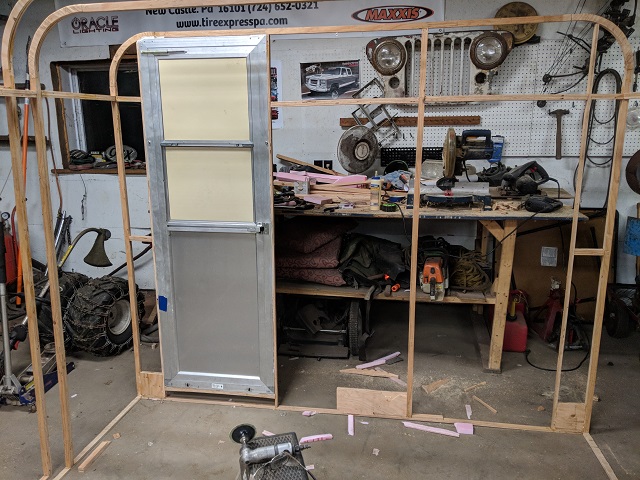

I raised the door last night as high as I could. I even notched the one corner so it would fit in the radius in the top left. I no longer have to duck to walk through. :thumbsup: The door is sealed up with liquid nails (I used up a tube I had on the shelf) and is screwed in from the sides with some self tappers. Then i made backers on the bottom corners and bottom center of the slide out for the wheels.
