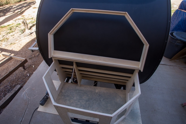

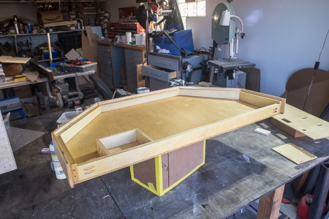

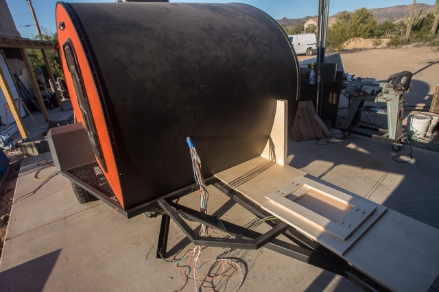

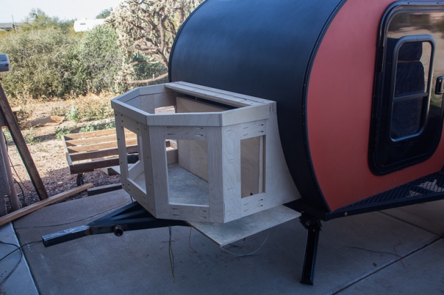

The start on the tongue box.
If I had to pick the most difficult part of the build I would say it's the tongue box. Lots of angles. And I spent a lot of time making sure water and dust won't be able to get in. And probably way over built it.
I'm going to do the tongue box different than the cabin. Just Baltic Birch, epoxy, and bed liner. I may do a high build primer if the epoxy doesn't sand smooth. I want to see how this goes for maybe for the nest build.
The lid getting poly on the inside. Note the cardboard box with the yellow tape, that is a mock up of the battery I'm thinking of buying. Want to make sure everything fits in the tongue box. This is the third size box I made, just can't decide which way I want to go.

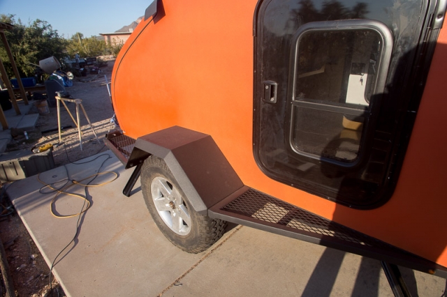

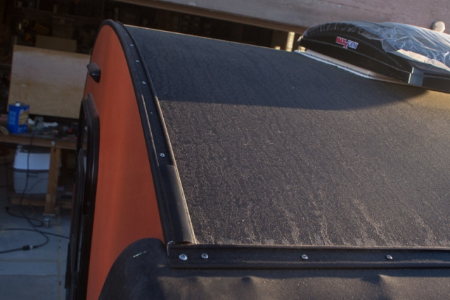

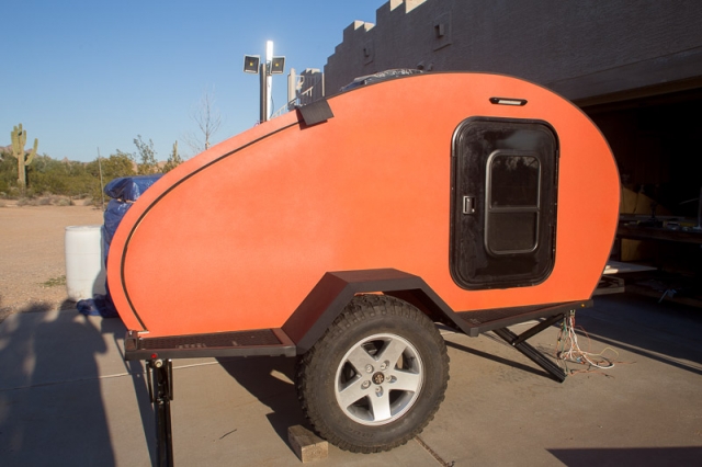

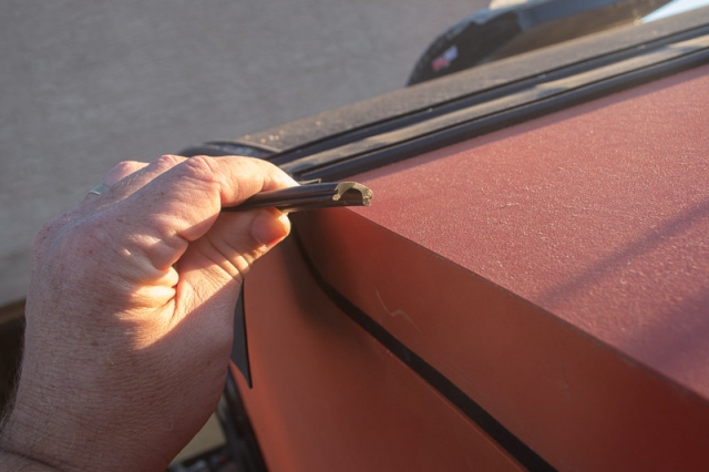

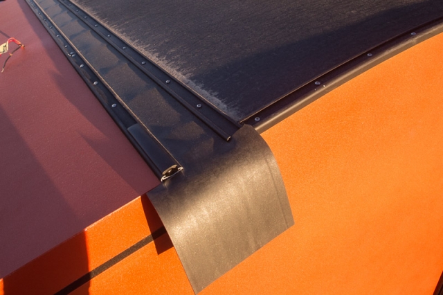

FM82 wrote:Wow! Lots of progress. You were really holding out on us. Looks great, man. I'm really liking the craftsmanship of the galley hatch. I agree with you about the fenders. Since they can be easily swapped out, maybe go at it again, but change up the angles? Just imagining a limb, or something similar getting thrown up and getting wedged in between the tire and fender.
Can you give some details on your roof edging? I'm torn between the vinyl insert style, or the one without. I prefer the look of the trim without the vinyl insert like you have used, but I'm not sure how well the rivets will hold water out over time.
Sent from my XT1650 using Tapatalk
There is a little more room than is looks from the tire to the fender, I'm just going to live with it for awhile and see how it goes. I know a guy that has 35's on his Jeep and maybe I can put his spare on to see how it looks.
I agree with you on the edge trim with the vinyl insert. I'm not not a fan but that is what I used. :lol: But not with the vinyl insert, I found this other insert that looks way better. I just got mill finish aluminum the place I ordered from had black anodized and I'm almost wishing I went that route. I sprayed first with acid etch primer then flat black paint. I hope it holds up.
Hope this helps.

Postby FM82 » Wed Dec 26, 2018 9:40 am
That insert does look much better. Looks to have a lower profile than the standard insert that I've been seeing. Where can I find that style?

Postby KTM_Guy » Wed Dec 26, 2018 10:05 am
FM82 wrote:That insert does look much better. Looks to have a lower profile than the standard insert that I've been seeing. Where can I find that style?
Nice work on the tongue box, by the way!
Got it at amazon. https://www.amazon.com/gp/product/B01N4PZHLW/ref=oh_aui_detailpage_o07_s00?ie=UTF8&psc=1

Postby FM82 » Wed Dec 26, 2018 10:48 am
Yes, that looks much better! I'll most likely be using the insert style trim now. Thanks, Todd!

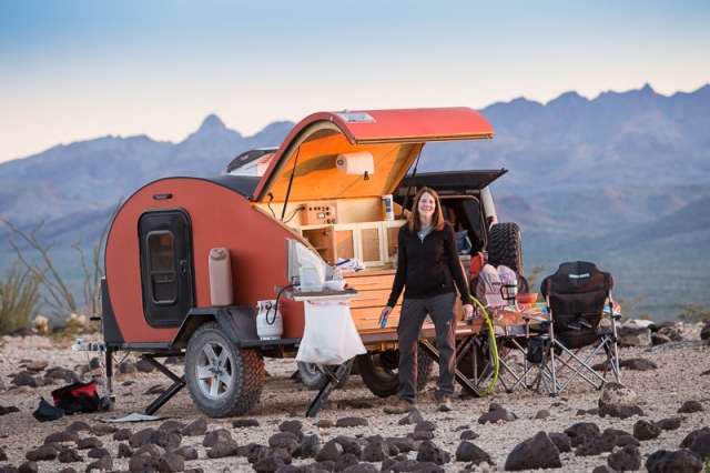

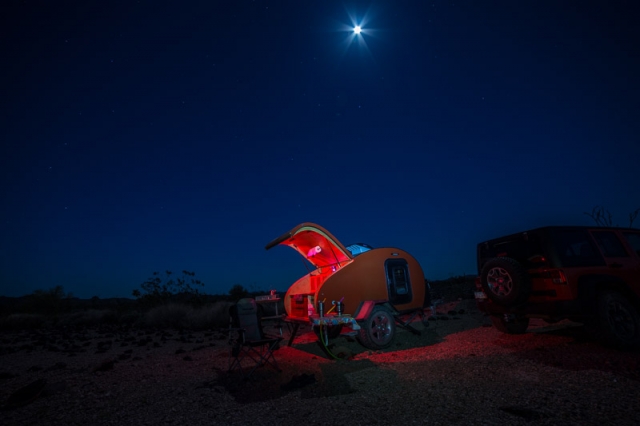

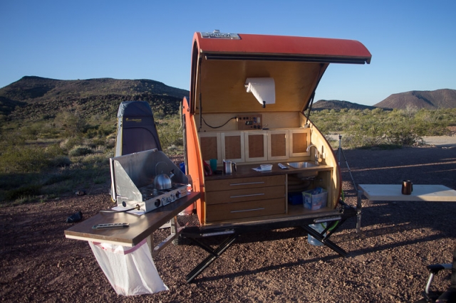

I've been real bad about keeping this updated. I have been working on getting ready for a trip and haven't been taking pictures of the progress. But here are some photos from our first trip. We did two nights and drove about 550 miles, 40 or so off road.
We camped with some new friends that have a Turtleback trailer with RTT.
I'll try to get some close up shots of what I have done since the last build post. I had to just get a lot of things done temporality for the trip and am now going back to fix those things now.
