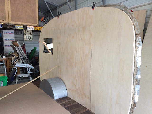

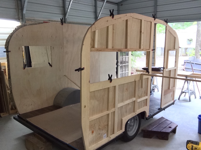

Postby 2bits » Tue Aug 14, 2018 3:57 pm
I am glad you were able to find what you needed! usualy when I buy something on craigslist it is in West Fort Worth and I am 30 min East of Dallas!!
Oh and boom, I got my interior panels cut and in place today!!

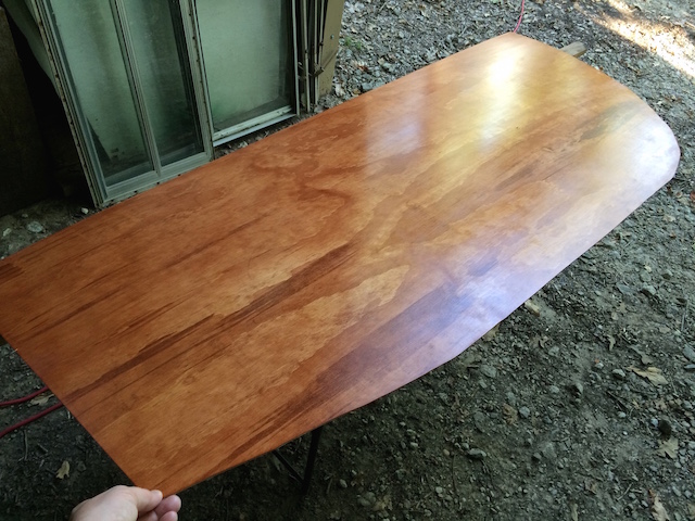

Postby 2bits » Fri Aug 17, 2018 10:13 pm
Just goes to show you never know what the grain is going to do, this is the far right panel which is the most bland of the three and now it looks incredible.

Postby tiiiiii85 » Sat Aug 18, 2018 6:10 am
2bits wrote:Just goes to show you never know what the grain is going to do, this is the far right panel which is the most bland of the three and now it looks incredible.
Damn, it looks amazing!!

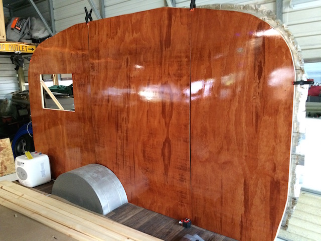

Postby 2bits » Mon Aug 20, 2018 12:04 am

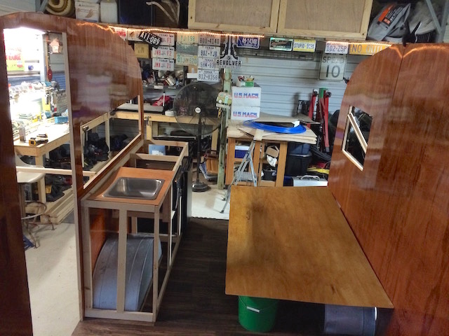

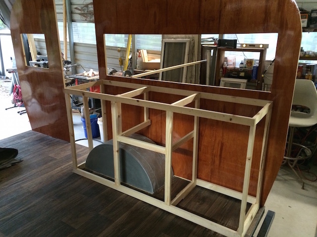

Moving fast! Walls are done and look great. Finished 95% of the kitchen framing today. Need to add a shelf under the sink area and raise the fridge to the same height as the microwave and I will be ready to move on to the bed framing.
In the last pic I have a piece of plywood the size of the twin bed set in place to get a feel for the 18" wide walkway and it is very comfortable. This layout is a winner and allows for the twin to be converted into a full bed and has 3 1/2 feet of countertop space not including the sink! I love that the kitchen area is wall to wall window also. Ever since I had the '58 Kenskill I have a love for the bed orientation like this.

Thomas, those panels look amazing.. maybe i missed it. What finish did you use on them?

Postby 2bits » Mon Aug 20, 2018 9:42 am
Staryder61 wrote:Thomas, those panels look amazing.. maybe i missed it. What finish did you use on them?
Oh, you're right, I never said. At first, I was really dead set on using shellac I guess just because it is the original vintage style and I have always wanted to do one like that, plus I already had three cans on the shelf but I did some testing and with it being so hot it kept gumming up on me and you can only dilute that stuff with denatured alcohol so much so I decided to go back to stain. I tried Golden Pecan because it is supposed to be very similar but it didn't flick my bic and in the end I went my old favorite stain color "Gunstock". I used the same color on my teardrop and loved it's full, rich tone. At first I used the water based polyurethane but it was horrible. It just ran everywhere, streaked and after three coats of glossy it looked like I hadn't done anything at all so again I went with the tried and true regular oil based poly after hotting it with some 220 sand paper. I guess I was trying to save time with the water based but when you are doing 6 big panels by the time I finished number 6, number 1 was ready for another coat. This is three coats.
Longer story than you probably wanted to hear eh! Now I know in the future to just do what works! I wasted a whole day with that dang water based poly and another messing with the shellac!
