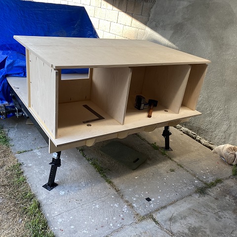

Postby eLink » Thu May 14, 2020 11:53 pm
Just checking the side wall for fit.

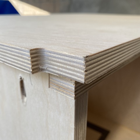

Re: The Coddiwompler
Postby tony.latham » Fri May 15, 2020 9:04 am
She's looking sweet.
I just can't quit staring at the plys in the Baltic birch. Flavoring for the eyes.

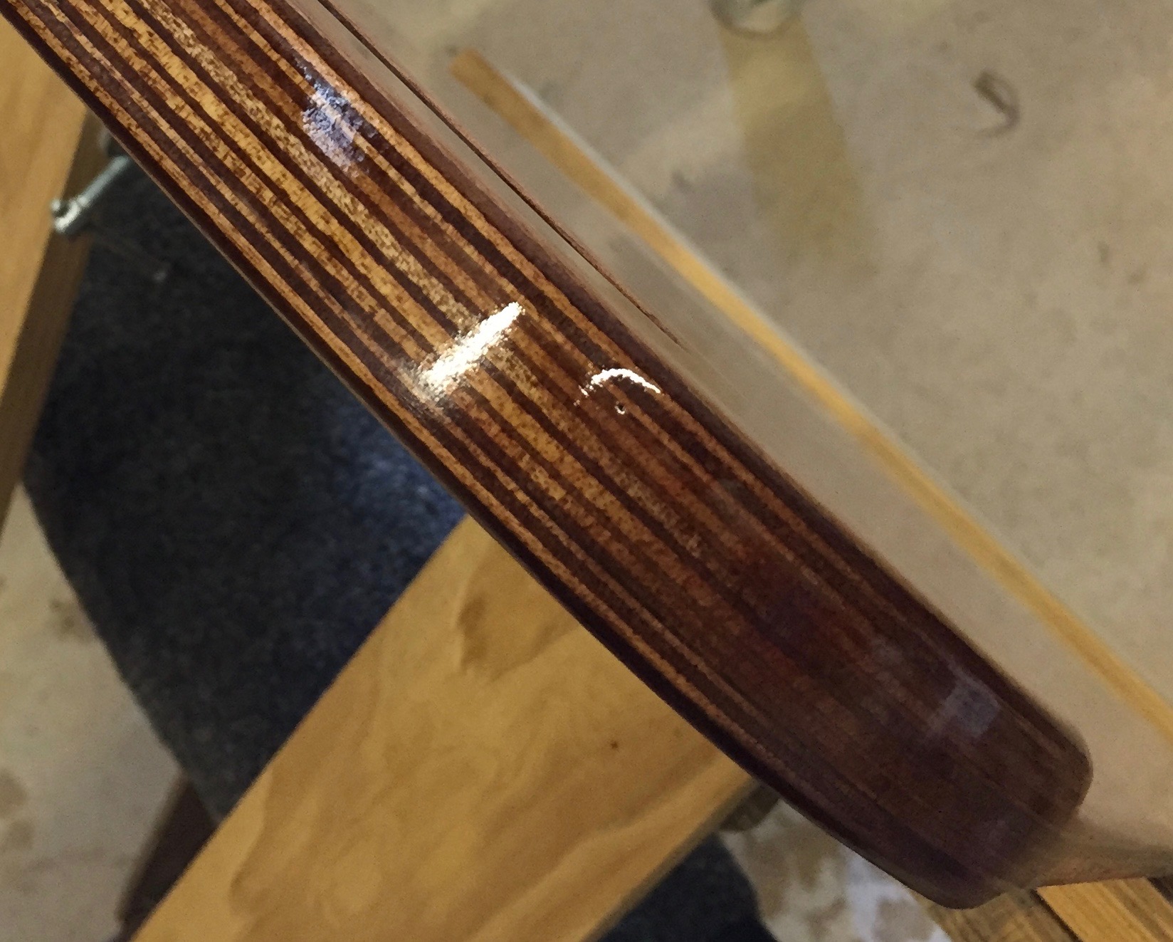

Postby swoody126 » Fri May 15, 2020 9:29 am
tony.latham wrote:She's looking sweet.

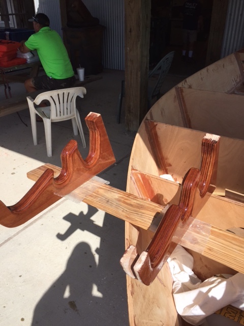

Tony, i have2 agree
high quality plywood w/ many veneer cores can be finished out to become a focal point in the right build
depending on the variety of the wood w/ or w/o stain
filing w/ epoxy and a high gloss varnish to top it off
for the top of a daggerboard in a dinghy
or as rod holders in a custom one of a kind flats fishing boat
Curley's rod holders.jpg (101.95 KiB) Viewed 4103 times
IMHO too many folks don't appreciate and tend to hide the edge grain of fine plywood
sw

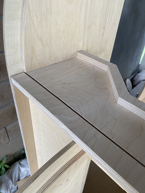

Postby eLink » Fri May 15, 2020 10:59 am
Thanks!
Yes, it's all about the plywood endgrain for this design!
Check out this site for some great plywood porn: https://kerfdesign.com/

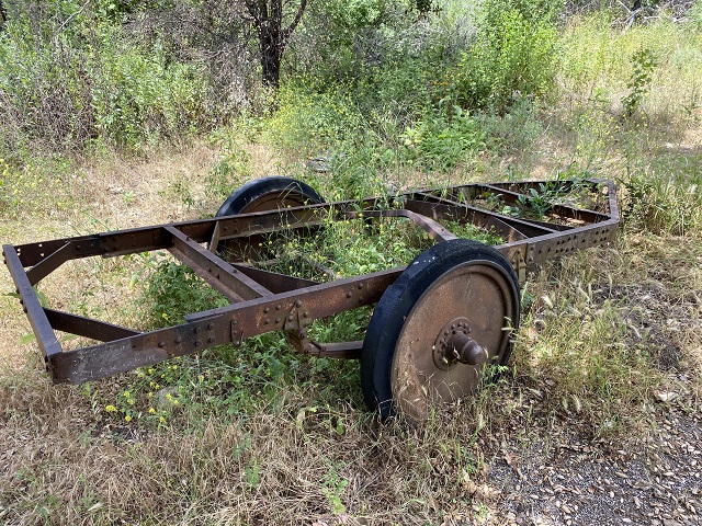

Postby eLink » Sun May 24, 2020 11:19 pm
There's a hiking trail nearby with old farm and construction equipment strewn around.
Maybe this old trailer can be repurposed into a new camper!

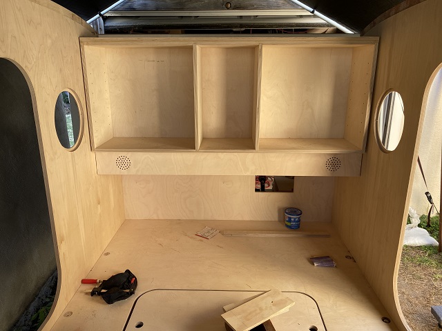

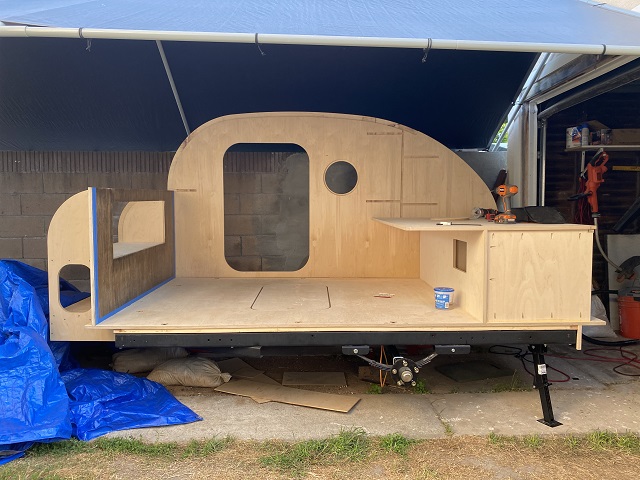

Postby eLink » Sun May 24, 2020 11:48 pm
Starting to look like a teardrop!
Just dry-fitting everything for now. But can't help feeling excited about it!

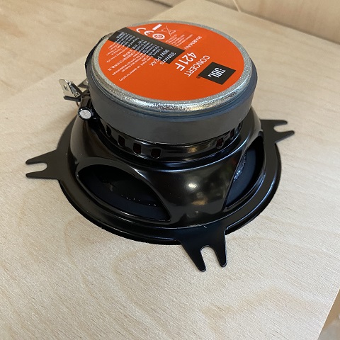

This is a fun little detail. Custom built-in speaker grills. Hope it sounds alright!
Notes: The CNC router is very accurate, but it didn't account much for human error, sagging steel frame and other natural conditions. I had to widen all of the dadoes to get everything to fit easily.
A jack was used to straighten the frame enough for the side-walls to slip in place.

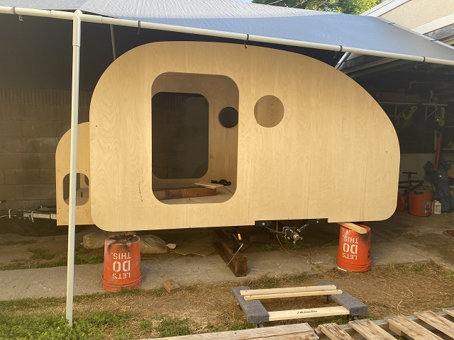

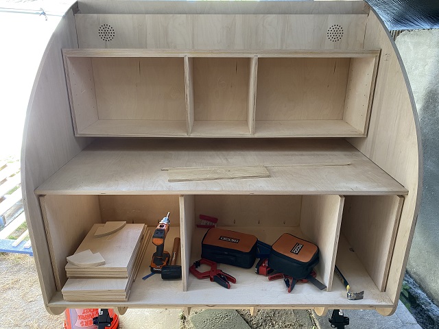

Postby eLink » Sun May 31, 2020 11:59 pm
This headboard shelf is gonna be sweet!
It's almost time to commit and glue everything together. I can see that I will need to enlist the help a couple friends to get it done right. I'm finding that it's a bit too complicated for one person!
First I will disassemble, then sand and seal.

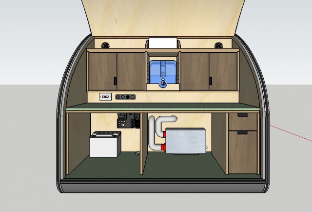

Postby eLink » Mon Jun 01, 2020 12:07 am
I really need to figure out my electrical concept. One thing I have been wondering is if an AGM battery can occupy the same space as the PD4045 switchgear. Is there any problem with this setup?
eLink
Posts: 191
Images: 142
Location: Los Angeles
Postby tony.latham » Mon Jun 01, 2020 9:28 am
It should be fine. As my propane installer friend would say, "it shouldn't blow up." :frightened:
