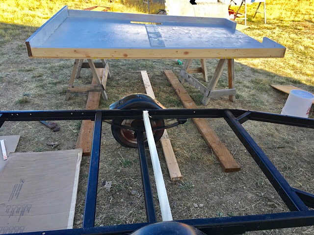

Postby NevadaBlue » Tue Oct 15, 2019 4:54 pm
I managed to get the floor off the trailer and flipped over onto some sawhorses. All the perimeter framing is now glued and screwed to the floor as is the center brace. Two coats of white 100% acrylic house paint cover the underside.
Tomorrow I hope to drill the frame for the mounting bolts and at least get the floor back onto the trailer. Only a couple of nice weather days left... gotta hurry. That bare center member in the frame is what supports the joint between the plywood floor boards. It will be screwed down there also.
I just got back from the hardware store with a pile of mounting hardware. I should also raise the fenders tomorrow too, BEFORE installing the floor.

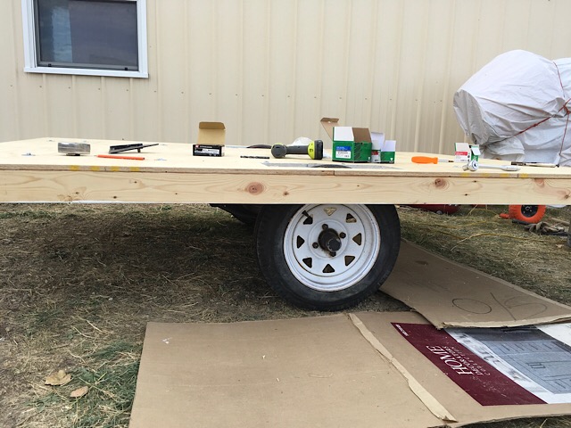

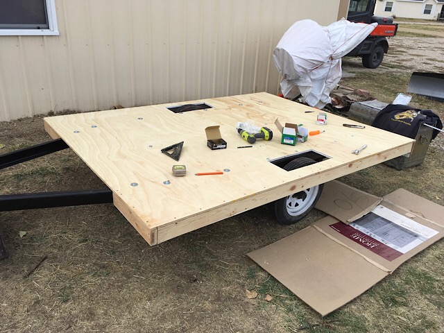

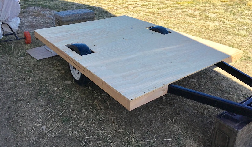

Postby NevadaBlue » Wed Oct 16, 2019 5:22 pm
It was a hassle, fun and work, but... I’m ready to build walls now! I started taking off the fenders so I could raise them. Rusty and tight bolts... the second one broke. That’s the best way to get them off, but I didn’t have anything appropriate for replacements. That meant a trip to the hardware store. And, time to think about fenders. I dedided to leave them off. That is 8.6 pounds of steel... EACH! So, now I can carry more bacon in the cooler.
:lol:
I got the spring mounts bolted back up, without the fenders and one of my sons just happened by in time to help me get the floor back on the trailer frame. Then I proceeded to bolt it to the frame. LOTS of holes to drill in the frame and bolts to install. I used all nylon locking nuts too. No worries about coming loose.
Here’s what it looks like now. I’ll build my own ‘fenders’ over the holes. Also, it looks like there won’t be any issue with clearance for changing a tire. Good stuff.
The floor is VERY solid and will only get stiffer as the walls are installed. I hope to start that tomorrow.

Postby ricky herbold » Thu Oct 17, 2019 11:49 am
Make sure you have room to get your tires on/off with the framing around them. Looks a little tight

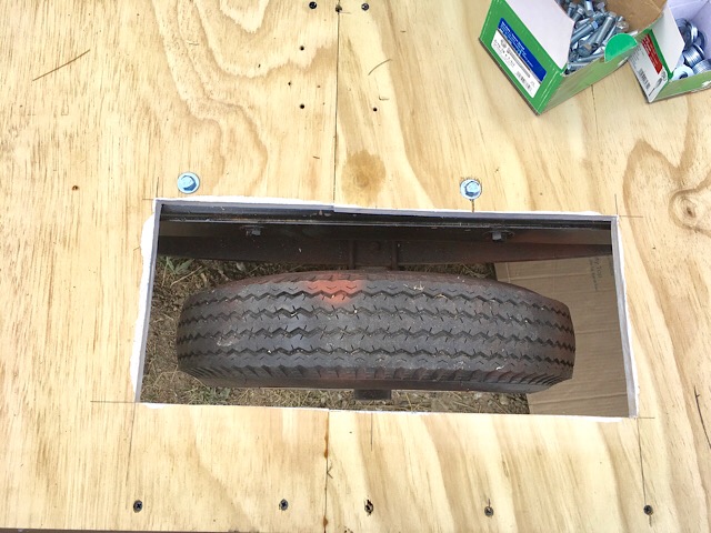

Postby NevadaBlue » Thu Oct 17, 2019 2:49 pm
I will be changing the wheels and tires to new ones and there is room to widen the space outside the tire if necessary. But, I really don’t expect to have to do that.

Postby NevadaBlue » Thu Oct 17, 2019 2:55 pm
Just for reference, here are pics from the side and top, of the tire area. I can easily make the hole 2” wider if I need to (on the outside edge), but I don’t think it will be necessary.

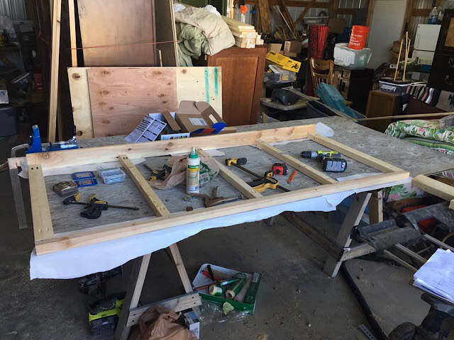

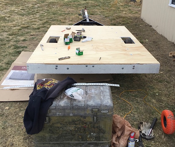

Postby NevadaBlue » Fri Oct 18, 2019 2:15 pm
:D :D :D
I made and installed the last bit of the ‘skirt’ material under the floor. This one filled the space in the hitch triangle and forms another support to hold the floor to the trailer. It is IN the frame at both ends, glued and screwed to the floor.
Then I came inside and read the instructions for the Kreg pocket hole jig. Then... I built a wall! OMG, this tool is worth the money. It is magic, plain and simple.
I decided to celebrate and just rest and read for the remainder of the day.
Here’s the wall. I did glue and screw the front wall frame and decided that is PERFECT!
I’ll put the skin on it tomorrow.
The paper under the frame is to keep the glue from sticking it to the table. The Kreg instructions don’t even call for glue. I like glue.

Postby RJ Howell » Fri Oct 18, 2019 3:29 pm
[quote="NevadaBlue"]Just for reference, here are pics from the side and top, of the tire area. I can easily make the hole 2” wider if I need to (on the outside edge), but I don’t think it will be necessary.
First interesting how you did the .jpeg and you can't re-use on response. Weird, yet probably good for bandwidth and group costs. You'll have to teach me what you did.
I do like the spacing you created 'around' the tire. Curious how you will 'cage' the top.
A 'huge' issue I see very often in other groups is tire bow-out and the damage done from not being spaced or caged. You seem to have a good space sideways, curious as to how you may protect vertically?
In my ultimate build, my wheels will be semi inbound. Yours are fully. I will run numbers to see if I could get away with a 1/8" steel cage when I get to that point. You are there and very curious what you will do.
