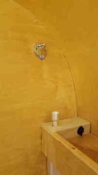

You can see on the shelf, my little enclosure for the power outlet and the flashlight. The wood for the enclosure needs to be finished and the whole assembly attached but you can see the concept. Above, because I had a little bit of time and was curious about how much trouble it was. I pushed the wires down the slot, wired up and mounted the first reading light. Pushing the wire through was tough. In the end, I cut the cable jacket off and pushed the individual conductors down the slot. I should have made the slot a little wider or deeper. I'm not sure which but I could not get both conductors in as a single 14/2 cable. Also not shown is the cabin now has a sun roof and there is a piece of blocking cut for the cabin light.

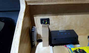

I do have a question for you Tony. Why did you place the fuse box over the headboard? I am looking at placing mine in the galley and building an electrical enclosure. This picture shows the rough plan.

Since I am planning on the primary charger being the tow vehicle and then utilize a solar panel after I reach my destination, I have purchased the Renology DC to DC controller. It will take both an alternator input and a solar input. The problem is it is a lot bigger than your solar controller. My solution is to mount it on the counter on little rails. I will mount breakers and a cabin power outlet on the bulkhead and mount my fuse box on the side wall. I will put a cover over it that would include two power outlets for the galley and the battery monitor. I'm still working with the concept to lay everything out and see how much space it takes up.
I dithered back and forth. I could have and maybe should have put it above the battery, behind waterjug. Your idea will work fine of course.
That DC to DC box is big. Could you put it under the headboard and run some heavier gauge wire to the battery?

Tony - I liked the idea of putting it in the headboard. Thinking through it though, I am leaning away from placing it in there. The instructions state that it needs to be as close to the battery as possible. I agree that increasing wire size makes that need go away. The other issue I have is access. Reaching back there to change it out would be a lot of trouble once the trailer is operable. I am also thinking about putting it above the battery under the counter. I need to select a battery and see how it all fits together. If that doesn’t work out well, it will have to go on the counter or on the wall above the counter.

There's always a quandary with this stuff. If it were me, I think I'd put it there. The distance to the battery --relatively speaking-- in the RV world is still short. And this box is one of those devices that shouldn't need access.

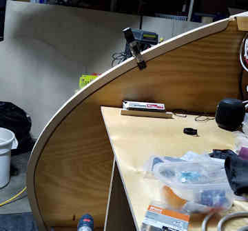

The 3 mm plywood finally arrived. So I studied up on the process for putting on the roof. Here I noticed in my second time through that the blocking and the spars need to be even. I ran outside and looked and sure enough, they weren't. My spars were a little below the blocking. These were cut at 2 inches thick which turns out wasn't quite right for how things laid out for me. I think I follow the same process when building the hatch. So, when I build that, I will cut the spars a little large, fit it up, and then trim down to final size. My jig saw skills are hopefully good enough that I don't need to custom cut every one. Anyhow, to smooth this out, I pushed the trailer out of the garage so the wind would carry away the mess, and, with my belt sander, leveled everything out. One of the things that I had been curious about is how this would look with the tow vehicle. Since it was out of the garage, I backed the jeep to it and snapped a picture. There is about 4 foot (what I believe is the length of the tongue) between the cabin and the Cherokee.

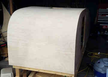

Starting at the back as recommended, the first piece went on fine. The 5 ft board extended just beyond the opening for the fan. The next day, I cut out the fan opening and clamped the second piece through the opening and on the sides. I was hoping that I would be able to clamp it down and just start stapling. No such luck. The book recommends strapping down the sheet. I would say it is more than a recommend. If you're working alone, it is a must. My ratchet straps were too short to go all the way around so I ended up placing a C-clamp on the stand and hooking the ratchet side to that. The other end was hooked to the galley counter. The three straps I had worked fine though I would have used a fourth one if I had it. For the last little bit, I cut off a 19 inch piece and measured where the staples needed to go. Pressed it place and put a staple in the center. Use a couple here. The sheet pushed around the staple and slipped. After I got it secured in the center. I ran staples out the left edge then the right.

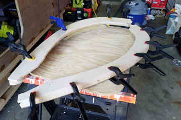

One thing I did learn about working with the baltic birch, and probably all plywood with a smooth surface, is that you need to be careful with the direction of cut. I found that when the cut approached the portion I wanted to keep, bits of wood would tear out. When the cut along the curve was away from the piece, all was fine. It may be the blades that I was using but, since they were two different styles, I think it is something that needs to be watched. The picture below represents what was accomplished the past two weeks

Looking again at this picture reminded me of something else. Up until today, all my c-clamps and spring clamps were 2 inch. The sides of the hatch, when glued up, are a little larger than two inch. If you're outfitting for this build, pass on the 2 inch clamps and buy the 3 inch. This is the only step that it has been an issue but you will need the larger clamps.
