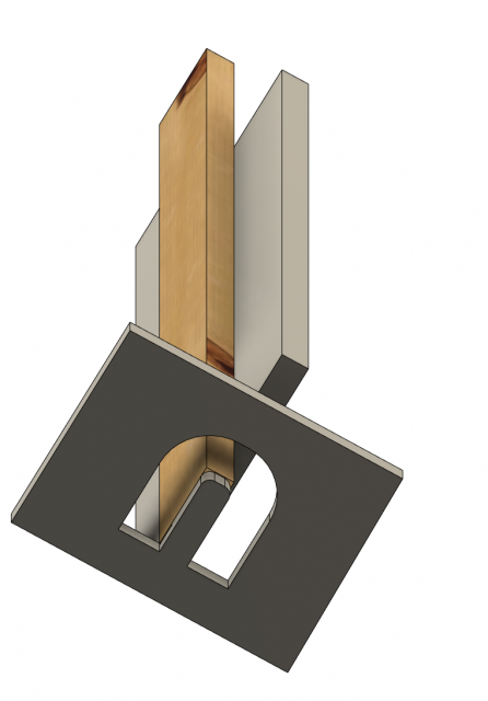

bartek wrote:To support the length of the trailer, I added a set of supports in the back and front. I'm not quite sure if it's an overkill, but I figured since the trailer overhangs 18 inches to the back, I wanted it well supported. The whole thing is screwed to the metal frame and supported from the bottom on 3 1x1 metal tubes.
I did something similar on the front side, except it's only 6 inches long and has a cut out for what's supposed to be a tongue box.
Before attaching, the 2x4s facing the metal frame and the bottom plywood was covered with Henrys's roofing patch (what a mess by the way)
This picture from the design probably best explains what I did (it only shows 2 of the 3 tubes, the third one was added in the center):
veedabowlu wrote:bartek wrote:To support the length of the trailer, I added a set of supports in the back and front. I'm not quite sure if it's an overkill, but I figured since the trailer overhangs 18 inches to the back, I wanted it well supported. The whole thing is screwed to the metal frame and supported from the bottom on 3 1x1 metal tubes.
I am also planning to widen and extend the NT 5 X 8 trailer... I can see what you did for the front and rear... did you do something similar to widen it on the sides of the frame?... If so, can you show some pictures of it?
