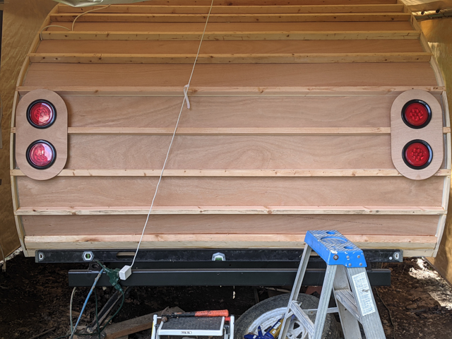

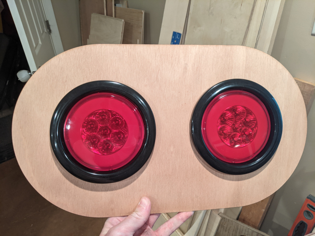

I cut these template on the laser for the taillights. I really like these taillights, they have a halo for the running lights and the center for braking.
I originally planned to have them horizontal, but I think they look better vertical.

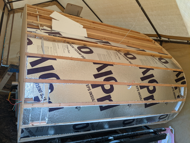

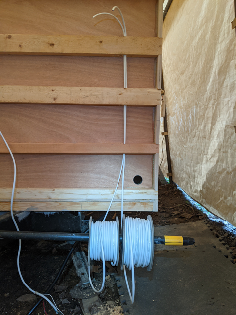

I'm so bad at keep this build thread updated. I've finished the wiring and insulation over the past few weeks.
My DIY wire spooler thingy... worked great!

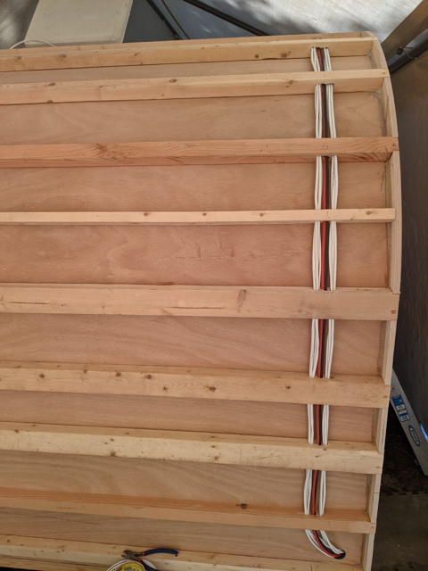

Look how clean this wiring looks!

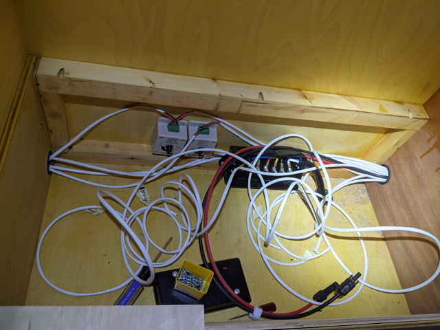

Don't look in here. Don't worry, I labeled MOST of the wires...

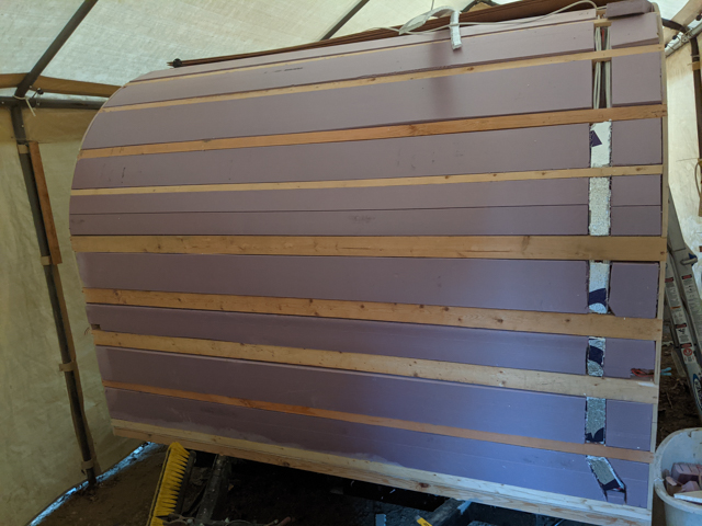

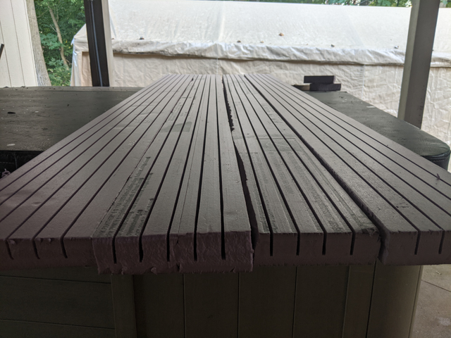

So much kerf
I managed to cram 1/2 insulation on each side of the wiring.
For the rear I went with 3 layers of 1/2 more flexible insulation. The pink ridged stuff is a PITA to work with.

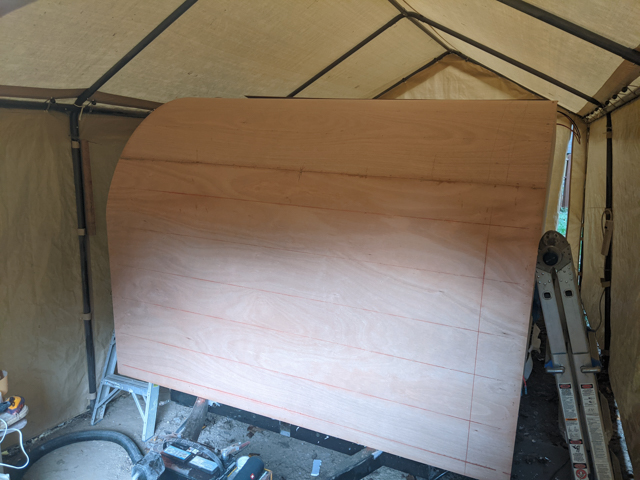

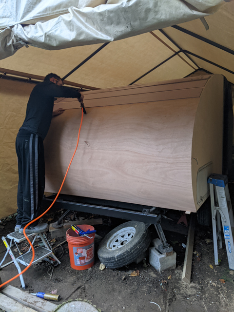

In the past week I've only had time to install 3/5 of the outer skin panels. The top is going to be a real challenge because there isn't much room in the tent above the camper.
Front two panels:
Rear:

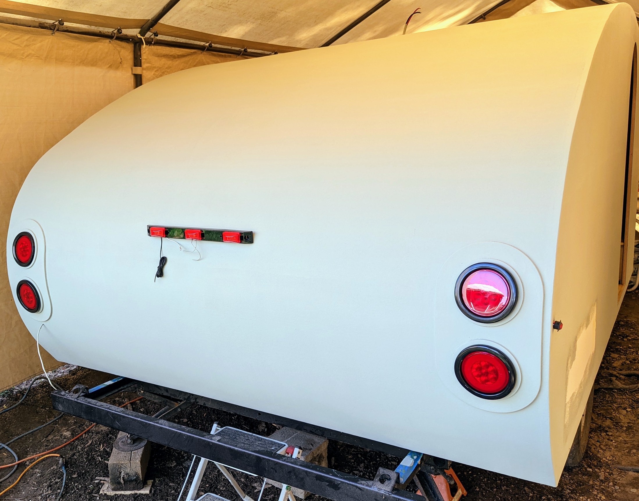

I know it's been awhile since I last posted, but I've made lots of progress. Rear end, lights are not installed, just wanted to see what it looks like.

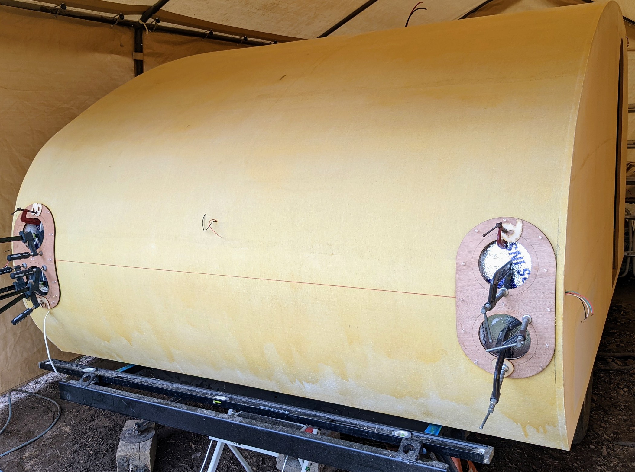

Postby crxtech » Mon Apr 18, 2022 6:47 pm
Gluing up the tail lights housing.

Postby MickinOz » Tue Apr 19, 2022 3:23 am
crxtech wrote:just wanted to see what it looks like.[/attachment]
Looks like a bought one.
(That's Australian for "looks bloody good, mate".)
