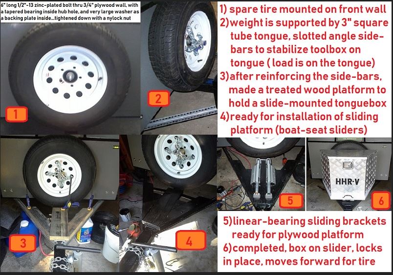

DrewsBrews wrote:I... Then I thought of the tongue box and the gap between the box and the cabin. If I back the box with plywood I could tuck the spare tire behind it and send the bolts into the tongue box to hold it. The tire would droop down a bit but shouldn't do so more than the tongue jack.
Though that would concentrate more weight on the tongue too.
I thought the same place was a good spot for my spare, mainly for the weight forward I needed (sidewall mounting was also considered, but the weight would still be too far rearward), plus I knew there wasn't enough ground clearance for the underside placement of the spare (especially if I was to go off-road), so I used the front wall as my spot.
Since the front wall is 3/4" plywood (as is the entire trailer), I used a 1/2"-13x6" long zinc carriage bolt (with large washers on each side to spread the load) secured with a nylock nut (with security chains under the outside washer & nut) as the anchoring point; I centered it inside the spare, using a tapered bearing I had in my parts bin, and used another large washer and nylock nut to cinch it down. The weight of the wheel/tire is entirely supported by the 3" square-tube tongue (the bolt thru the wall just holds it fast there). As added security, I put my tongue box on a sliding platform, which locks in place, hiding the locked & chained spare.
front mounted spare behind sliding tongue box.JPG (127.81 KiB) Viewed 2194 times
