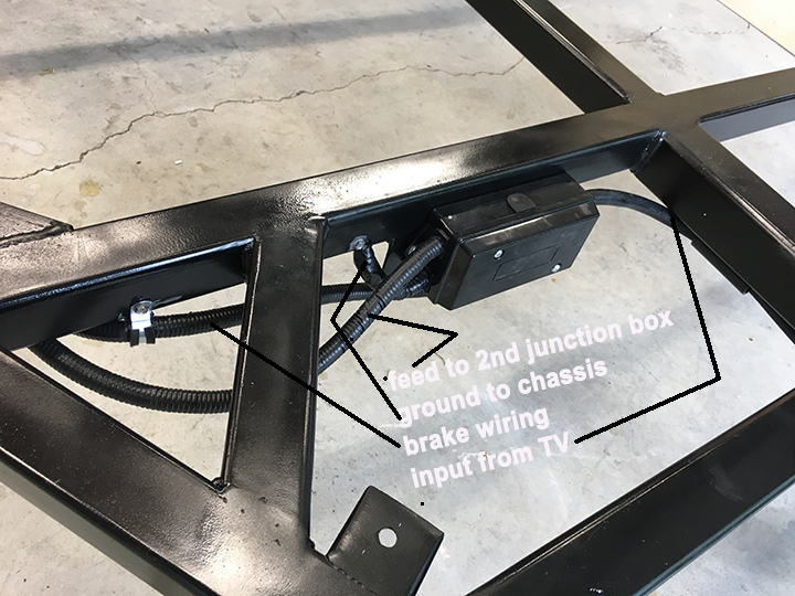

June 22, 2021

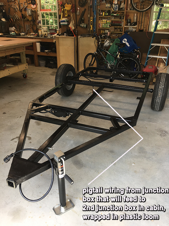

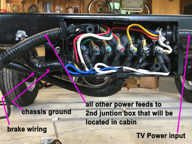

Finished setting up the preliminary wiring. Wired up the brakes. Again a big thank you for the suggestion to do all this prelim wiring prior to installing floor decking.
Which lead me to the idea of installing a 2nd junction box located in the cabin. Rather than having to solder or connect each light fixture's wiring to the pigtail wires, I will run the pigtail with all the wiring up to this box to supply power to all lighting supplied by TV (turn signals, brakes, marker lights, etc.). This way each light can have its own ground wiring and I think it will make trouble shooting a bit easier.... should there be a need to trouble shoot bad contacts :roll:
Also thought it best to keep the brake wiring in it's own loom and separate to aid in any trouble shooting.
Side note... I have to read it over again but not sure I understand the lighting suggested in previous post. I'm assuming this is an exterior light to illuminate if you and your trailer are parked in a temporary overnight spot....so your trailer can be seen by other motorists....

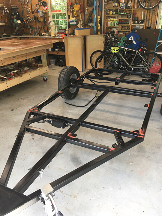

-Yesterday routed notches in the floor assembly where the 2 side walls will have corresponding notches to interlock with one another when assembled.

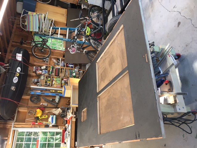

-I didn't want to grind the weld beads flush with the frame. Instead used red powder to transfer the high spots of the welds to the underside of the floor assembly
and ground away material from floor so it would sit flush on the frame.
- I had spent a lot of time trying to decide what undercoating to use. Finally settled on this rubberized asphalt product from Black Jack, Rubr-Seal. The stuff is really thick in the can, I mean really thick.
Certainly not a "paintable" material. Applied 2 layers using a scraper to kind of trowel in on. Applied first layer really thin. It set up pretty quickly.... and by end of day was able to apply a second coat a bit thicker.
Today hope to get the floor decking installed.

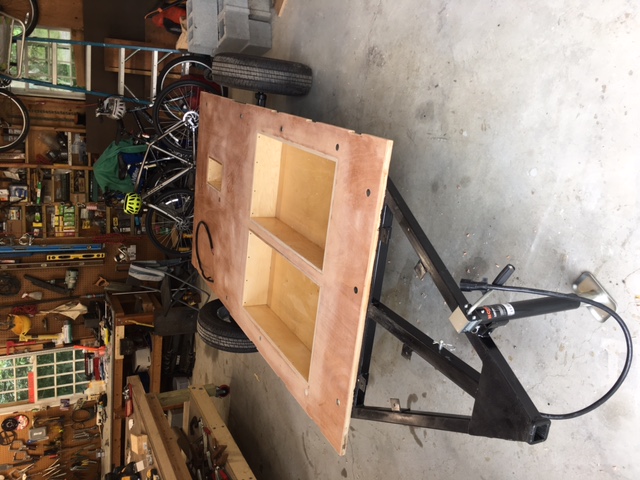

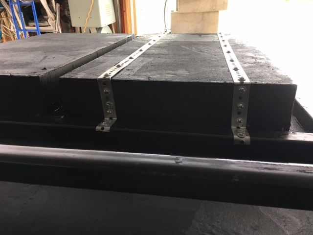

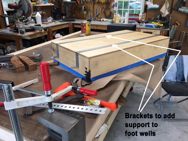

Got the floor deck installed along with the 2 footwells and the battery box. Went with elevator bolts.
Ran all wiring from junction box (from TV) up through floor in loom covering. Once walls are installed, will run that wiring up to a 2nd junction box.
Did I say "thank you" for the suggestion to set up the junction box wiring BEFORE installing the floor decking??? Anyway... I'll say it again! :D
Applied the asphalt concoction to the footwells and batt box.
Made up some metal straps to add some further support to the footwells and battery box. Will spray the strapping and fasteners with zinc primer and paint black.

Postby tony.latham » Sun Jun 27, 2021 6:46 pm
Made up some metal straps to add ...
That looks like nuclear-military-grade pipe tape. What is it?
Re: CapeBuild Build Journal
Postby Capebuild » Mon Jun 28, 2021 4:09 am
The brackets are made from these metal strips I found in the hardware store.
They're 6 feet long, about .070 thick and about 1.5" wide.... with a series of holes punched through along their length.
John

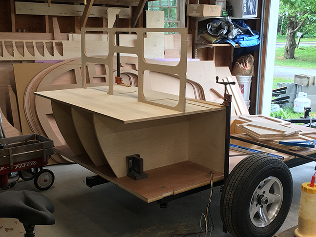

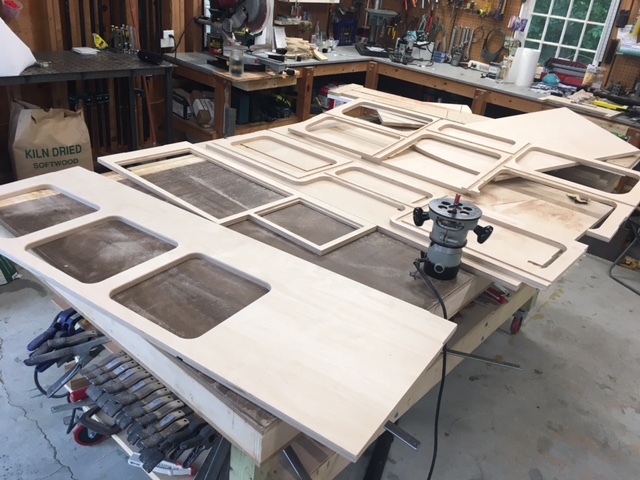

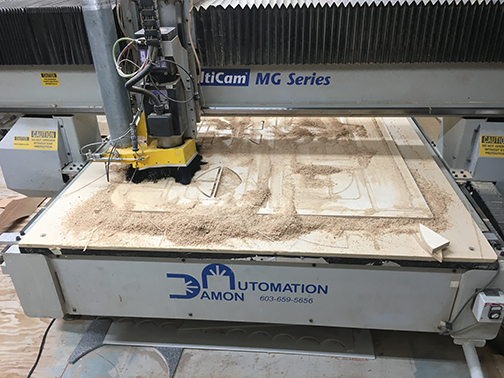

Today, picked up the plywood (baltic birch, okoume and MDO) from the CNC vendor (luckily, next town over). He did a great job. His CNC set up was really cool.
He can do a 5X12 foot panel. My largest was 5X10. Still need to get the doors cut along with the hatch spars.... but for now I've got plenty to assembly. Concentrating
on the headboard / galley cabinetry, all cut from Baltic Birch.
This will save so much time and the whole thing worked out great. Some photos attached. Will post more in a few days.

Yes... the process was really great to see. Now that I'm starting to assemble parts I'm wishing I had just planned to CNC every piece of wood. I believe that's what several of the
teardrop companies do. Once you've got the files, you can just pump out as many parts as needed.

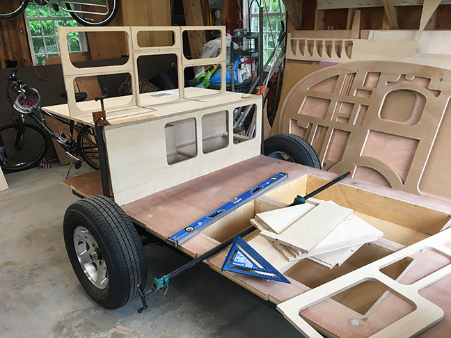

Anyway... moving forward. Starting to dry fit the pieces. The dados were only machine CNC'd on one side, so I need to router the rest in where needed.
Starting to accumulate lots of small pieces of wood cut offs.
John

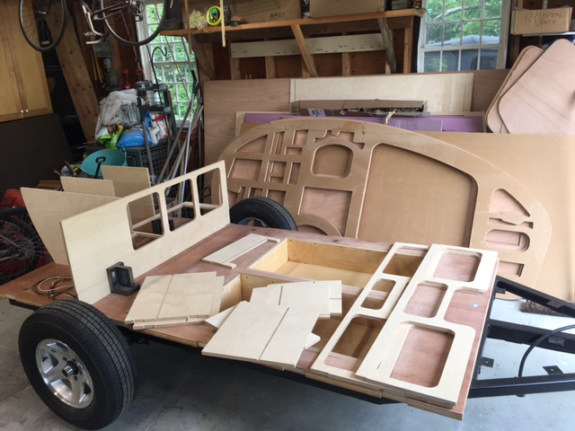

Postby Capebuild » Sun Jul 11, 2021 4:44 am
July 11, 2021
Yesterday hooked up the trailer to the Outback and took it out on the road to test 1) that it tracked properly and 2) to make sure the brake controller and axle brakes worked and to set the controller.
With my wife driving behind me with emergency flashers on..... I drove to a local recreation area early in the morning. My wife had her phone on speaker phone, as did I, so we could communicate
with one another. It towed very well.... I couldn't really even tell I was towing anything. Of course this was only the trailer chassis being towed minus the rest of the build. And the brakes worked.
I set the controller up but then realized it didn't really matter what I set it to since factors will change once all gets built, and the cabin installed, making for a big change in weight. But glad I took
the chassis for a test spin to make sure all was good.

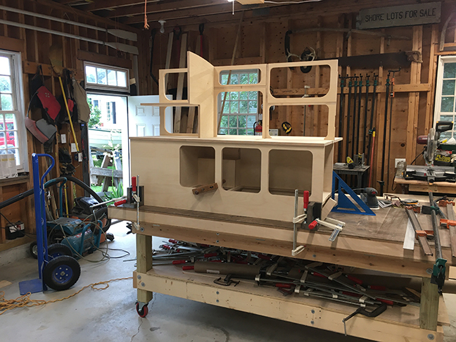

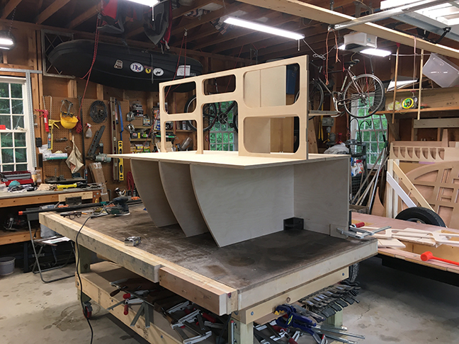

Decided to build the lower portion of the headboard/galley section on the torsion table for a couple of reasons, one of which is that my torsion table is "more flat" than the floor decking. Will then lower the unit onto the floor decking and install in place. Just dry fitting and sanding pieces shown here prior to gluing up.
John
