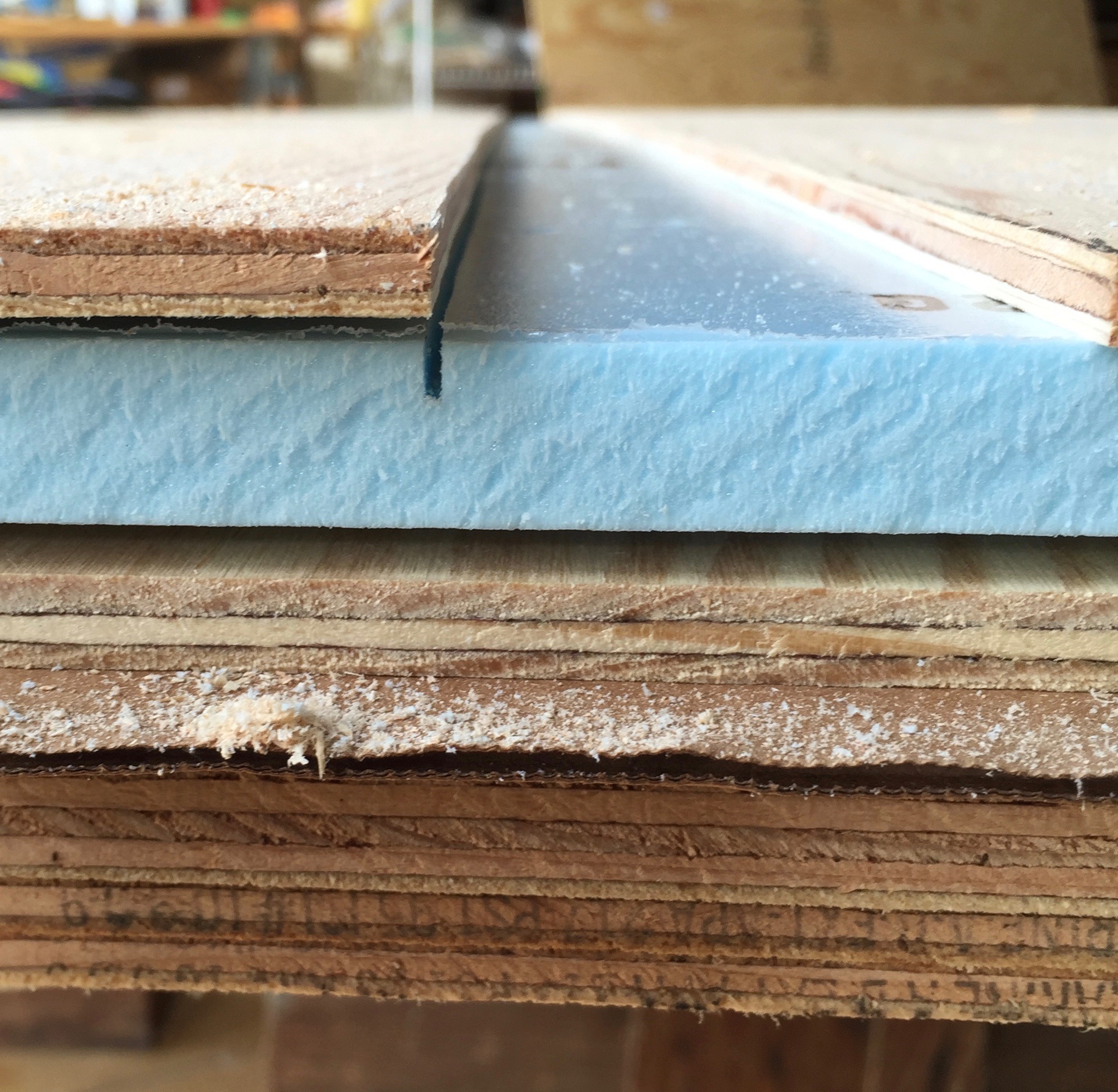

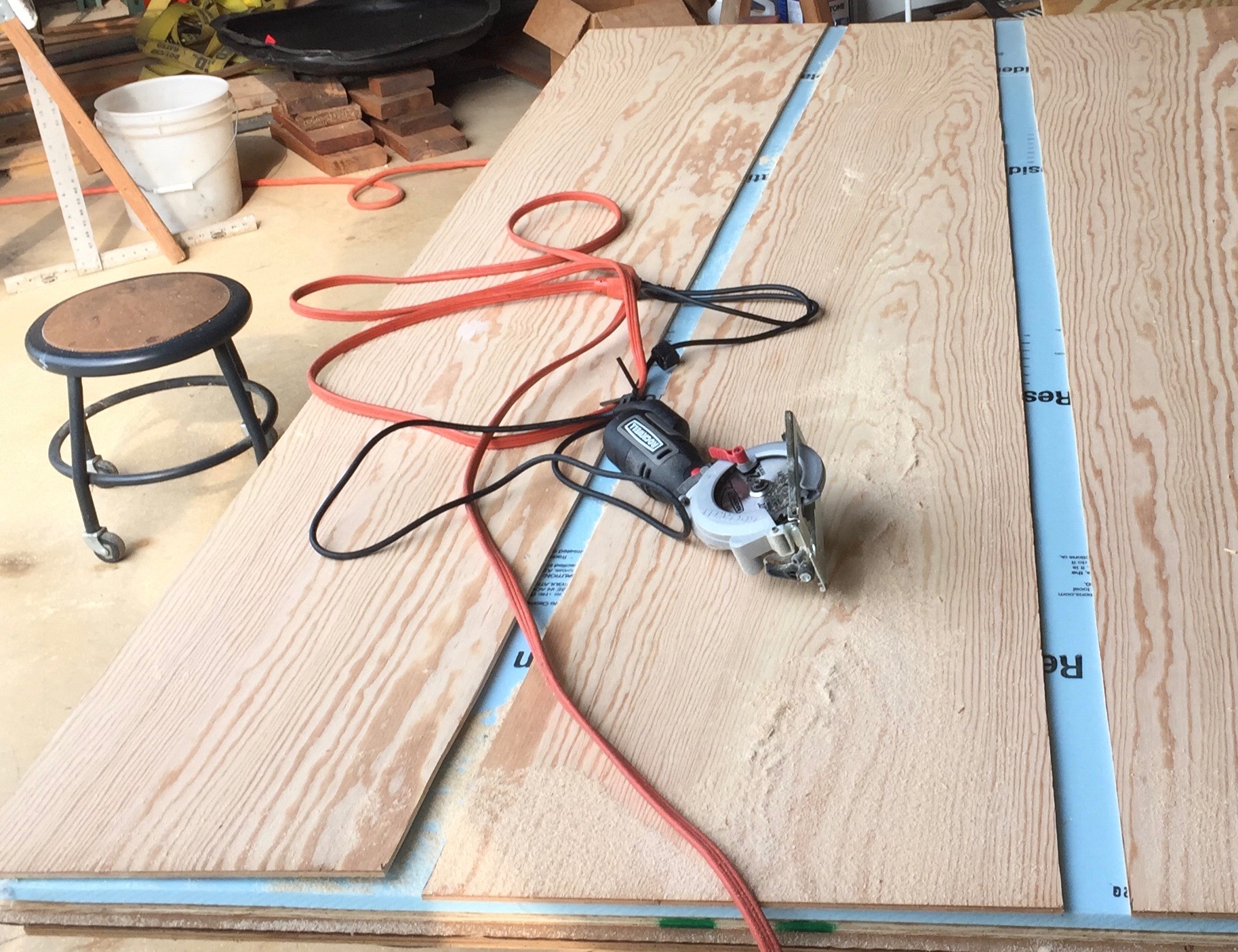

for cutting boat panels from plywood i set up a knee high pair of saw horses w/ a short stack of pywood on them
just enuff plywood to keep the surface flat n level
on top ot the plywood i lay a 3/4" thick sheet of open cell insuation foam
lay the plywood flat on the foam and set the bade depth on your circular saw/skill saw to just go thru the plywood by one saw tooth's depth
set that shallow you can cut curves easier than with a jig saw and end up with a much fairer shape with a lot less fretting and sweating
IMG_1167 2 2.jpg (986.8 KiB) Viewed 883 times
IMG_1165 2.jpg (765.59 KiB) Viewed 883 times
the height allows you to kneel on the wood to hold it and your fingers aren't exposed to the whirring blade
just another way to skin a cat

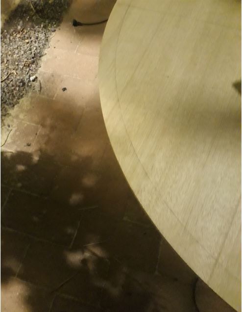

I reckon I have the curves nailed. I have made up a compass that attaches to the router.
The pivot point is screwed to the main panel. On this build I managed to locate the screw holes so they are covered by the joinery inside the cabin.
I mark the curve with a pencil or nail, rough cut just outside the line with the jigsaw, then come back and machine it with the router attached to the compass.
Works very well. Only have to do each curve once. Subsequent pieces are cut using the first as a template.
Even worked on the Generic Benroy rear curve which is two radii.
Routered curve.JPG (37.67 KiB) Viewed 865 times

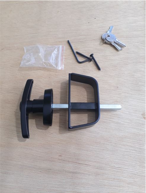

Received my door latches from the the good 'ol US of A.
The vagaries of global commerce mean I bought door latches made in China from the US that were delivered by Australia Post.
Happy with them. Installation looks very simple, after all I have installed a very similar item on the door of my motorcycle shed.
(Every Aussie country boy has a toy shed.)
door latch.JPG (58.08 KiB) Viewed 840 times

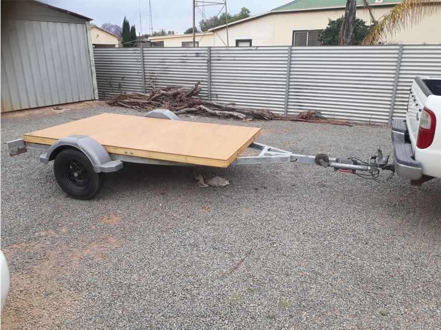

Last but not least I cut about 22 inches off the drawbar of the trailer.
It had a kink in it. I didn't see it when I bought it, as it was hidden by the winch post.
I suspect that the trailer was jackknifed while reversing.
So I cut off the bent bit, relocated the jockey wheel and drilled some new holes to bolt the hitch back on.
This leaves me with 55 inches or 1400mm from the front wall of the TD to the centre of the towball.
So slightly more than half the length of the body of the TD. Should be OK.
Would need to be at 90 degrees to the truck for anything to hit.
I think it still looks OK.
Shortened trailer.JPG (167.89 KiB) Viewed 840 times

Postby swoody126 » Tue Nov 09, 2021 8:17 am
make sure that tongue jack is mounted far enuff back so you can open the tailgate of your pick up without them making violent love w/ each other
