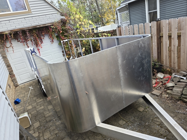

My rivet application is...non-standard.
I'm not sealing the rivets with anything because any water that gets through them is now inside the 1.5x1.5 square tube i framed the walls with, but not inside the cabin of the trailer itself.
I have holes drilled into the bottom of each wall stud so that any errant drops of water that get in through the rivets will drain out by gravity.
Just to be extra safe, I may paint the walls with the same clear sealant I used on the frame.
:thinking:
The lap joints between the aluminum wall sheets, however, are sealed with silicone before riveting.

Re: All aluminum hard sided popup toy hauler
Postby coal_burner » Wed Nov 13, 2024 10:35 pm
I measured the height of both my motorcycles, and even the goldwing stands less than 4ft tall once I remove its windshield (a 10 minute job).
...so I made my side walls just barely high enough to fit that with the ceiling lowered in to travel-mode.
When the roof is popped up in to camp-mode, my ceiling should be just under 7 ft tall.

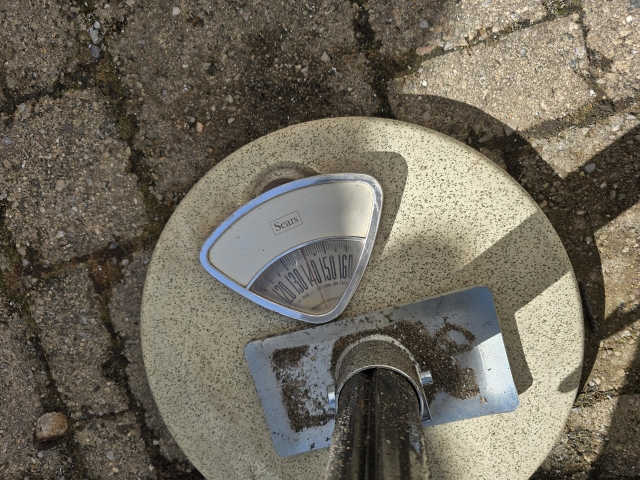

Out of curiosity, I wanted to know my current weight.
Using an old bathroom scale inherited from my grandmother, I weighed the tongue and each wheel separately.
300 pounds on each tire and 145 pounds on the tongue jack gives me 645 pound trailer weight

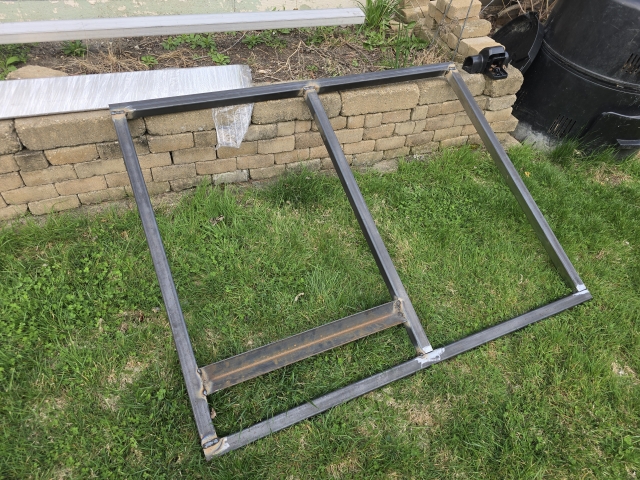

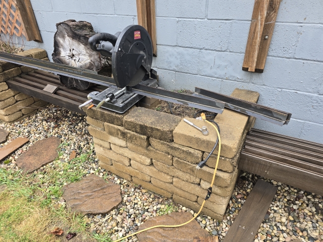

Worked between the raindrops Sunday to cut most of the steel for the rear motorcycle loading ramp.
I figure the bike tires will roll up the 1.5x1.5x1/8 square steel tube in the middle, while my feet can maintain traction on the 2x2x1/8 angle iron cross members.

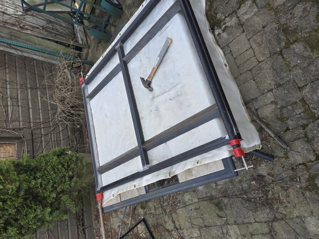

Easter Sunday, and what do I do? Weld a ramp.
I cleaned up the metal with an angle grinder, and laid the pieces out on one of my welding blankets on the picnic table.
Used diagonal measurement to square it up, and held it tight using a couple pipe clamps.
After welding I leand it up against a planter so I could jump on it a bit and make sure the welds were as solid as they looked.

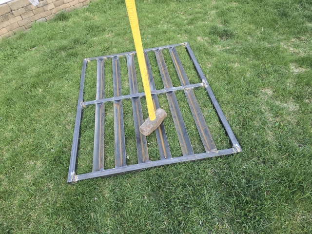

Postby coal_burner » Thu Apr 24, 2025 6:41 am
...and there we are, one completed ramp panel.
Welds were tested by dropping the 20 pound sledge hammer repeatedly over every one, then checking for cracks.
