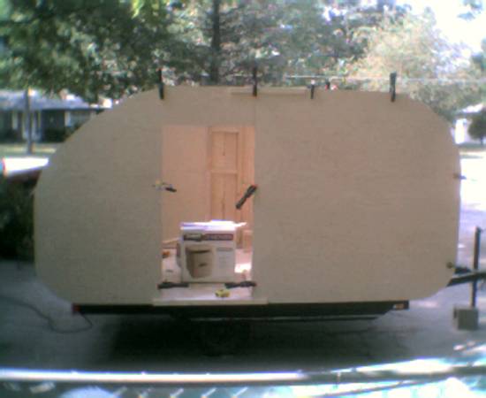

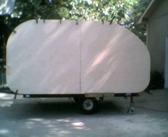

Yee Hah! The dry fit went well. This is the curb side with the door. The door has a tinted window.
This is the road side without the window in. I wish I had cut the hole so I could set the window in too. :(
And from the front. The junk is so we could make sure the bed and potty fit. :D
Sooooo, what do ya think. I am totally amazed I can build this thing with help from here and some lifting. :) :) :)

Postby apratt » Sat Aug 05, 2006 11:50 am
Hey it starting to look like something. It a Box.....No it is a Teardrop!!!! :lol: :lol: :lol: :lol: looking good. :thumbsup:

Postby Sonetpro » Sat Aug 05, 2006 12:00 pm
Aunti M
My,My, That pile of wood is starting to take shape. It sure is starting to look like a teardrop. Great progress.

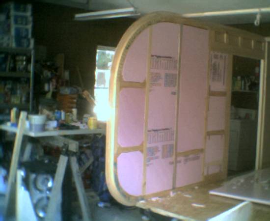

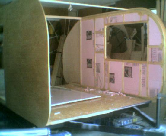

Postby Miriam C. » Wed Aug 30, 2006 1:43 pm
I have pink stuff. I finished the insulation yesterday. Should have put the ceiling and roof on but the wood isn't in. Seems they ordered 1/4 instead of 1/8. :x
Someday :worship:
Street side with the window cut out and the stain on.
Curb side
Postby thobbs » Wed Aug 30, 2006 3:45 pm
You're cruisin now. It looks great! :applause:
