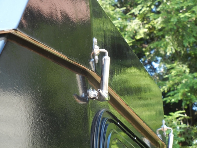

Roof back edge formed and enforced with two layers of fiberglass. By Atomic advice I used 3M 77 spray adhesive (a very light mist) to hold the first layer glass and laminated these edges. After that I had to fill and fair again with micro balloons filler. Second layer I did not use 3M 77, just brushed thin epoxy and waited several hours until it started to cure and when it was still tacky the second glass layer was attached and left to cure completely before filling the weave next day. Both methods worked.
156071156072156069156068
Installed 4 spring latches total to hold down the roof. For the front, two anchors were installed in the wall.
