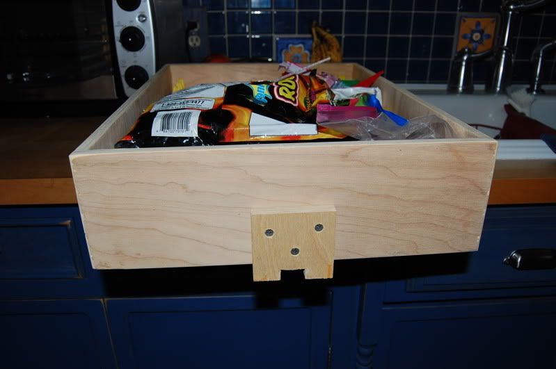

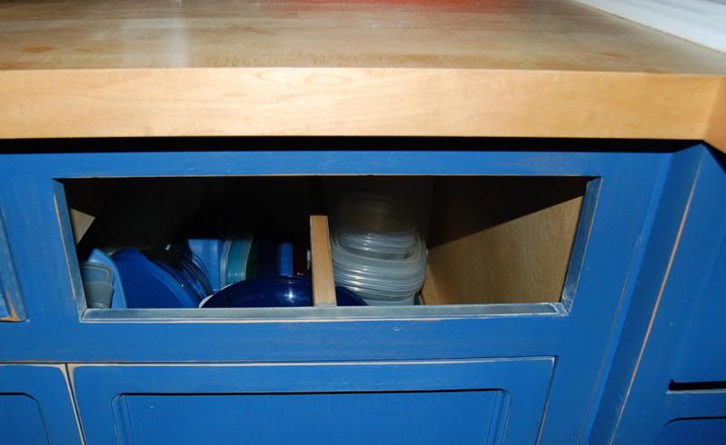

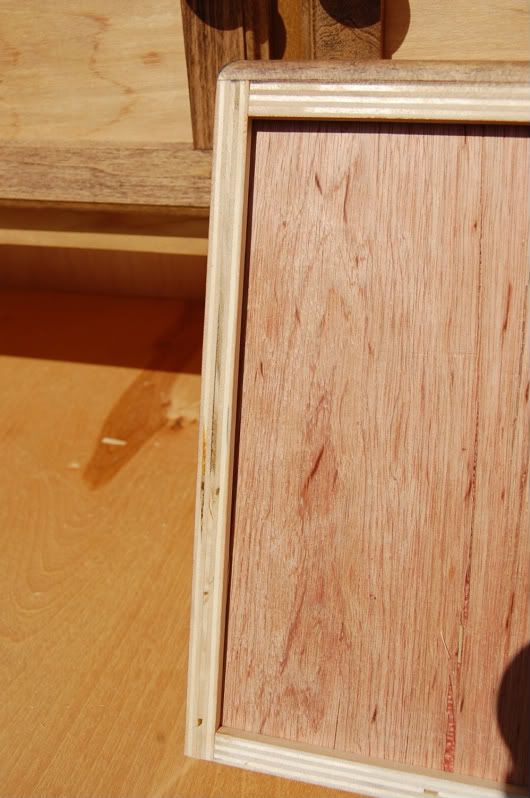

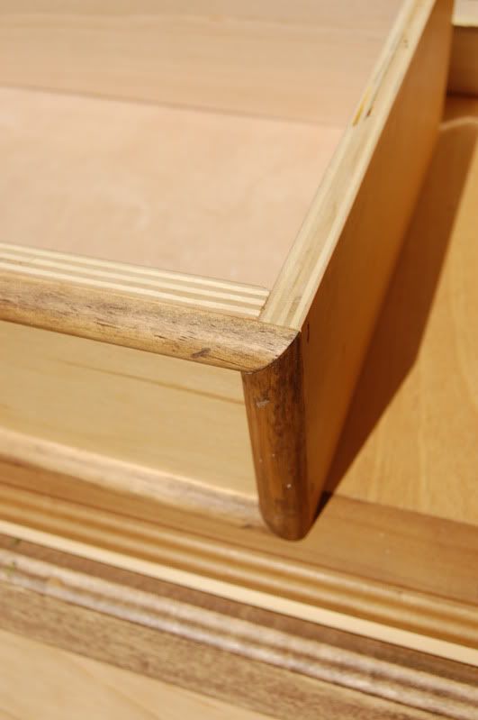

and as promised, i took some pics of drawers i've built:
i like building drawers out of 1/2 ply because it's stable and will not warp over time. i build a simple box, glued and brad nailed, with a dado cut about 1/4" from the lower edge to hold the drawer bottom. i then trim the front to give it some style.
bottom:
for drawer runners i can usually get by using scraps. for the TD i used 1/4" ply, glued to a 1x3, which is glued square to the face frame and counter top. i waxed the edges so the drawer can glide smoothly.
a few years ago i built cabinets for my home's kitchen. i did the drawer runners a little different here. i used a single drawer support along the center.
then on the rear of the drawer i attached a guide that i cut out of 1/2" ply. please excuse the messy candy drawer.
so, that's it. i like keeping things simple. :)
