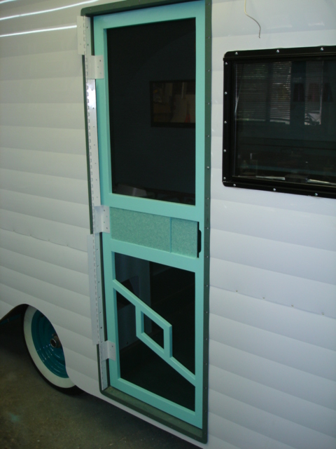

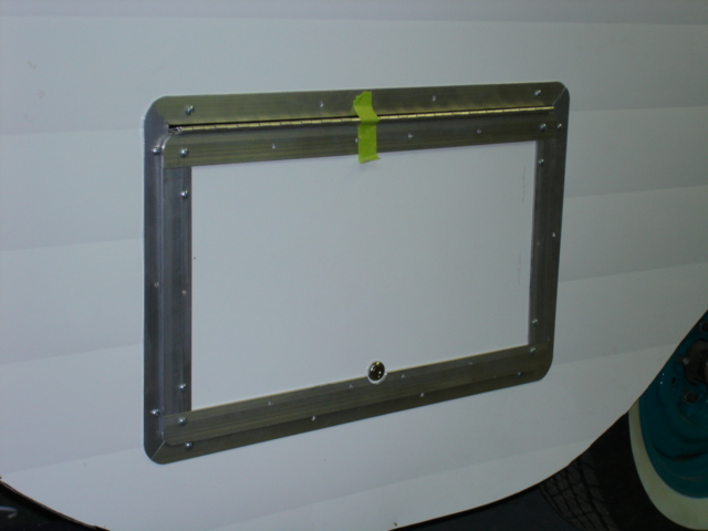

I ripped up some aluminum angle and made the door fame for the storage compartment and door. The hinge isn't what's going in, I only used it for a spacer...too short. It also gets an "eyebrow" over it and all the aluminum will be painted white.

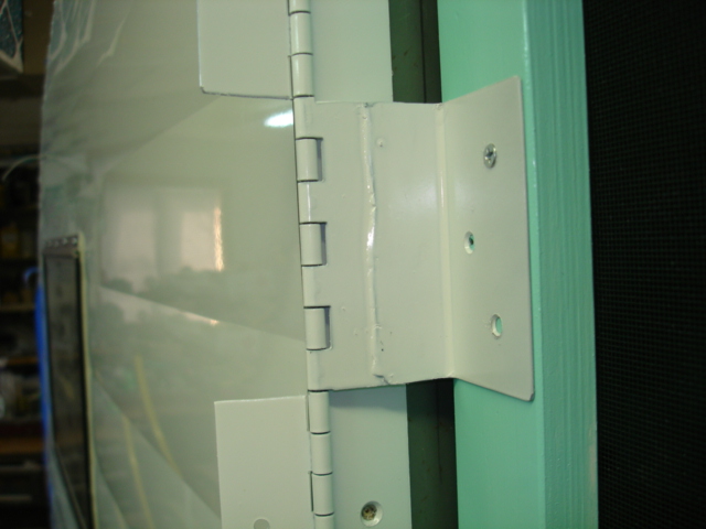

Welded up the tabs on the door hinge to accept the screen door. I looked all over to find an RV door hinge...they only sell them with a door attached...like 3-400$ new, 120$ or so used. I must have had that door together and apart 6 times to get the outer door to mate with the screen and all of it to fit in the hole. I'm going to have to do something to take care of the worn latch on the door. It latches a bit too well, and is difficult to make operate, has a groove worn in it that hangs up. It did feel good to hear it "click" and latch shut however.
I also got the screen door painted and screened.

Sunday update...not much to report, sorry. I know, I know...is he still clowning around with the door?...YUP...It took a bit longer to get both the doors to mate up so that they operate cleanly and will latch. It's tight right now, but once the weather stripping compresses a bit, should be fine, has a good solid click when it latches.
