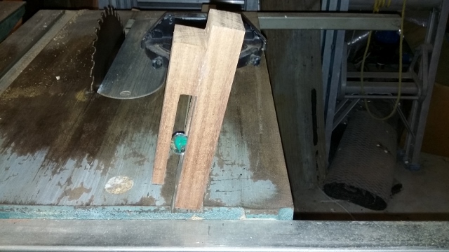

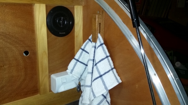

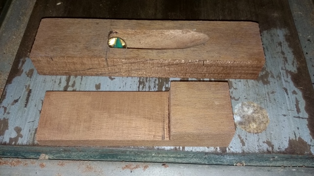

Working on the last drawer & a "magic marble towel holder" for the galley. We've missed having a place for a skillet & sauce pan, so the drawer will be a good addition. We kept them in a tote in the truck, but it wasn't too convenient for cooking. Took a while to figure it out & had to change the design a little on the fly today, but it should work now. The space is limited, but the design should keep things in place while on the road. Next post should give you a better idea about how it installs & works. Using a bottom-mount full extension guide to locate the drawer.
Towel holder
160302
Drawer & holder stained
160303

Postby noseoil » Thu Apr 06, 2017 6:44 pm
Drawer
160304
160305
Towel holder
160306

Hi Tim, nice to see those little finishing touches.
Snap on the towel holder, they work well. :thumbsup:

Thanks Frank. I originally "stole" the idea from you & your build, but it took this long to actually make it and add a towel!

So is the towel clip as simple as it looks, or is there some sort of gizmo hidden in the box that pinches the hem of the towel?
Like, maybe, a marble?

Ding, ding, ding, a winner! Yep, just a marble & gravity. Drill a hole on an angle in a block of wood, so the side protrudes out of the block, then a spacer & another side piece hold the towel in place.
