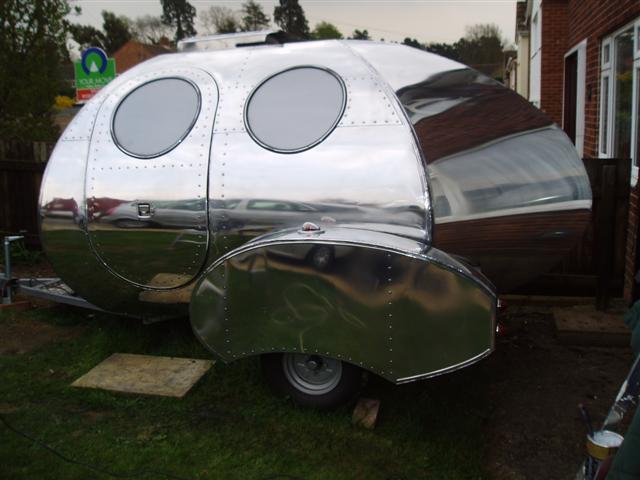

with the polishing, i smear a little compound on the mop,
then rub the mop on the area to be polished,
then start the machine & polish away.
(not too much rpm or pressure)
the sponge mops tend to fall apart & are really ment for finishing off
so i just used the lambswool mop.
Rigsby's tip of doing the last bit by hand works great.
have a feeling the windows will be popping out for this.
has anyone sucsessfully lackered polished ali with it lasting more than
a couple of years ?
(dont want to be doing this too often if i can avoid it)
best rgds dan. :thumbsup:

dandan wrote:...has anyone sucsessfully lackered polished ali with it lasting more than a couple of years ?
Unfortunately the short answer is no.
Pop over to the airstream forum
http://www.airforums.com/forums/f441/ or
http://www.airforums.com/forums/f474/
for indepth info about this topic.
You can lengthen the life of your polished shine by washing and waxing every 30 days or so. More often if you are near saltwater. Automotive clearcoat won't stick to the polished aluminum surface. You can buy the finish used on the new airstreams (Plasticoat) directly from a dealer - it's a two part mixture, but I believe it's "lifespan" is only about 5-6 years on a properly prepared surface.
Your trailer looks awesome by the way! :D

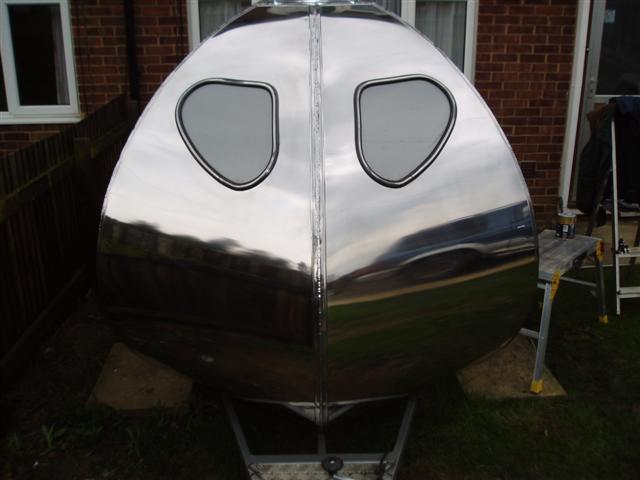

Postby dandan » Mon Apr 19, 2010 12:06 pm
Thanks Grizz. :thumbsup:
7 (yes 7) hours on the polishing mop today.
would have been 8 but it started to rain !
still got the other side to do.
arms are like jelly.
back on it tomorrow.
Best rgds dan. :thumbsup:

Postby jackdaw » Mon Apr 19, 2010 12:29 pm
:) :shock: :shock: :shock: oh yes indeed. That looks the dogs bollox fella :applause: :applause: :applause: :applause: Well worth the effort Dan, 8) 8)

Postby starleen2 » Mon Apr 19, 2010 4:54 pm
GEEZZUS :shock: what a shine!

Postby Cliffmeister2000 » Mon Apr 19, 2010 4:59 pm
Dan, it's unbelieveably awesome! How about some interior shots? :applause:
