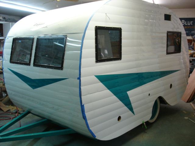

Postby doug hodder » Sat May 08, 2010 6:48 pm
It's peeled! Still curing, and I've got a fire going in the shop to speed it up. It will really pop when I get the black pinstriping surrounding the graphics on it. I can't do that till at minimum late tomorrow. I also have to wait till it cures, then finish up the door jamb. It needs it's 2nd color white since the wedge cuts across the door. Doug

Postby 2bits » Sat May 08, 2010 6:50 pm
Can I be the first to say that it is awesome watching a plan come together so awesomely!

Postby bdosborn » Sat May 08, 2010 8:11 pm
Very cool. I wish I had your eye for color and shape. You definitely have a nack for design.

Postby dguff » Sat May 08, 2010 8:11 pm
Hey Doug,
Great job, really captures the era for that trailer style. Only one problem so far, I overheard that some people think your side graphics are upside down!! :lol: :lol: :lol: Maybe someone will be able to compile a list of corrections for you to make after it is finished.

Postby doug hodder » Sat May 08, 2010 8:41 pm
Jerome...I gotta pretty good hunch that someone will...maybe since the paint isn't fully cured...I'll go out and wipe it all off with lacquer thinner and re-tape and spray it right side up. :thinking: Doug

Postby rainjer » Sat May 08, 2010 8:56 pm
Looks great Doug. What did you do on the back?

Postby doug hodder » Sat May 08, 2010 9:03 pm
Same thing as on the front, but not quite as deep...wanted to cut the "mouth" appearance of it. Doug
Postby starleen2 » Sat May 08, 2010 10:21 pm
THAT has got to be the WORST paint scheme I've ever. . . .
OK, Doug, just busting ya' for a minute. That is really fantastic work you got going on :thumbsup:
What did you mean by
"needs it's 2nd color white since the wedge cuts across the door."

Postby doug hodder » Sat May 08, 2010 10:44 pm
Starleen2 If you look at the door jamb and the exterior frame on the door, still in primer...they need to be painted out because the teal cuts across it and I shot the teal first. It had to all be installed and in place to make the lines match up. If I painted the white first, since it's not the same type product, the "hotter" urethane would have lifted it in any areas that overlapped. You can lap an oil based enamel over a urethane but not vice versa. Others may have, not be though. It's a cost thing now....not going to buy the high dollar paint for the jamb and I'm out of urethane white.
I still have to remove the door jamb and seal it with butyl tape. I was concerned that the solvents in the urethane would cause it to want to get too soft if I sprayed it with the butyl in place. Doug

Postby cuyeda » Sat May 08, 2010 11:02 pm
Wow! Lookin' good! The front of the trailer looks like it is smiling! :lol: Just like many people smiling when they look at your progress photos. With any luck (on my side) maybe we will both have different trailers at IRG. :thumbsup:
