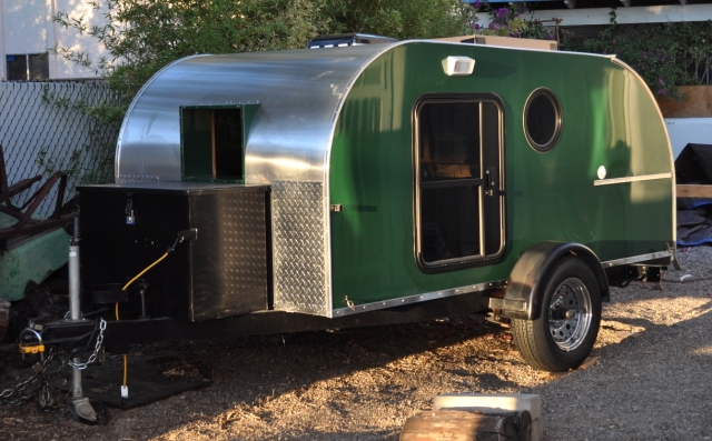

Update after a while away. We now have 13,000 miles of towing & I finally weighed this thing at a friend's business scale. Thinking I should call her "Miss Piggy" at this point, since it's tipping the scales at 1660# empty!
I decided to get a better axle setup with a 3500# rating, springs & 10" drum brakes. I called around & had a friend suggest his place up in Phoenix. For anyone in that area, Deer Valley Trailer is very good. Ask for Dan & let him figure the job for you. The new axle, springs, brakes, break-away switch, welding & installation was $600 out the door. It's a great place to do business with & I can't recommend them enough.
Here's the old setup with 2000# axle & springs, just a bit over an inch of movement from axle to frame, which was cutting things pretty close.
Image[/url]
Here's the new setup in place. Still need to install the brake controller, but that's about it.
Image[/url]

Postby noseoil » Sat Apr 07, 2018 2:15 pm
OK, the system is installed & working now! Had to run an extra wire from the back area (behind the TV set) up to the tongue box to get a proper signal for the brake controller. The wiring was set up for the 3rd brake light & it seemed better than using a circuit with a turn signal attached to it. PITA, but it's done now. I pull the fuse from the hot line when it's parked (it's using the trailer battery & wiring, not the truck system) then just put the fuse back in when it's ready to tow again. The solar panel keeps everything supplied with power, so it's all good. I did have to flip the hitch over & set the ball at a different height, but it was a simple change to make. We're towing about 2 1/2" higher now with the extra clearance at the axle, but it's better & I don't cringe when I see some of the potholes & bumps we have to drive around & over on our journeys.
What a difference it makes to have brakes on the trailer, it's much better with the extra stopping power! Did a small amount of adjusting at the controller to set it up, but it seems to be working properly now. It always felt like a big hand was pushing on the the back of the truck without the trailer brakes, but now it feels more like a passenger car when stopping. 100% improvement over what it was in comfort & peace of mind. Anyone thinking about doing this would be well served to have the extra stopping power, especially in mountains & city traffic (Phoenix comes to mind, it's chaos towing through there).
Also, a shout out to "Sheddie" for mentioning his setup for the brake controller. He has more than one vehicle he uses for towing, depending on where he's going & what he needs to do. I asked him about having to set up multiple vehicles with brake controllers, but his answer was simple, just put it in the trailer then it doesn't matter. It was so simple I would probably have missed it completely.
Here's where the 3rd brake light circuit is located. It's the module with the red wire at the top-left & now splits for the 3rd brake light (green wire) & the signal for the brake controller (pink wire).
153789
Here's the tongue box, with a board to mount the controller & the wiring going into the 7 pin harness box. I did a soldered splice inside the box for the signal wire to the controller. Everything gets solder & heat shrink tubing, then it's good.
153790
Looking forward to the next trip & a few hills to sort things out a bit & see how it works.

Back from our weekend trip to Lake Patagonia in southern Arizona & it was the first time I was actually able to use the brakes on hills & stops, other than in town a bit. Really enjoying the way it feels now & glad I went with the 10" package & not the smaller 7" shoes. These are probably larger than needed for the load we have, but they really do the job. 12" brakes wouldn't have fit inside the 13" rims we run for tires at this point & 7" brakes actually cost more than the more common 10" size.
Here are a few shots from this weekend's trip
153873
153875
153874
153876
