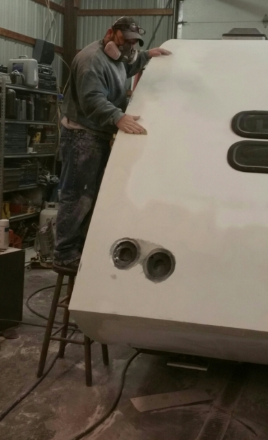

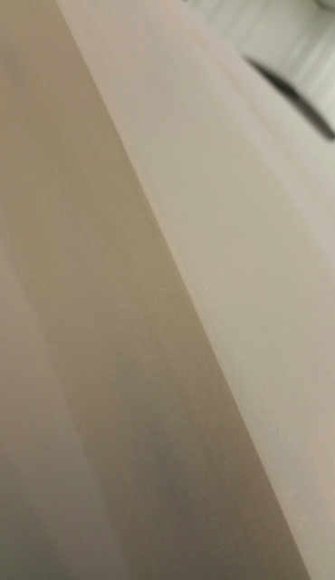

Wow, you could shave your beard on that edge!
I guess loading up the first layer of filler is a lot less of a concern when you've got a sander rig like that to knock it all back down with. I was always leery about putting too much filler on because I was hand sanding and didn't want to lose the basic shape that had already been established. Comparing to my build, I see now that getting the hard shell on over the foam opens up the ability to fill and sand at will, whereas trying to finesse the fragile foam and soft fillers is more of a losing battle. Maybe.
Re: The Astroliner
Postby Atomic77 » Sun Nov 08, 2015 9:48 pm
Yes, that's my thought. Get the glass down, then work that surface to perfection. On the boats we don't use filler, just epoxy. So you could go that route if you wanted, but for a camper, car, motorcycle etc. Filler is perfectly fine. Have you landed on a top coat yet?
The thing about filler... Before I lay any down, I'm going to have my surfaces pretty darn close. I'm not using filler to fix a bunch of ugly. I'm only filling low areas and imperfections. By the time all of the filler is sanded down, the thickness would be measured in mill's not inches. Not much material left as most of it goes on the floor. Like I said, the secret is to get enough on the first time. I've watched plenty of guys over the years put it on and sand it off. Put it on and sand it off. It usually takes me one to two coats and done. I could have easily blocked the first coat with 36 grit by hand. But honestly, hand sanding for me is over rated. Lol.

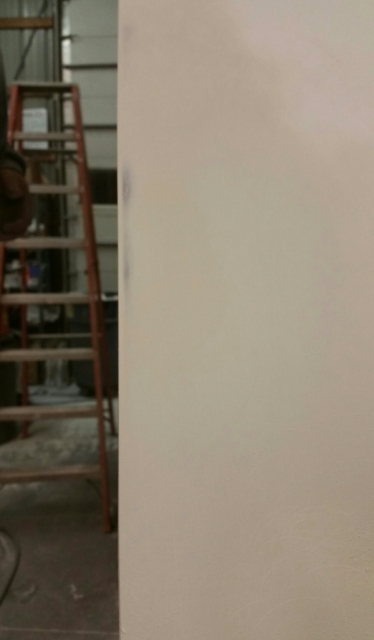

Michael, very nice job on the fill & sand. That edge looks very good & perfectly true. Are you going to break it at all, or leave the hard edge? Just curious about chipping later on with an edge that hard & clean. Really going to be beautiful with the paint in place.

Michael, great work with fairing. As Noseoil, I am also curious about the edge.

Thank you Fellas. To answer your questions, I am leaving the edge. There's a couple reasons for that. First, I like the precise way it looks. I have a lot of practice sharpening edges on the running surfaces of the Hydro and I just like it. Keep in mind, the thickness of the filler is very thin. ( We're talking about mill's here. The most difficult part of the sanding process was being sure not to sand through it to the carbon fiber beneath.) It would take a serious hit to chip it and a hit that hard would chip anything, regardless. So let's hope that doesn't happen. Secondly, after lots of consideration, we've decided not to paint the roof. I could primer it, probably get base coat on it, but being able to spray clear and get it perfect would be next to impossible due to the size. Being 7 1/2' wide and 8 1/2' tall I just couldn't make the reach without swinging from a harness on a crane or something! We strongly considered building scaffolding over it but even then it would have to be moveable and I would need a couple guys slowly moving it forward as I went. Keeping the dirt out of it with that scenario would be impossible as well. I've considered a couple other options but all in all it's just not practical or cost effective to paint the roof. Therefore I'm reserving paint for the sides only. On the roof, we've decided to do a vinyl wrap. Our race team used to do vinyl wrap on the boat, before I was hired to do the paint work. They ran vinyl wrap for 3 years which held up well and looked very nice. It was surprisingly very durable at 200 miles an hour. Also, it held up nicely to rock chips while being hauled by the big rig cross country. The problem with vinyl on a race boat is it hides cracks, which isn't good. Cracks needed to be identified and repaired so the dang think doesn't come apart at high speed! There are really high tech vinyl choices available now, including brushed aluminum and carbon fiber. I think the added texture will lend itself well to the roof area and the sharp edge makes a nice clean break for the vinyl. It's thin enough that you can't see the edge from the side either. We have already laid down a test piece and it really looks fantastic. If I wasn't a painter I would wrap the whole thing and be done!
