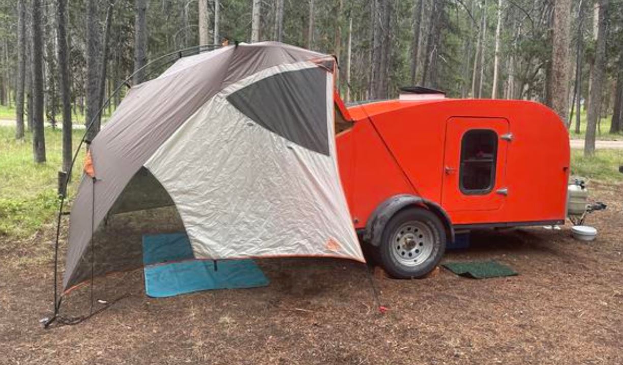

Postby cdnred » Mon Sep 25, 2023 10:43 am
Tony,
Love your TD..!! I saw in another post that you showed a galley tent off the rear. I didn't see any mention of it on what was used. Can you tell me how it was constructed, was it bought ready made or..? It appears to be a ready made sun shelter, if so can you provide a link to where it can be purchased.. Is there an access panel for entering it when setup or do you just enter along the side that fits against the TD wall..? I love the simplicity of it and would love to find something similar to use for those rainy mornings at meal time..

Postby tony.latham » Mon Sep 25, 2023 10:47 am
Kelty called it the Tailgater. Unfortunately, they don't make it anymore. I've tried reaching out to them because they are missing a market. A purpose-built galley tent would be a big hit in the teardrop world.

Postby Tom&Shelly » Mon Sep 25, 2023 8:27 pm
cdnred wrote:Tony,
Thanks
Helmuth
Shelly and I like it too. When we first saw Tony's pictures I thought the pole arrangement looks essentially identical to our Kelty 4 man tent. Just needs a slight rearrangement of the fabric. We even talked about buying some tent fabric and Shelly trying to make one. But since it hasn't happened (yet) I can't comment further, but just throw the idea out there in case anyone want to pursue it.

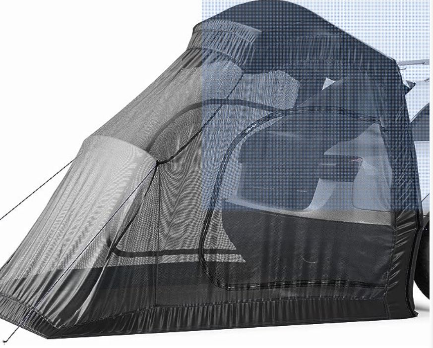

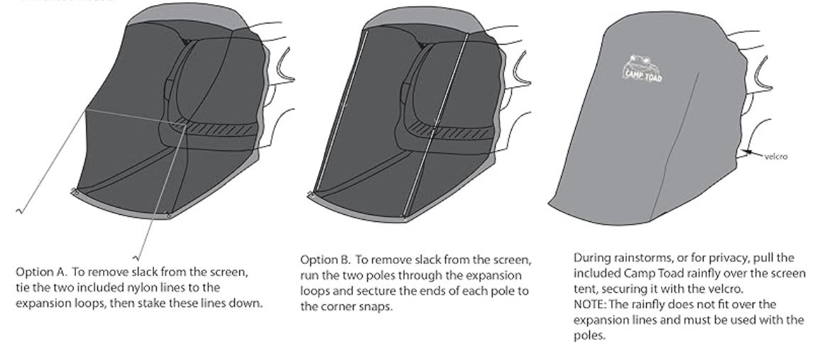

Postby cdnred » Tue Sep 26, 2023 7:48 am
Too bad it's no longer made, ideal for a nice protective rear awning for the hatch area. I did a search and found that there were lots of similar designs sold in England and Europe but shipping and currency conversion would be the killer. I did find a nice awning on Amazon that could be the answer. Converts from a bug shield to a rain fly to keep the rain off while in use. Price is very reasonable also with free shipping included..
https://www.amazon.com/Camp-Toad-compat ... ve&sr=1-14

Postby tony.latham » Tue Sep 26, 2023 10:30 am
I did find a nice awning...
There's a Youtube video or two on that awning. It may work.
