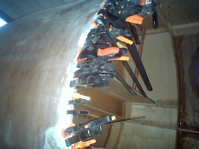

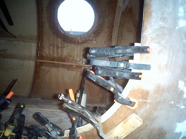

Today a lot less bondo and more work on the door seal. All my clamps are currently busy. First I finished the spacer.
Then started installing the lip, and used all my clamps.
Tomorrow go to store buy more clamps.
