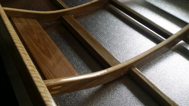

Postby dales133 » Wed Sep 09, 2015 12:44 am
Heres a quick look at the inside hatch skin
dales133
Posts: 4605

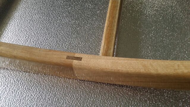

Re: Ok here we go...PMF!
Postby dales133 » Wed Sep 09, 2015 12:10 pm
Thanks mate.
Ive always liked the look of aluminium,stainless ect with timber.
One sets the other off perfectly.
This is 0.5mm so it weighs less than a kilo per m2.
Ive got a 3mm ply skin on the outside of it witch im doing some experimental waterproofing on.
Ive used a thin bandage i use to reinforce joins and corners waterproofing showers at work and glued it around the edge of the ply skin with tb2.
Its already been flush trimmed to size.
Im going to paint the PMF bandage on the inside face where it gets laminated to the ply to protect and seal the ply edge then apply pmf over the outside in a more traditional mannor once they are installed on the ribs.
Its the best method i can come up with given my situation.
