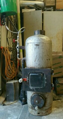

No pictures to show but a busy weekend of sanding and perfecting. Most all of the shell is now ready for primer. I still need to work on the tail light and license plate recess, which means I have to pull up a stool and do some hand crafting. Then I can try out a new polyester primer that I've really been wanting to test. It's made by U-Pol and is said to be amazing over fiberglass. Maybe pictures next weekend of the new primer. In the meantime, here's a picture of the oil burner brother Matt has been designing and fabricating. Almost complete here, getting ready for a test fire to burn off all the old LP tank paint. It should drastically cut down on the fuel bill to heat the shop.

Postby KCStudly » Sun Nov 15, 2015 10:40 pm

Re: The Astroliner
Postby Atomic77 » Sun Nov 15, 2015 11:38 pm
Nope... Just a stove.
Michael

Re: The Astroliner
Postby OP827 » Mon Nov 16, 2015 12:05 am
Great to have a brother who has the shop and then the stove in it :thumbsup: .

Re: The Astroliner
Postby roamer » Mon Nov 16, 2015 10:02 pm
I want to build one myself. A previous coworker made one. It would cook you out of his shop. He made it from an old hot water heater tank.
I have an large supply of free waste oil from an automotive shop. FREE HEAT! If I only had more time!
I actually have used it to power my Cummins. I try to keep it to 25% when I do, waste to diesel. It is an oil burner after all.
