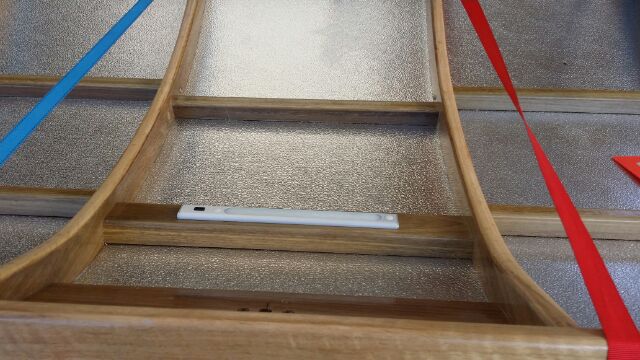

Dale, I made a small jig out of two blocks for locating the holes in the hatch. I measured the depth inside the ribs, with the latch body in place, to get a location in the ribs for the offset from the inside edge to the center-line of the rod. One block has the hole in it with a center-line drawn on it, the other sits on the rib & forms a "T" or cross to keep the depth the same on all holes. I just drew a center line on the ribs where the rod went through each one to locate the holes & the jig (made on my drill press) held the depth & alignment. I didn't use a liner or sleeve on the hatch holes, because they are supported by the latch mechanism & two ribs each. With three points lined up, it's not going to wear out the wood & a bit of wax in the holes will act as a lube for a long time.
Here's a picture showing my measurements from the edge of the blocking to the edge (top & bottom) of the rods. I didn't worry too much about the rods moving up & down as they swing through the stroke on the radius of the plate. I just wobbled the drill slightly (up & down) after the inner hole was drilled to let the rods have a bit more play as they move where they're closest to the latch mechanism. It works very well this way. A smooth rod in a wooden hole with wax won't wear out the hole until after I'm gone. Not my problem!
I was more concerned with the side walls and the mounting point in them (automotive type door bushings per Brian's suggestion) than the hatch itself & the holes in it. My thinking about the alignment, gasket squash & hatch engagement is that with everything in place & working, I'll drill the holes once the hatch has had a chance to settle into place & compress the gaskets a bit. A week or two of sitting with the weight of the hatch should take care of things and it should settle down as much as it's going to over time. I've run some fairly tight tolerances in the loft or curve of the hatch & gasket mating areas, but it's pretty sloppy (about a full cm on each side) in the side-to-side department. My total compression for the gaskets will be about 0.10" or 0.25mm, give or take a few hundredths.

Nice idea with the jig mate,i was thinking along those lines myself.
I was going to ping a chalk line and then set the jig to it.
My latch is a bit different to yours but not totaly sisimilar but the latch rods push out completly parralel.
Ive had alot of years experience with building maintenance and lock adjustments and what im thi king of doing witch you may want to consider for better seal compression is grinding the end of the rod into a long steep cone with a flat tip so when you push the hatch closed it shuts so the tip of the cone locates the bush or striker plate right on the end of the taper so that when you turn the handle it mechanicaly forces around 3 to 5mm extra compression on the seal.

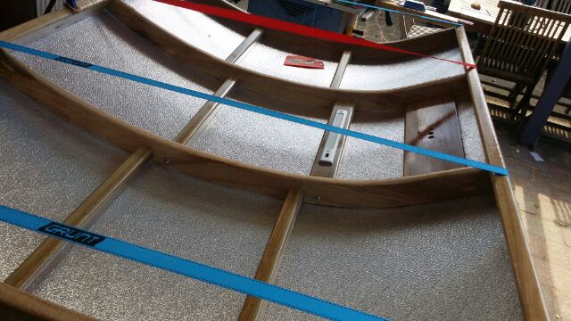

Postby dales133 » Sat Sep 12, 2015 3:09 am
Got hardly anything achieved today except drive around everywhere trying to find suitable bushes for the lock,
No joy!
Looked in a bit more detail for a paint colour but cant quite find what i want.

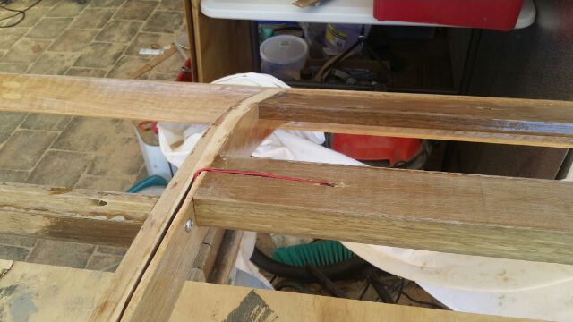

The only thing of any real purpose i achieved was disasembling the lock so i can fit it through the ribs as it wont in one piece and it had great big solid rivets holding the arms on and now ive got to locate them and find a way to press them.

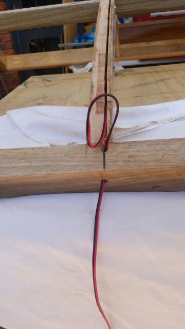

I also cut a dado in the back of one of the center ribs to run the light cable through as i have nowhere else to hide them as i have no inner skin.
Came up pretty good considering i had to freehand it down a giant curve an inch wide.
So i have a wireless clean finish and i sanded the back of the ribs so its free off varnish runs ect for hopefuly a nice snug fit to the stucco sheet.

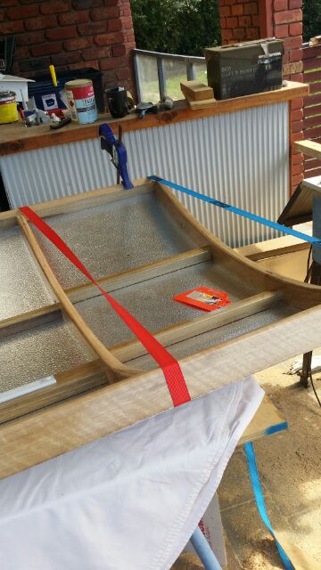

Postby dales133 » Sat Sep 12, 2015 11:42 pm
Theres the crude but efective slot to run my light wiring

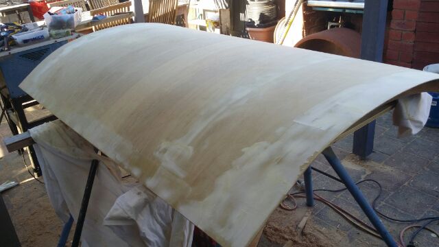

Just got the outer skin on the hatch....first hot day of spring...no fun with the fast cure sikaflex
dales133
Posts: 4605
Re: Ok here we go...PMF!

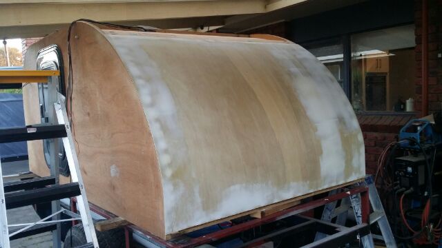

Postby dales133 » Sun Sep 13, 2015 1:19 am
Outside skin on and a bit of spac action.
dales133
Posts: 4605

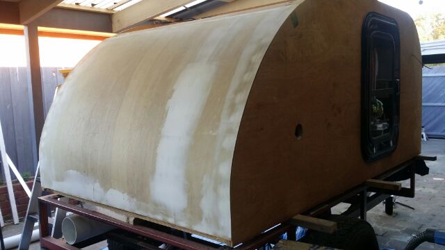

Postby dales133 » Sun Sep 13, 2015 3:10 am
Busy day in teardropland!
Got it on and flush trimmed up.
3rd coat of spac filler on.
Happy with my progress today,got off my arse early and put in a whole day
