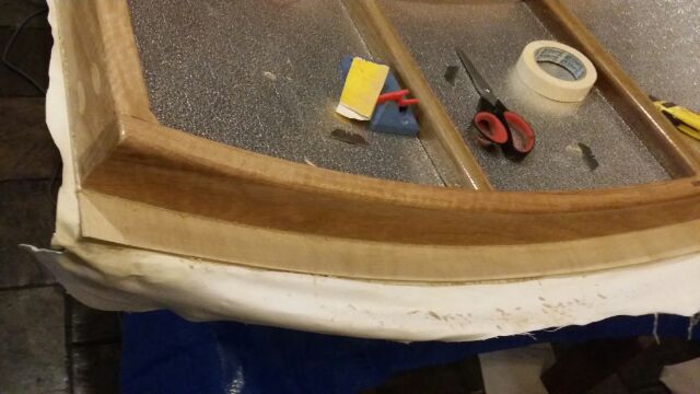

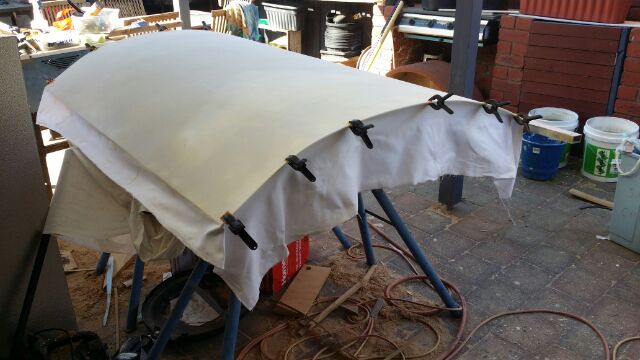

Well i finished early and before i left this morning i wet down some canvas to preshrink it and got home and glued it to the hatch.
Looks pretty good but the winds just picked up big time so i had to clamp it on round the edges so i didnt peel off!
dales133
Posts: 4605
Re: Ok here we go...PMF!
Postby dales133 » Mon Sep 14, 2015 5:24 am

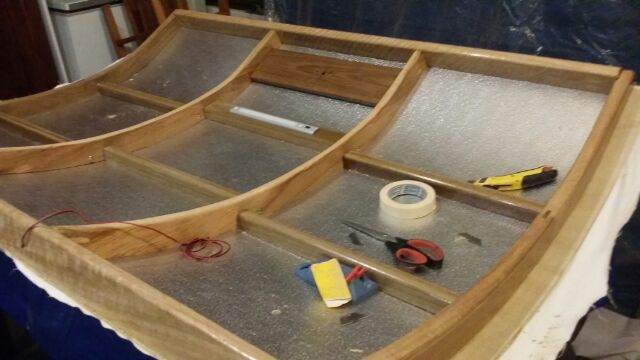

What a chore!
Inbetween cooking dinner i set about trimming up some of the excess canvas that wraps under the hatch but in order to stick the canvas on i had to remove all the excess polyurathane adhesive that was impossible to mask off due to the nature of the beast.
This was done by pain stakingly scraping with a stanly knife blade and i went through about 4 on the 2 sides.
Then i gave it all a good sand..
Its 8.20pm and i may carry on tonight but ive just finaly sat down and its feeling good :)

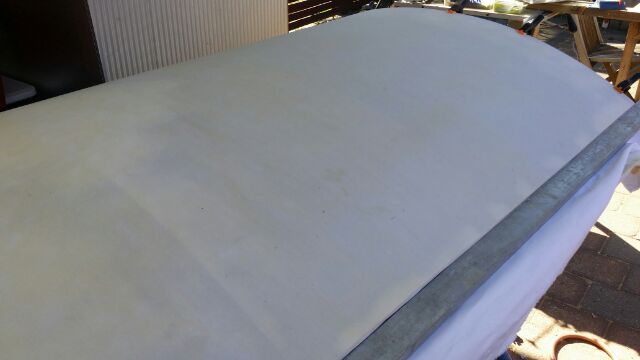

Postby noseoil » Mon Sep 14, 2015 7:16 am
Looks really nice & smooth. Should be a good finish when it's all done, nice job on the hatch!

Postby dales133 » Mon Sep 14, 2015 1:09 pm
Thanks bud it realy did come up well considering it was my first go with thick canvas
One thing i did find that might be of help to someone else...i had a couple of small bubbles i noticed when it was half dry and i painted some of the watered down tb2 onto the offending spots then massaged it through the canvas with my fingers.
I put a decent amount on...worked perfectly.
Definatly alot harder than bedsheets i used on the roof though
