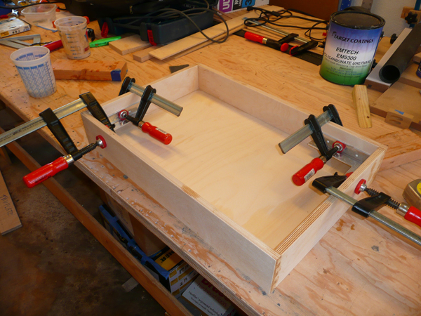

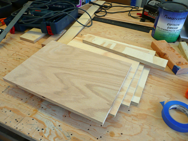

Postby aggie79 » Tue Jul 19, 2011 8:18 am
Good morning,
Either I'm getting older or the heat is more intense this year than I can remember for the past several years. I'm not the machine like Earl (Loader) but I have been making slow progress on my cabinets.
I assembled the two drawers for the galley cabinets. I have one long drawer that will hold my camp stove and one short drawer for silverware and utensils.
I also finished the sub-assembly for the center of the interior overhead cabinet. It has space on the bottom for the DVD player, space for a car radio & CD/MP3 player in the middle, and a cubby for remote controls in the top.
I didn't get any pictures but the cabinet doors and drawer fronts are fabricated. There are only two cabinet items left to fabricate - the shelf of the headboard cabinets and a pull-out, tilting drawer for our 19" LCD TV. Then I can start applying the finishes for the cabinets and install all of the cabinet sub-assemblies.

Postby DMcCam » Tue Jul 19, 2011 12:57 pm
Your cabinetry is looking great Tom!! I can't tell from the pictures what thickness ply you're using; sure looks strong and square. While you are getting slammed with terrible temperatures, we've been enjoying very mild daily highs. Very unusual for July here.

Postby Loader » Tue Jul 19, 2011 1:01 pm
Tom,
Those drawers are looking great! Which brand jig do you use with your router?
Machine, I'm no machine, just not smart enough to come in from the heat!

Postby aggie79 » Tue Jul 19, 2011 1:35 pm
DMcCam wrote:Your cabinetry is looking great Tom!! I can't tell from the pictures what thickness ply you're using; sure looks strong and square. While you are getting slammed with terrible temperatures, we've been enjoying very mild daily highs. Very unusual for July here.
Take Care good sir,
Dave
Hi Dave,
I'm using cutoffs and scraps for my interior cabinetry components. My cases are 1/2" ply. The center unit is made from 1/2" ply, 3/4" ply and 3/4" oak ply.

Postby aggie79 » Tue Jul 19, 2011 1:48 pm
Loader wrote:Tom,
Earl,
The jig I used was the mouse that is connected to my computer. :lol:
I was going to buy a jig - still may in the future - but due to the expense of the jig and the lack of time I purchased the drawer box parts online. I believe it was around $20 per each drawer which includes the half-blind dovetail sides and the drawer bottoms.
Take care,
