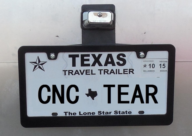

:P Victory! Total, complete, unconditional, unequivocal victory! It was a tough fight, but I won. :P
Yesterday, after I got off the phone with Mom, I hotfooted it up to the tax assessor's office, arrived at 4:28 pm according to the car clock, wandered through the halls of government for a couple of minutes, arrived at the office, punched my info into the "Please Take a Number" computer, and it told me that vehicle registrations aren't available after 4:30. :x Of course, the office is open until 5:00, but no matter. You can't win an argument with a govt computer and stay out of jail, so I turned around and went home.
Today, I didn't dork around until the last minute. Got there after lunch hour, and got 'er done.
What a melodrama. Sheesh. I'm glad that's over. :phew:

Postby noseoil » Fri Nov 14, 2014 6:39 pm
What a colossal nightmare & major PITA! Now I know why people use Maine as a place to register their trailers, just lick the stamp & mail a check.
Here in Az it's a lot easier. Basically show up with a receipt for the axle, frame, whatever & pay for the registration & license. To transfer mine into my own name (used, private sale) it was $16 for the title & a lifetime plate.
Trust government to make a simple thing complex, time consuming & expensive.
Glad it worked out in the end for you Brad, job well done. Nil illegitimi carborundum (the only latin I know)!

Postby aggie79 » Fri Nov 14, 2014 7:53 pm
Brad,
That is awesome! You have given me hope on registering the SB. Now back to the build.
