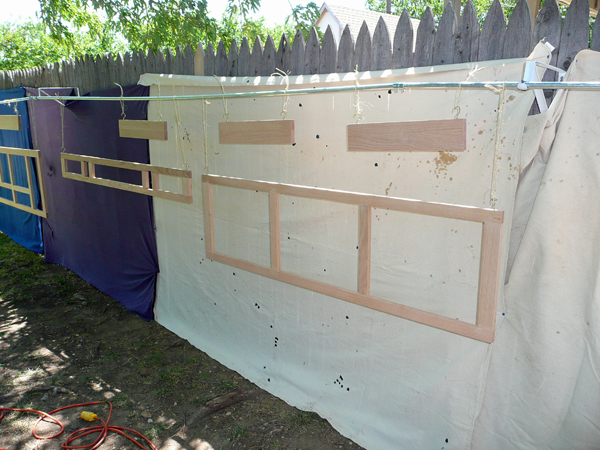

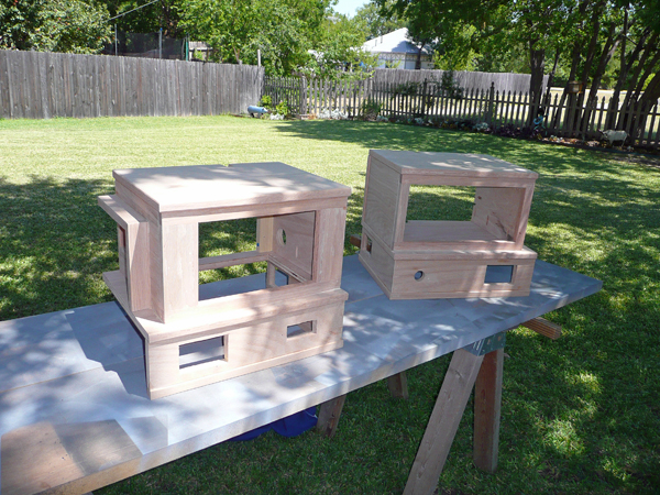

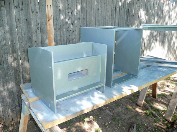

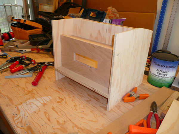

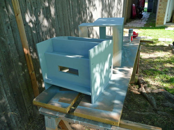

Despite the record heat, I've been pressing on to get my teardrop cabinetry finished.
All of my cabinet face frames, doors, drawer fronts, and most of the cases and interior cabinet components are built. The parts that I haven't built need to be fitted after the cabinets are installed, so...time for my least favorite part of woodworking - finishing.
The interior of the cabinets and the galley floor are getting a painted finish. I applied two coats of high-build auto primer, then sanded, and applied three coats of hammered steel finish from the rattle can.
Here are some before, during, and after photos:

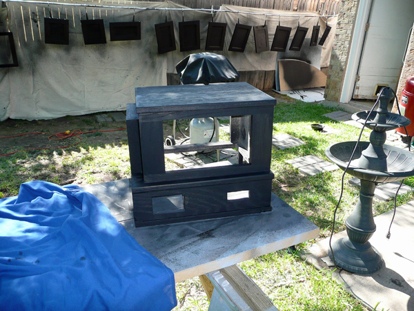

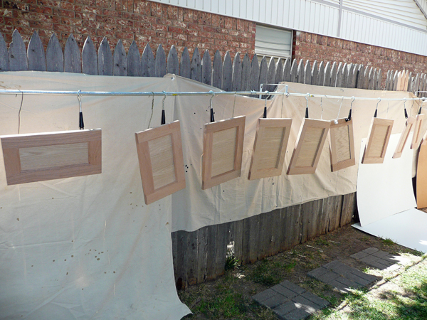

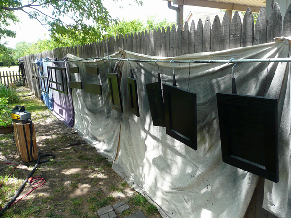

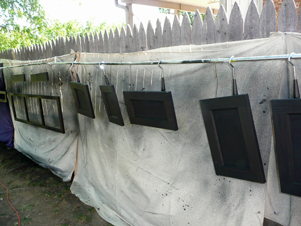

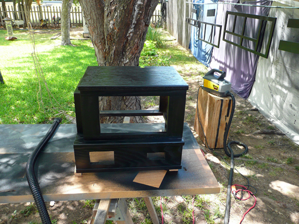

The face frames, drawer fronts, and cabinet doors are getting an ebonized finish. First, I "stained" the cabinet parts with two coats of black india ink. In the pictures, they look completely black, but they do have a slight brown tint from the red oak and the grain shows through.
Here's a few photos before staining and after:
I will add enough poly to fill the grain. Here are the cabinet parts after two coats of polyurethane:
After the poly cures for a couple of days, I'll sand everything and apply 2-4 more coats. The poly I'm using is gloss. To get get the satin finish that I want, I'll go over the cabinet parts with 0000 synthetic steel wool and paste wax. Then I can begin cabinet installation.

Looks like you got some overspray on your fence :lol:

planovet wrote:Looks like you got some overspray on your fence :lol:
That's the neighbors fence!! :lol:
