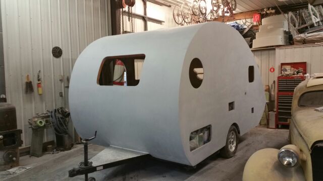

Another milestone weekend for the Astroliner! I finally feel like I'm in the home stretch for paint. A hard 16 hours, some 120 grit on an air board, copious guide coat and those final minute highs and lows were massaged right out. The Polyester primer leveled nicely, although I thought I could air board it with 220 but no luck. It sands well but kicks hard like a shell, so it took 120 to get it flat and sweet. The Urethane primer laid out like glass over the top. The extra step of the Polyester was well worth the time it took to perfect it. It ain't for everyone but I guess that's how we roll...
It feels good to be in final primer after what seems like a thousand little steps. But the best part is, no holes and no trim so hopefully that equates to no leaks. It really is like a tough protective shell. Paint is just around the bend... I can almost smell that 60's flake now!
It's been a long journey down the road of fiberglass finishing and caravan customization so I thought I would post a few pictures of the seams being transformed...

Michael, looking really nice now. Also looks like there's a bit of over-spray around the shop and coating a "few" things in the area. Can't wait to see the paint job.
One question though, with the shape you have, aren't you concerned about lift at higher speeds? It looks like the sectional view would be an air foil & it might start floating at over 150 mph. Watch out if you go to Bonneville!

Actually no, that's not overspray. It's dust. I make loads of it. I usually blow everything down before I leave but I had to hold the heat in for primer. I don't worry about dust on the floor for primer. It all gets water sanded anyway. As far as the shape... The official word from our Aeronautics Engineer on the race team is "no worries!"

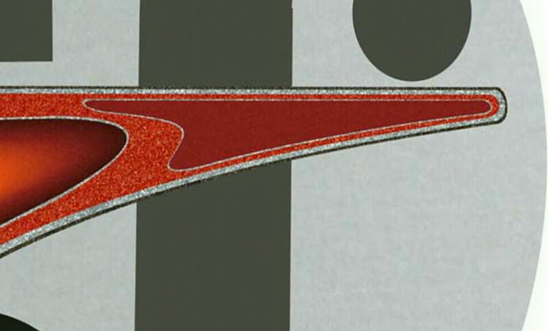

On the paint... All I can say right now KC, is this is a fluid situation! We are constantly brainstorming and playing with ideas. My vision for the Astroliner has always been something "Atomic" or "Space Age." Therefore in the theme of things space ship related I know I want the base coat to be Silver metallic. Then of course I have to have boomerangs somewhere.
The attached picture is a teaser from the rendering that Carrie is working on currently. As always, subject to change of course!

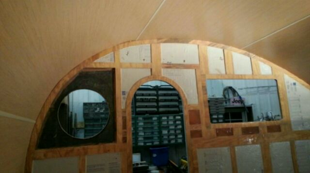

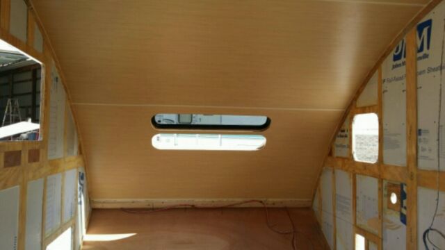

Where are you with the interior work?

Thank you OP. Interesting that you ask because that was the topic of discussion last night for about an hour as we talked about what direction we are going in next. We haven't decided 100% where we will be painting yet and the time frame for paint is up in the air. So until we figure out details, we are going to start working on finishing the interior walls. The wiring is in the walls and ceiling so we can button that up. Right now the interior is pretty bare.
